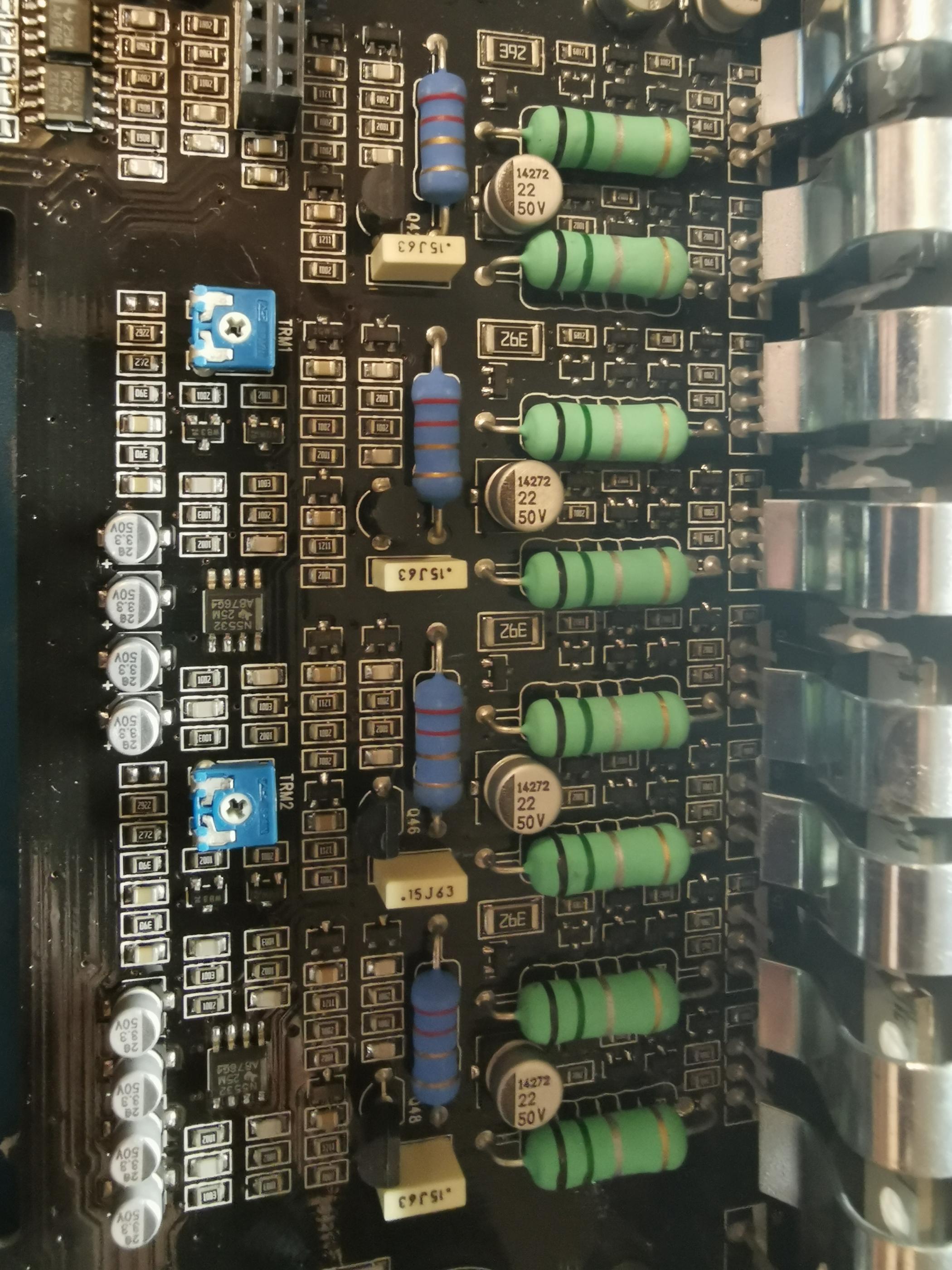

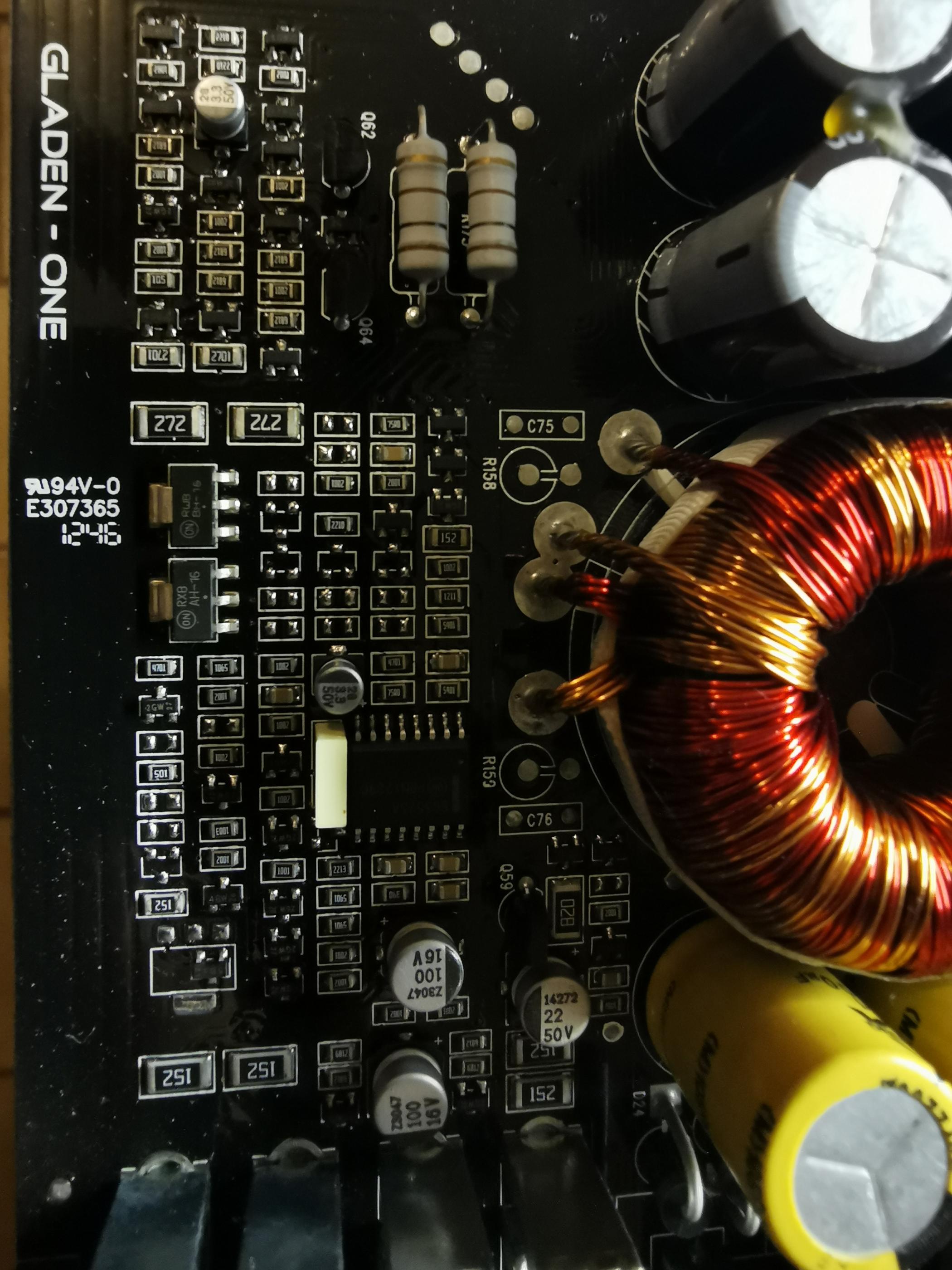

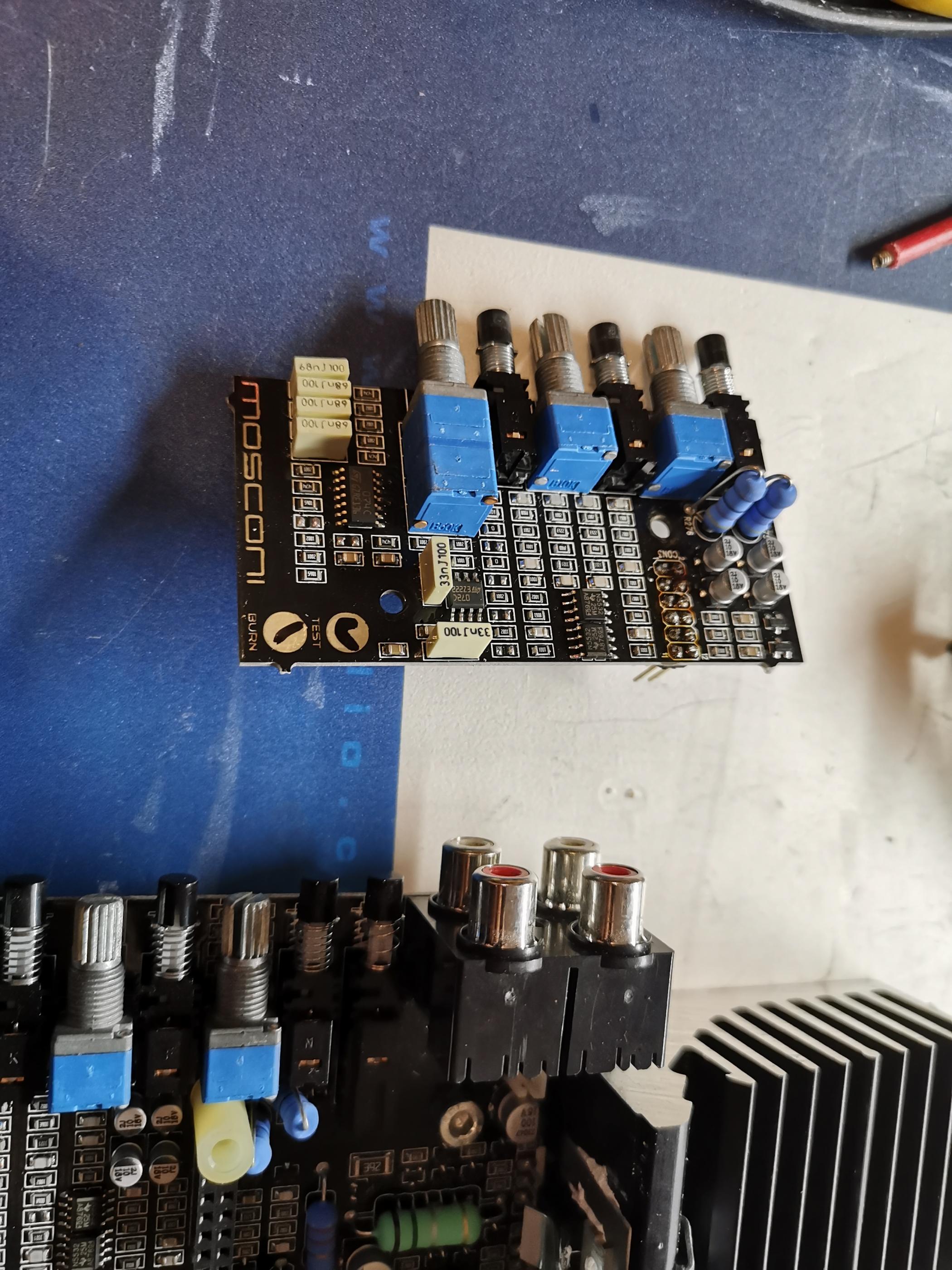

Got this amp for repair. Everything looks fine, but the amp goes after a few seconds in protect. Audio sounds good, during play, no issues.
After about three or for times of testing, it stucks in protect. Maybe a cap???
I have no diagrams for this amp.
Here are some pictures

I checked something and i expect the DC offset protection.
How the SG3525 works? Specially Pin 10, is this pin pulled high from external? If it is like this, i have the same voltage on the transistors in front of the Speaker terminal.
Hmm, i lifted Pin 10. Anyway stays in Protect, but PS is still on. Found the transistor 2GW,
where the emmiter is connected to that pin. This one is pulling high. Base has 5V in that state. Between emitter and base is a 10k resistor...
I lifted the transistor circled right below, the amp stays on. The Resistors left, get hot. The lower one has voltage across 8,3V, the upper 8,6V.
On my ampere meter, the amp draws 0,6amps, then goes up to 1Amp, after half a minute down to 0,6 again.
I expected 1 amp, because when the amp was working, it draws at starting 0,6amp, then when 5 seconds are gone, 1amp and start play music.
That means, current sensing, and i have different currents on positive and negative. Because the resitors are ok, both have 98.6 Ohms.
Checked all emitter resistors , 0V at all.. Could it be possible, that a rail cap is damaged?
