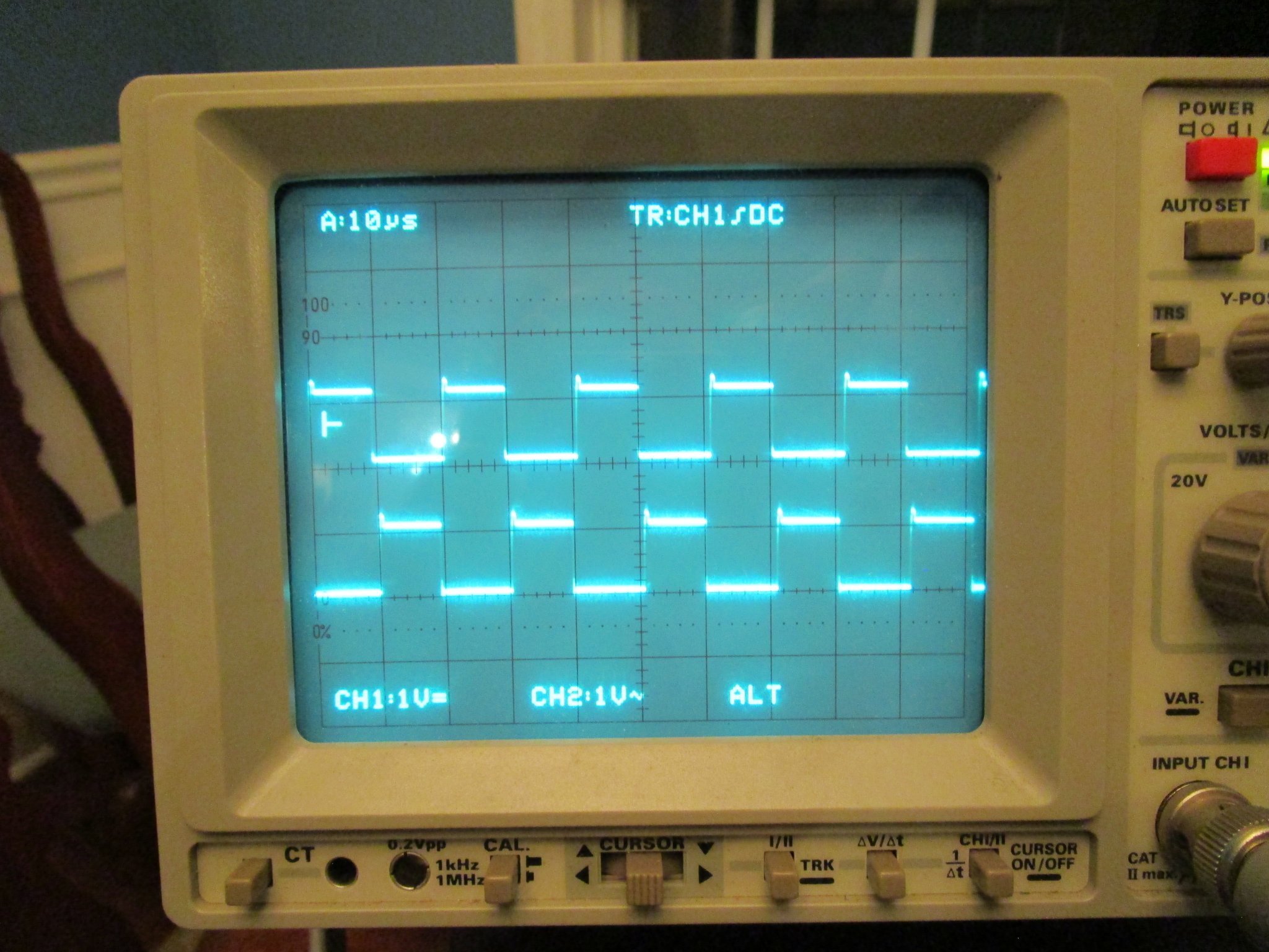

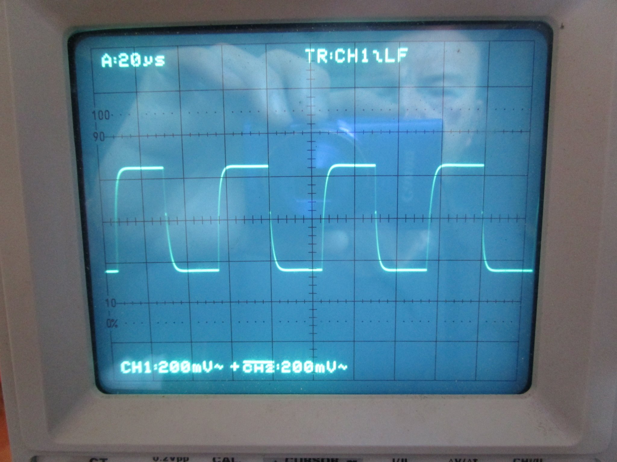

I have not located another amp with an SG3525 yet, so I tested one with a TL494 PWM chip. It was clean and remained clean throughout my testing.
Still working on figuring out differential mode testing. And I need to open up more amps to see if I have another with the SG3525.

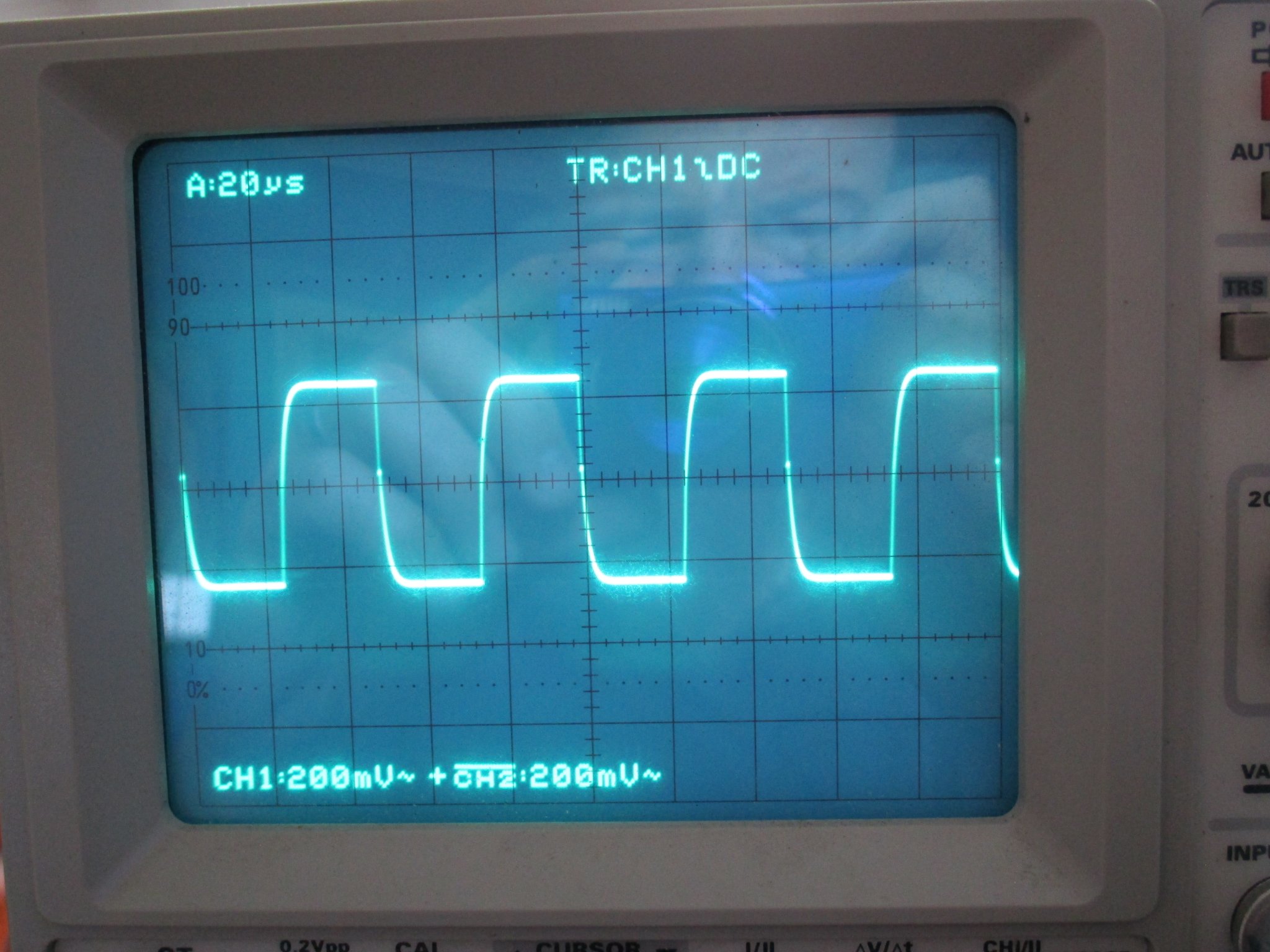

Differential mode is below. Another option may be to use pin 4 or pin 7 to drive the external trigger input of your scope. You'll have to select the external trigger as the source.
A differential input uses two inputs to produce a single waveform. The simplest way to get a differential input is to use a differential probe. A differential probe has two signal leads and a mixer amplifier built into it. It feeds the scope a normal signal (a composite of the two signals input into the differential probe). The problem with differential probes is that they're expensive.
The alternative is to use two scope probes and and both inputs of your oscilloscope. This is how you have to set up your scope:
Two probes
Both scope inputs used
Input set to add
Both channels set to DC coupling
Both channels set to 'cal'.
Both vertical amps set to the same voltage
Ch2 input set to invert
Bandwidth limited (works best for most measurements in car amps)
Trace aligned to the reference line on the scope's display
Ground leads for both probes connected together (not always necessary)
After setting up the scope, you need to confirm that it's working as it should. With the vertical amp set to 5v/div, touching the probe that's connected to Ch1 to the positive terminal of your 12v power supply should make the trace deflect about 2.5 divisions up from the reference (like it always does, seen below). Doing the same with the probe connected to Ch2 should make the trace deflect down about 2.5 divisions. Touching both probes to the positive terminal of the 12v power supply should cause no deflection. If it does, something isn't right.

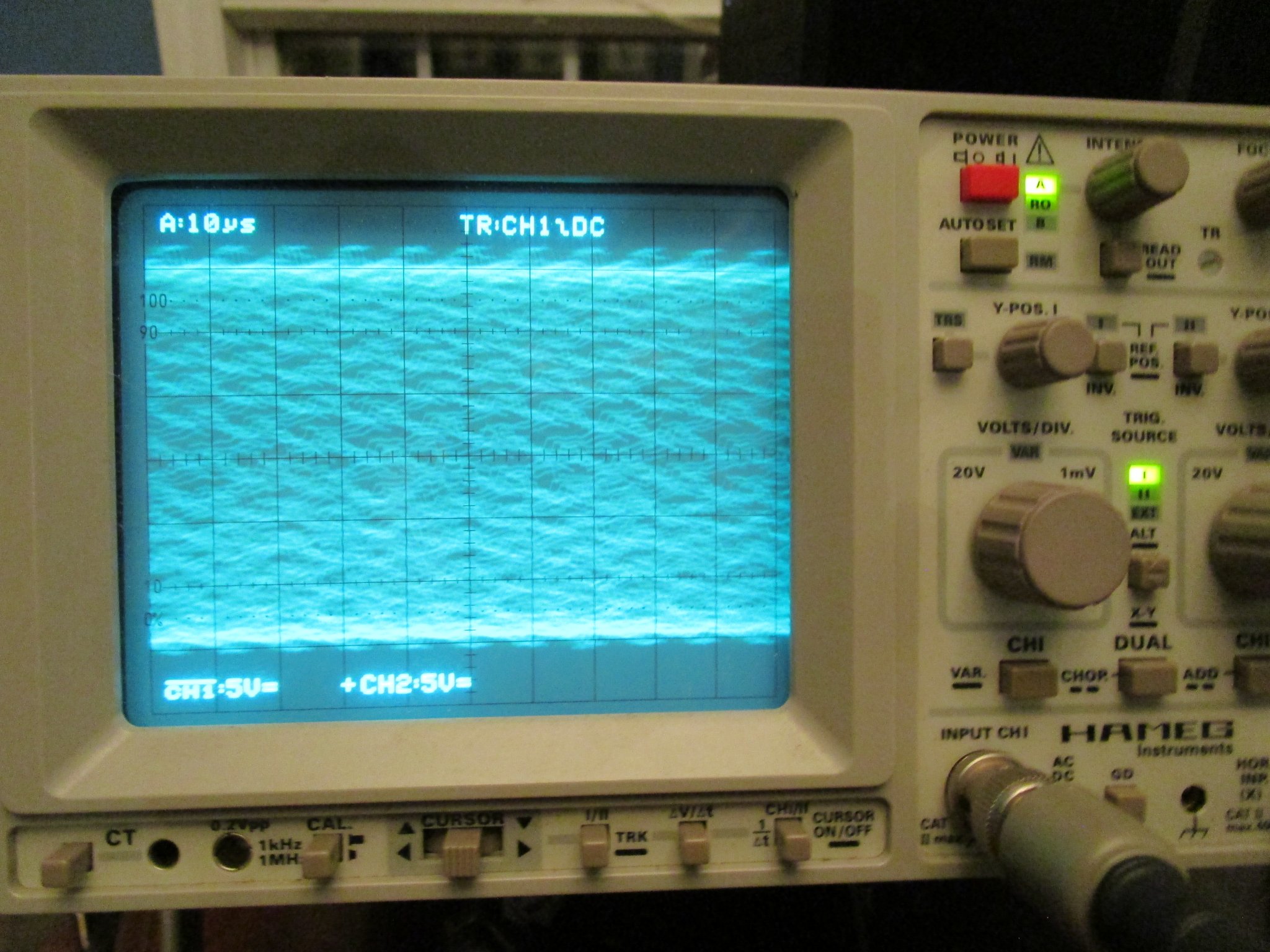

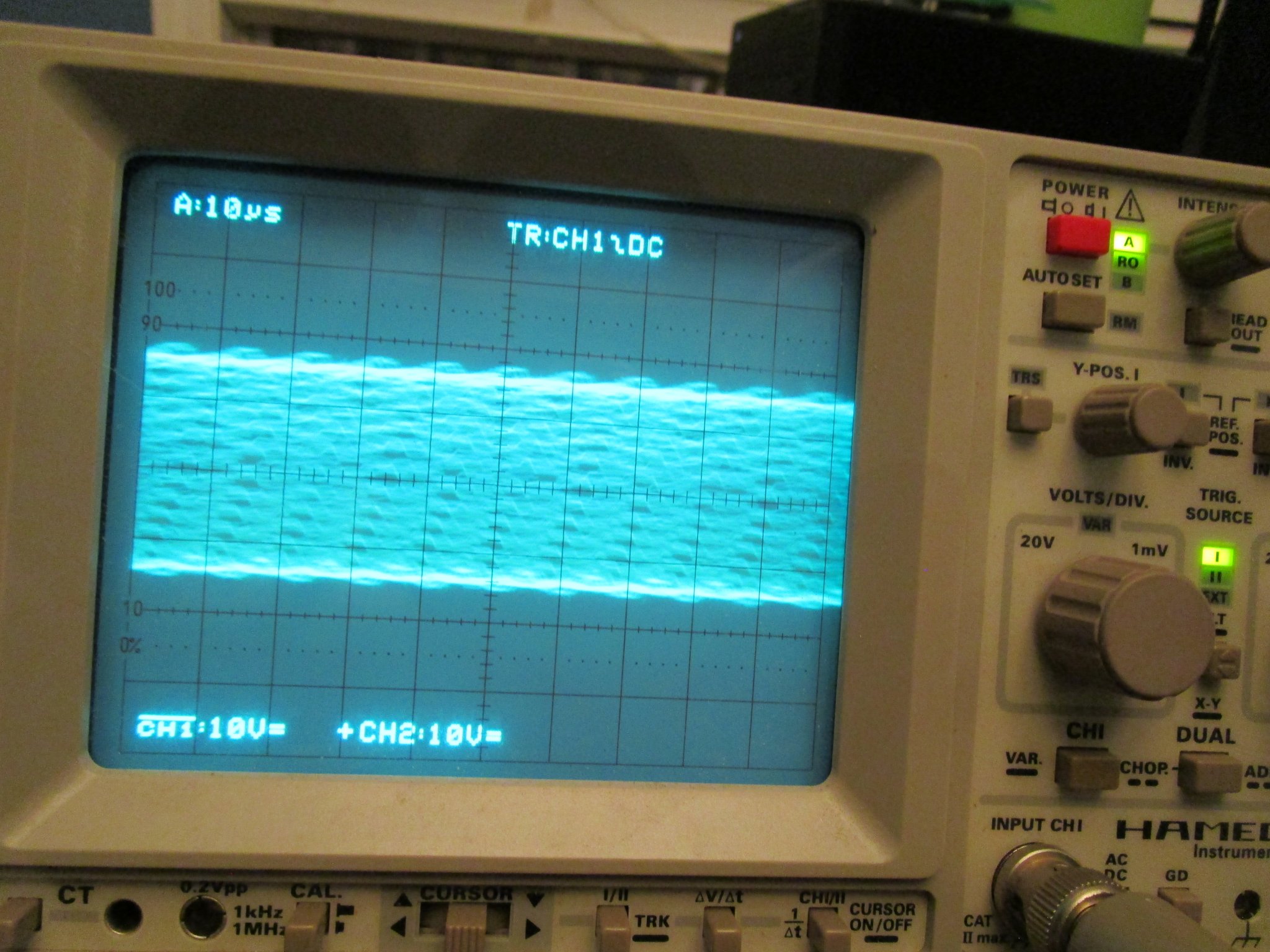

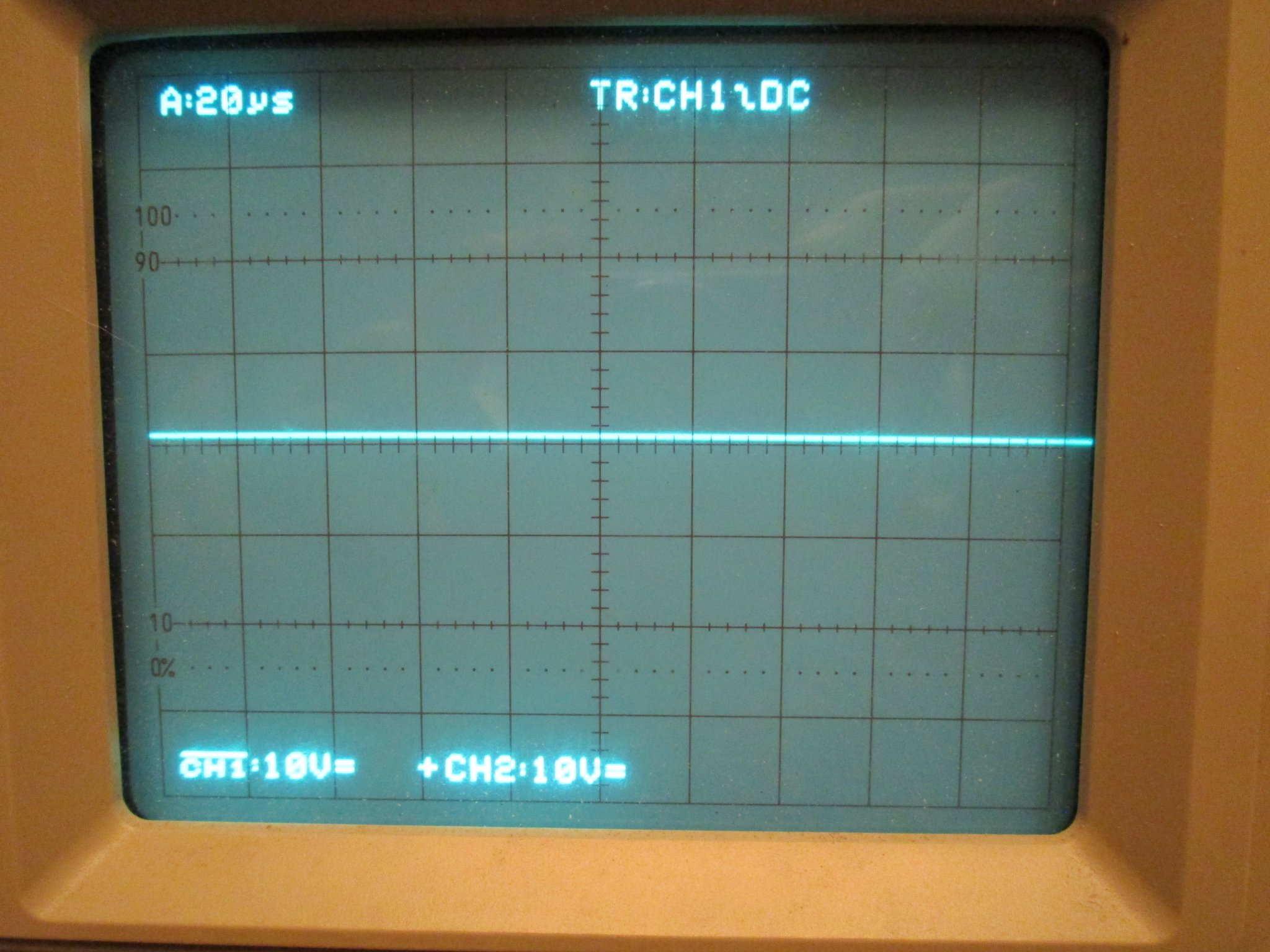

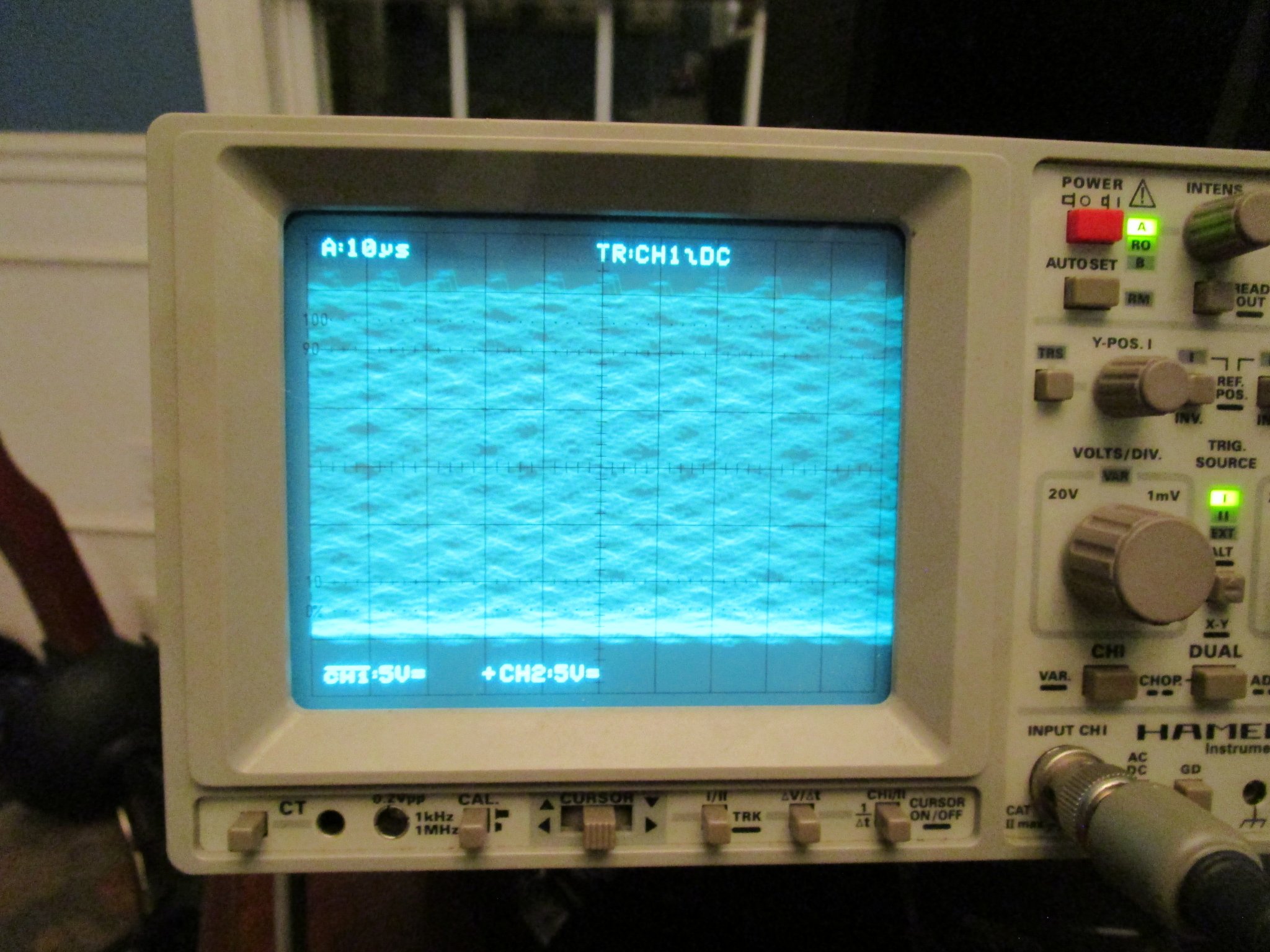

I believe I have the scope setup for differential measurements based on your response and the user manual. But I am not getting the expected results, when I place one probe on ground and one on 12V+ all I get is noise. I tried cycling trigger modes, volts/div and timebase with no luck. Probing the SG3525 output results in similar or the same noise.
Scope setup for differential, with channel 1 inverted based on my translated manual it says channel II invert is disabled in addition mode.
CH1 on 12V+ CH2 on ground. Same result if I swap probe positions and if I completely swap probe channels.
Same measurement points lower volts/div.
CH1 on output pin of SG3525 CH2 on main ground.
I tried it with and without the ground jumper between the probes, it looks the same.
The closest I got was trying some old Tektronix probes (mismatched). I did get close to a DC level when probing the 12V+ and ground, but the waveform was a bit wavy (not a straight line). Based on the fluke probes kinda working I am thinking maybe I should order two new probes.

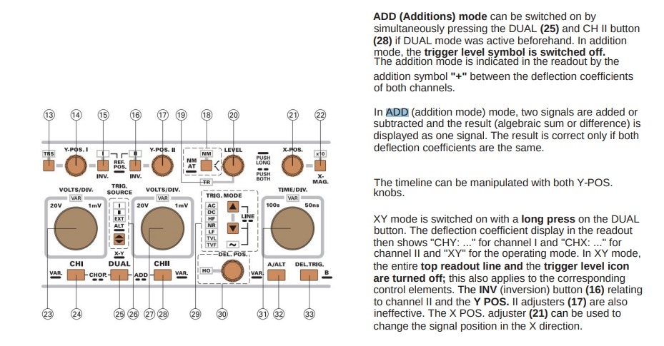

Here is the translated manual page I found the add settings on.

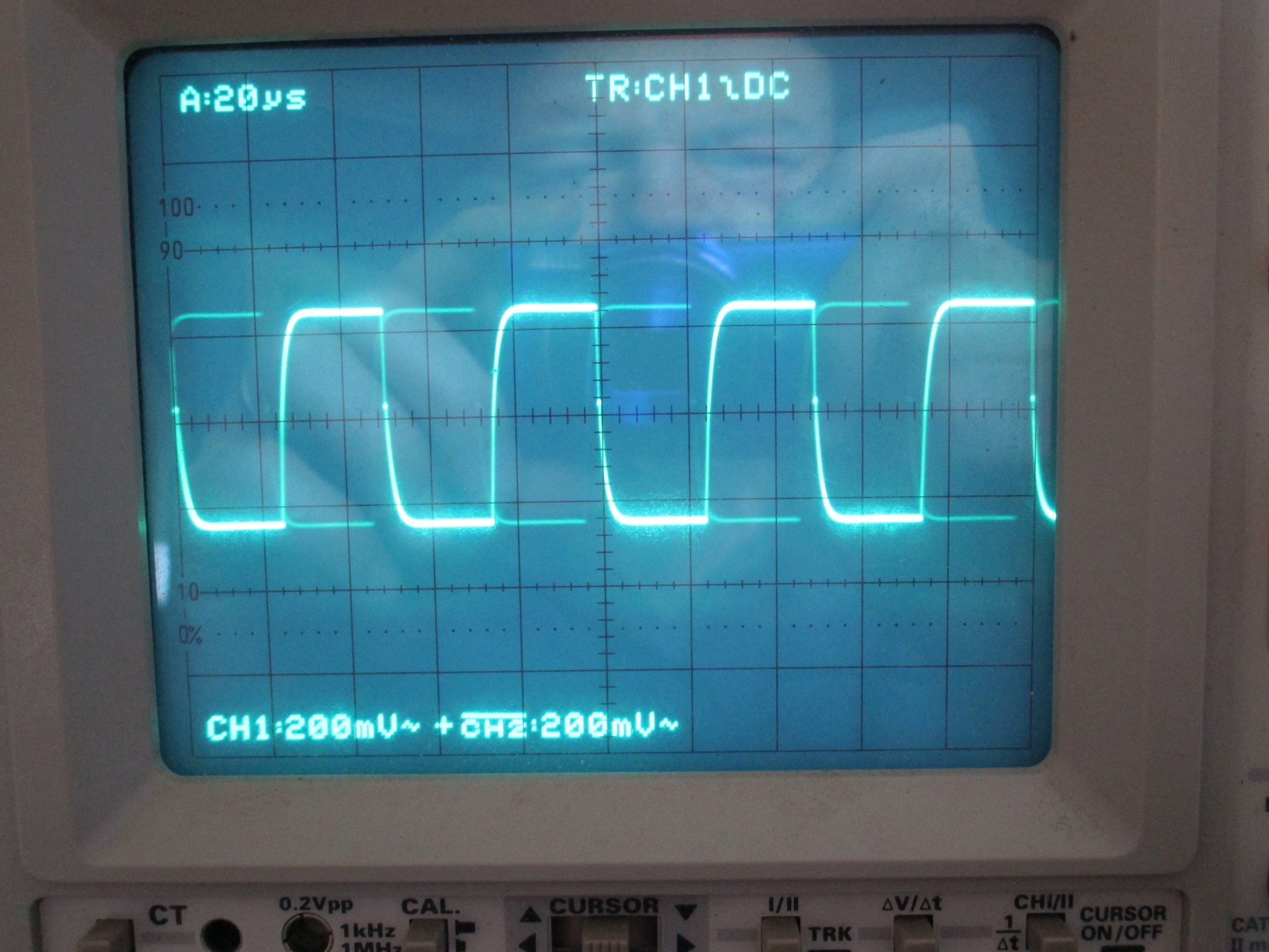

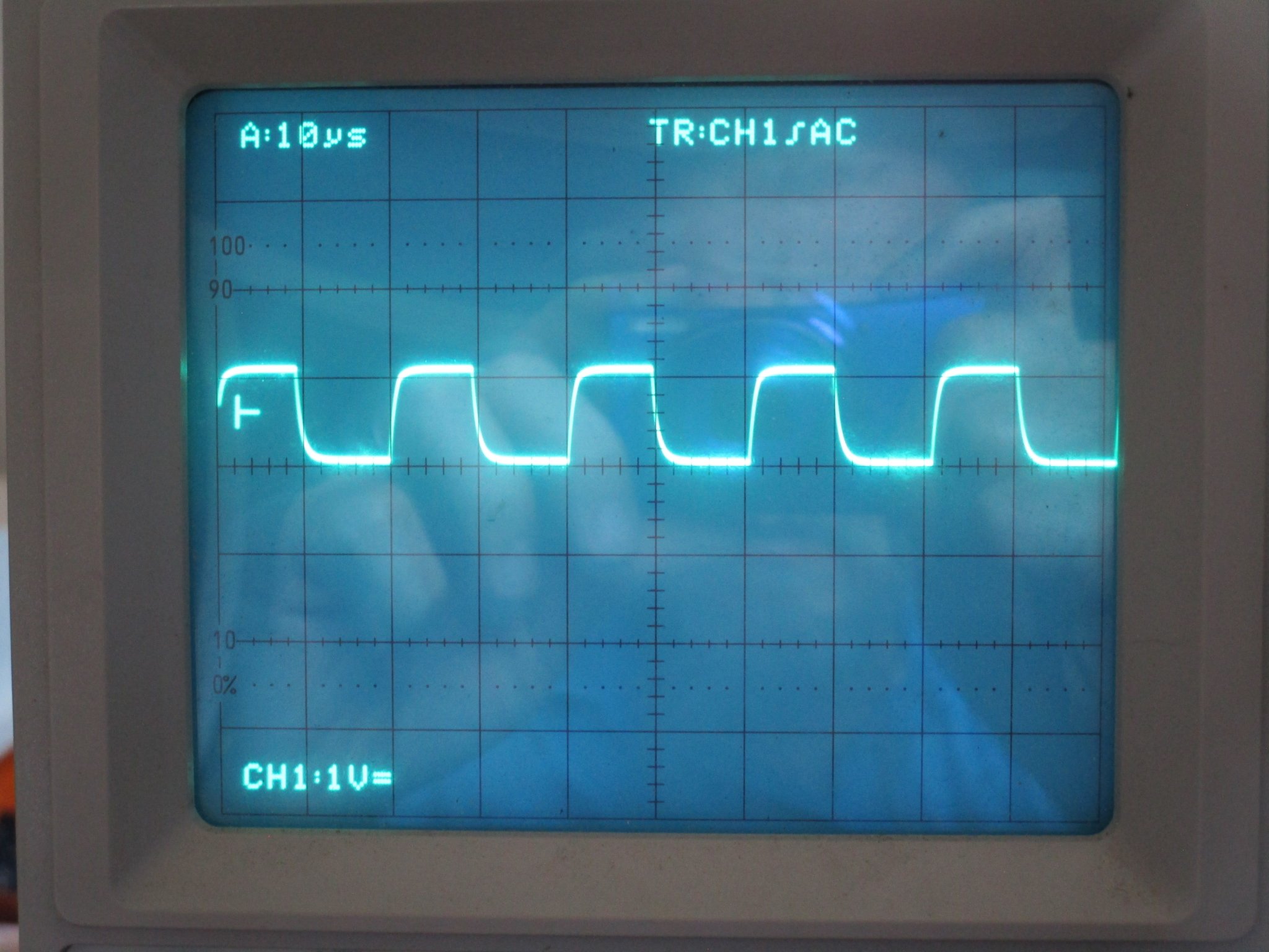

The grounds were not connected to the 12V ground, I thought that would be correct for a differential measurement. Where channel 1 probe tip would measure the pin on the SG3525A and channel 2 probe tip would be connected to 12V ground. I did try it with the probe grounds connected together, it did not make a difference.
With the probes un-grounded the waveform displayed is noise, no resemblance to a square wave.
I just tried again with channel 1 (inverted, AC coupling) probe tip would measure the pin on the 12V ground and channel 2 (not inverted, AC coupling) probe tip connected to SG3525A. The result was the same noise, until I connected the ground (at which point I could remove probe 1 from the 12V ground with no change to the displayed wave form). But I feel like this is not a differential measurement.
Differential or not, the waveform behaved exactly the same, it starts out clean and then the a second out phase square wave appears. Cooling the chip makes it go away until it heats back up.
