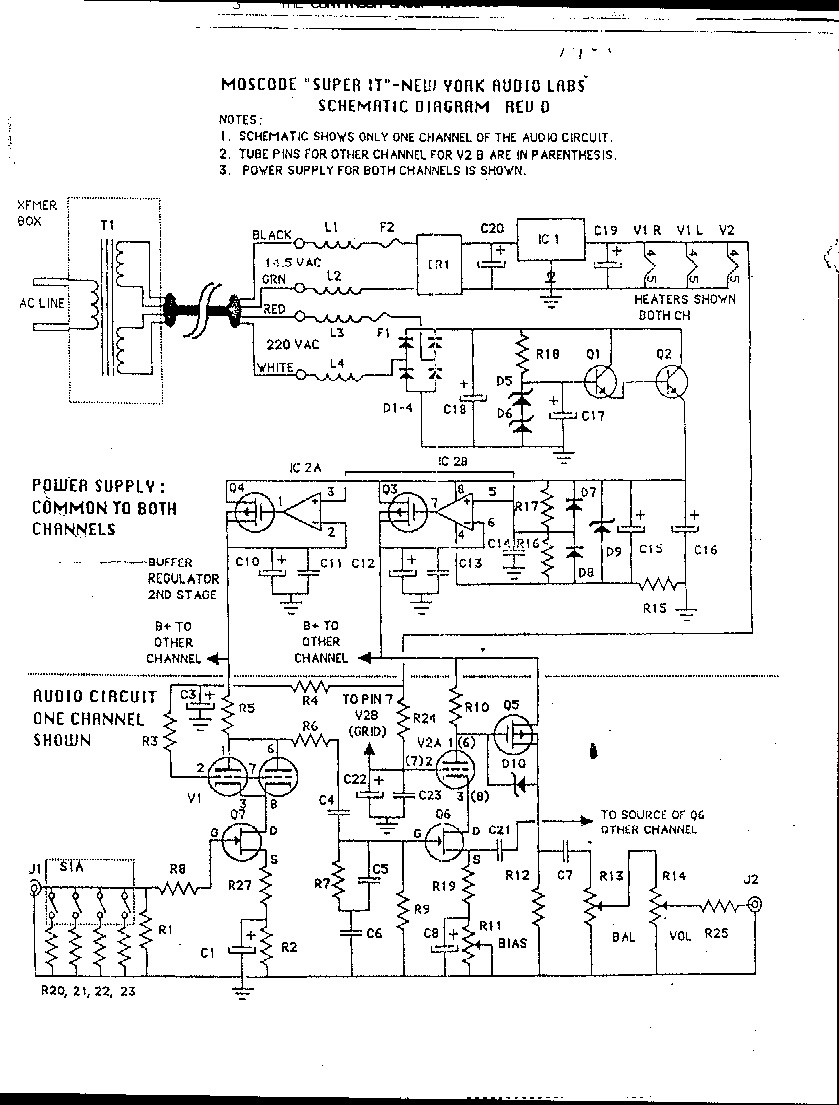

There have been posts and threads for years with people asking for a schematic for the NYAL Moscode Super It, and it seems like NOBODY has this. George Kaye and Moscode seem to no longer exist, or so it seems. So, does anyone out there have it? It seems amazing that it can't be found anywhere on the internet. Mine keeps blowing one of the big power supply electrolytics, and I know others have had this problem as well. A schematic sure would be nice... Anyone? Thanks, JV

I know I have it somewhere and I know I found it on the interweb. I'll try searching again.

Thanks for the circut diagram, however still no value for F1. I measured the draw and it seems about .08A, so I am thinking a .5A fuse might be OK. In the meantime I found the HV filter cap was bad.

I've been working on my Super It in the last month. I use the voltage drop across the plate resistor (R5) to properly set the source resistance of the input FET. The proper bias point gives you 1mA through R5 and a voltage drop of 100v since R5 = 100K.

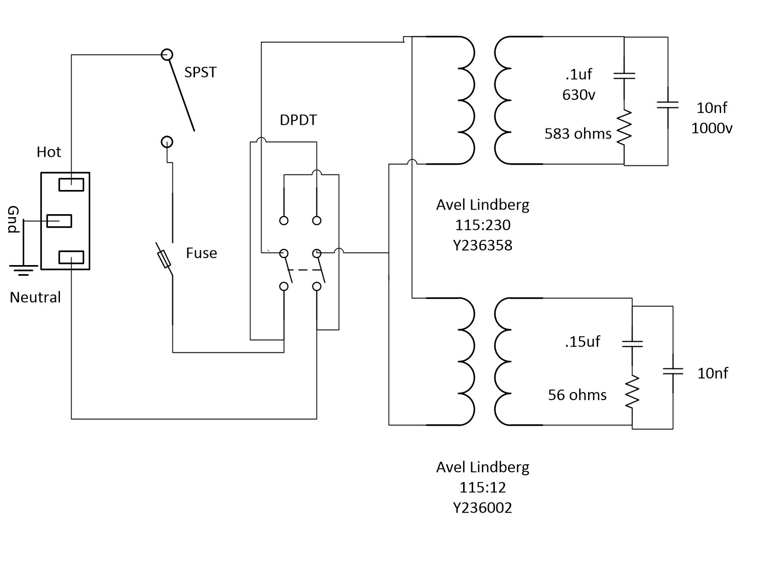

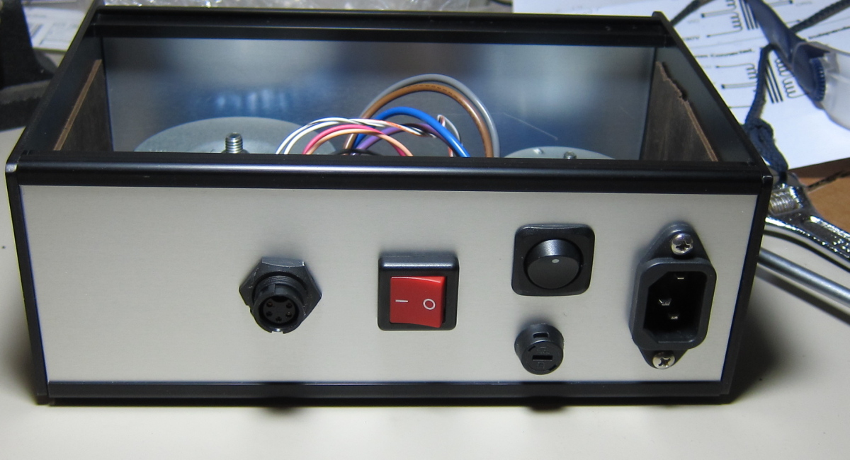

I recently built an external power supply for my unit, since the external transformer seems to have blown an internal fuse. Here's a schematic showing what I built.

neat PS box !

Thanks. It's an 8" x 5" x 3" box (20.3cm x 12.7cm x 7.6cm) from MC Series Metal Cabinets - Wolgram Engineered Plastics, LLCneat PS box !
The current is actually independent of the 12AX7. It's determined by the input FET, which is never changed and is quite stable. So one just sets it once and it's good for the life of the unit.as for the R2 value , it looks as the 5K pot that is placed onto my board isn't a bad idea at all ? making things a lot easier to adjust the input stage bias . otherwise one would realy need a very close balanced and matching pair of input tubes 12AX7 , not an easy task to find .

I suppose than that NYAL didn't pay a lot attention to fet matching .. there's a significant difference between the voltage across R2 . 1,1 Volt vs 2,2 Volt.
