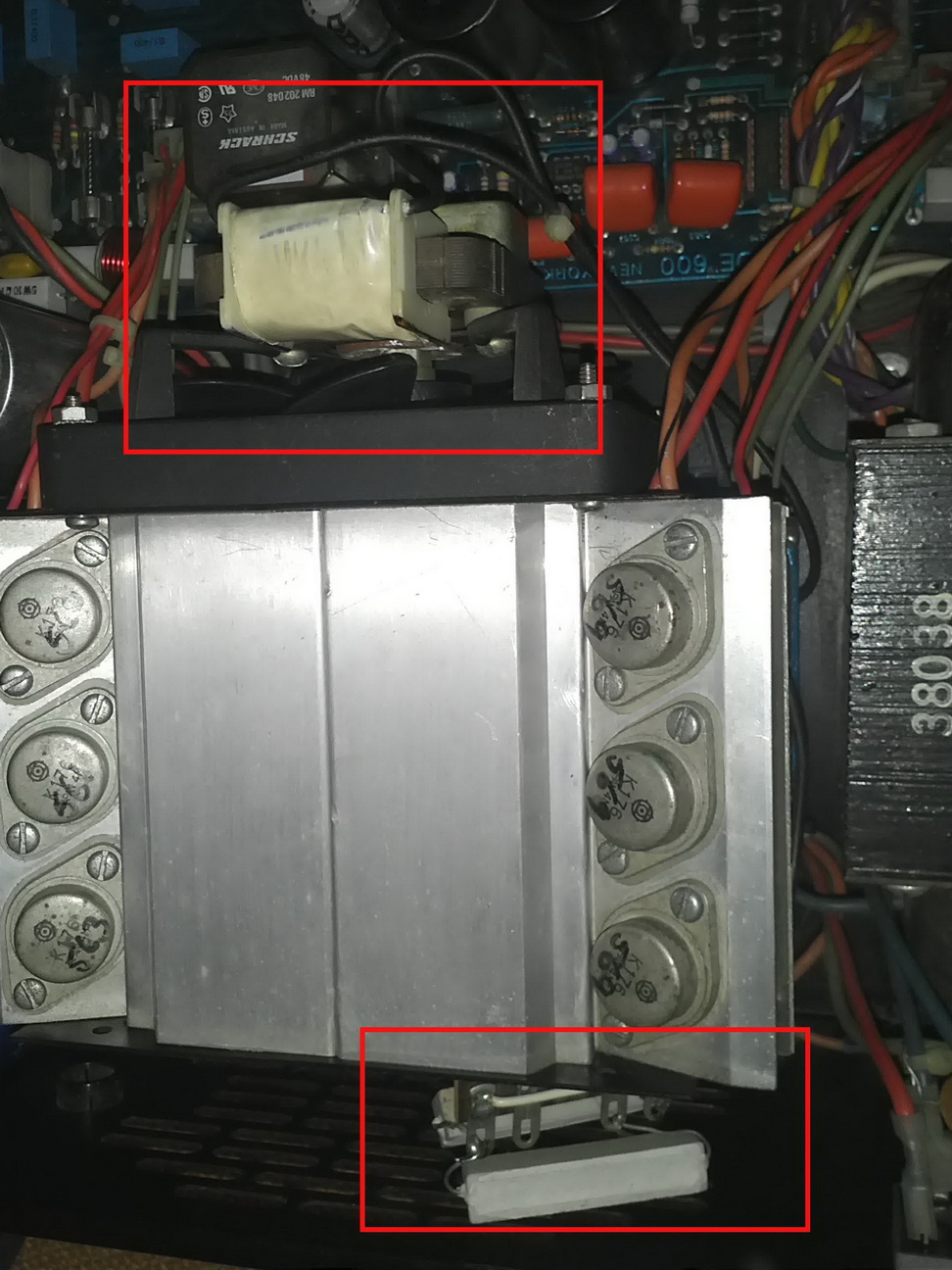

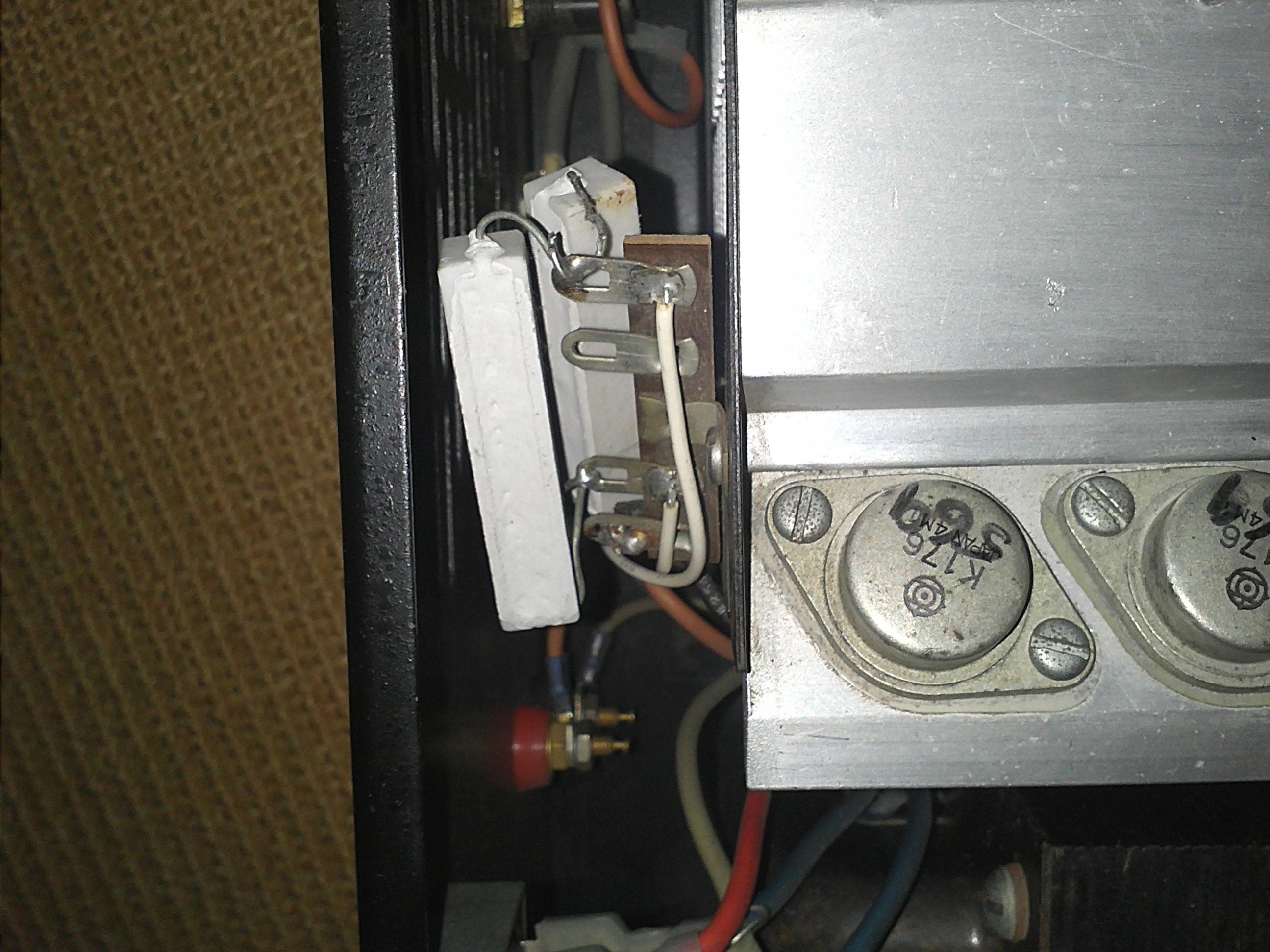

Thanks, Kevin. I believe you're correct. Here's a picture of the heat sink with the thermostat and the fan in the red boxes. The 2nd pic shows the thermostat (I think).

The resisters are 50 ohm 10W.

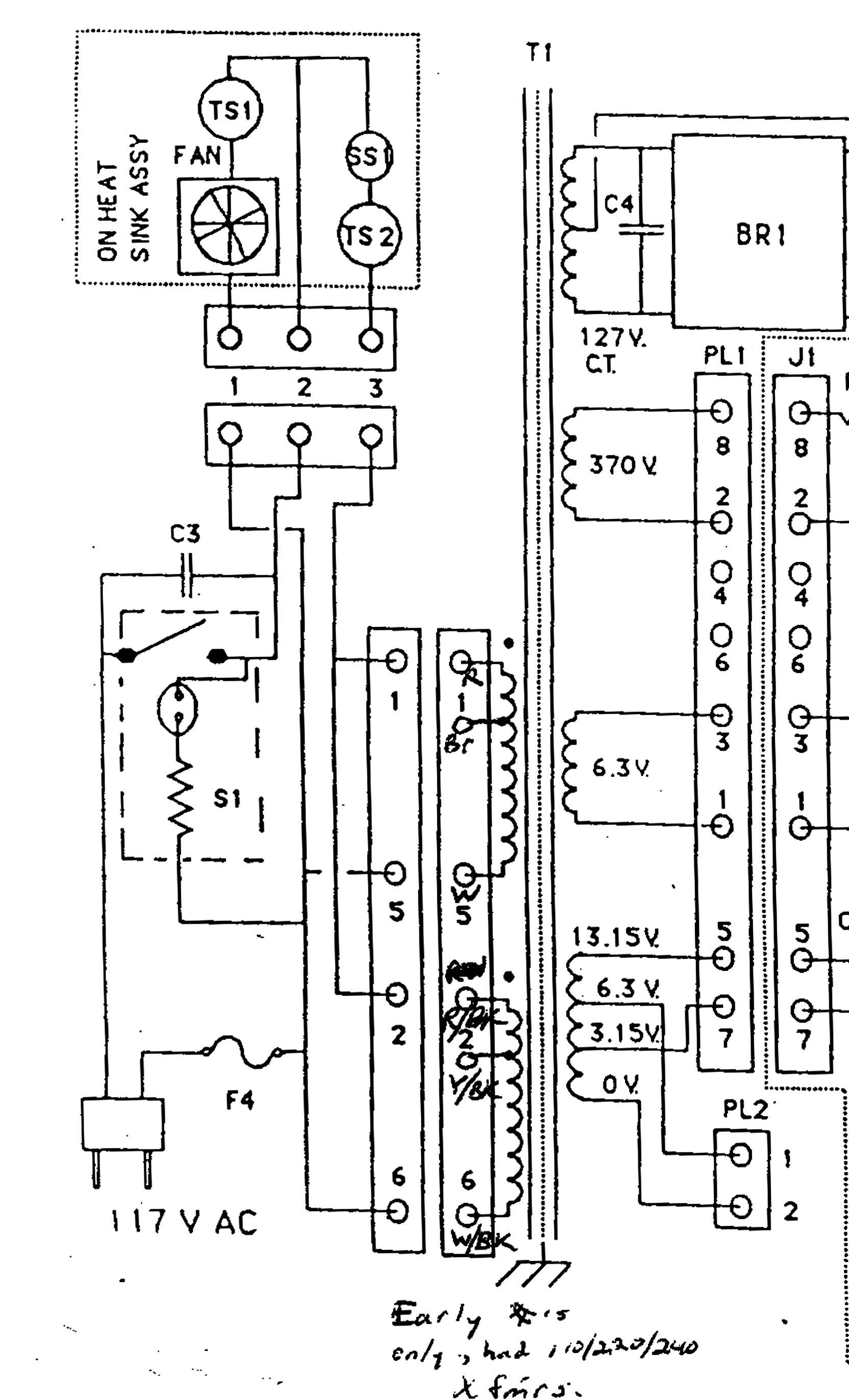

The schematics show something for the fan I can't interpret. At the top left of the image below, you can see the fan and "TS1" "TS2" and "SS1". I don't think there is an actual "thermostat", just two 50 ohm 10 W resistors that regulate the fan operation.

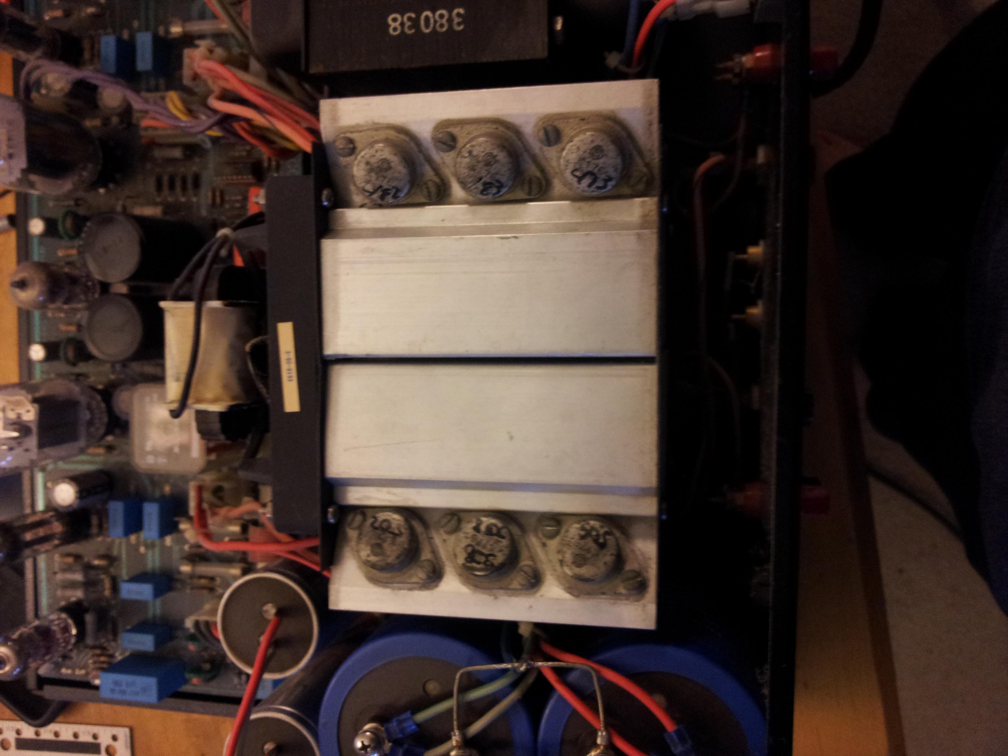

Are you sure your moscode has not been modified ? The resisters(you labeled as thermostat) that you circled in your picture, looks like an after thought. I found some pictures on the internet of other 600s which doesn't have them. To double check. I've pulled mine from storage and took a picture. I believe the TS-1 TS-2 are thermostat ... one to kick up the fan the second one to shutdown the amp.
Is your heatsink getting very hot ? You might want to bring to a repair tech if you are not comfortable in taking it apart and finding whats wrong. I believe the output stage comes apart pretty easily.
