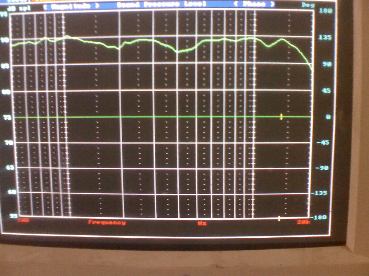

🙂 I remember the first xover I designed for the JV60. Measured like a dream come true. 😎 Then I took it out to the listening room and plugged it in, sat back,
Terry
What was the design axis? Distance? Baffle dimensions? It's rather difficult to see what the situation is with a single point summed response and no other data as to conditions.This is the completed response. I do not have a lot of design data. It was a long time ago, and two computer crashes ago.
Hope that worked!
Terry
The 2k dip should I suppose be credited to baffle diffraction of the woofer and likewise the mile peaking at 1K.
There's a fairly broad dip centered at 4K, the source of which can't be discerned in seeing only a summed response. Given that the woofer is supposed to be flat in that area and that the tweeter is claimed to have had a true first order response in the crossover area, something is amiss to cause a significant dip such as that. It's sure not what I would expect from the two drivers' curves shown by Morel, but then manufacturers have a habit of showing optimistic curves. I would suspect phase issues.
The measurement stops at 500Hz. Baffle step is typically just at the relative 0db at this point. That output is trending down and will be dropping below that point by a full 6db, so the measurement is missing a significant part of the response. The indication would be a rather lean bass, but maybe that was considered desirable.
In the end it still does not appear to meet a first order summed target unless the woofer is somehow rolling off earlier than in Morel's curves. The phase influence of the tweeter rolloff may be part of the reason when such a high crossover is used.
It would be interesting to see the polar response given the rather wide CTC with a 6K crossover.

I thought that +/- 2dB was quite good. It was +/-2.5dB with raw data and +/-2dB with 0.1 Octave smoothing. That response is taken at 1 metre. with less than 1 watt of power. Speaker was 92dB at 2.83V. It was a point source using 2 MW144 and the DMS37 tweeter. Sorry but that's the only graph I have of that system.
Terry
Maybe the sensitivity was different back then, but that would be a surprise. The Morel info I have shows a sensitivity of 1W/1m as 88db. The MLSSA curve would be about 87db and I suspect is 2.83v. Neither one gets to 92db. If at 1m on the tweeter axis, a full range midwoofer will likely have some off-axis droop, these aren't truly point source drivers. That would help explain the 4K dip as well as relative phase in that area.I thought that +/- 2dB was quite good. It was +/-2.5dB with raw data and +/-2dB with 0.1 Octave smoothing. That response is taken at 1 metre. with less than 1 watt of power. Speaker was 92dB at 2.83V. It was a point source using 2 MW144 and the DMS37 tweeter. Sorry but that's the only graph I have of that system.
Terry
The DMS-37 would be in the 92db range with just a cap, but I don't see how the combination does 92db given the data that Morel provides. In any case, a full range MW144 on a baffle is going to act as all dynamic drivers do on a baffle, it's going to operate into 4-pi below baffle step so the area below 500Hz is going to lose 6db. That was one key point I've been trying to make. The measurement supports that this in fact occurring, even though we only see the area above 500Hz that will be peaking due to baffle diffraction. Maybe lean bass wasn't an issue, that falls into the area of preference. It will be the case, however.
There does still seem to be some destructive interference in the overlap region. If the woofer is flat to 8K (0db relative) and the tweeter is crossed to be -3db at 6K, there is not going to be proper summation as a BW1, especially with two drivers with different sensitivity ratings. It may be relatively flat due to phase issues, the 4K dip indicates something is still a bit amiss, but then we're also still limited to a single point. I actually would have expected the area above 6K to show some interference (call it non-optimal summation), but it may be that the off-axis droop (assuming that the measurement is on the tweeter's axis) is responsible for preventing peaking that would have to occur at 6K up if the responses were as shown by Morel. The gradual rolloff of the MW144 is certainly better than most to 10K, though there will likely be a much quicker rolloff at relatively low off-axis angles. I can't say if it's like the Dynaudios I used to use.
In the end it is a relatively smooth on-axis response, but the baffle step loss and the expected uneven power response would give me pause. I'd need to see individual responses to include off-axis (or sims) to get a better feel for the actual integration. I would have an issue with a driver that is becoming directional well below the crossover point. Morel's curves show only one off-axis response, I suspect it's 30 degrees, they don't even say. It starts to drop at 4K. Personally I wouldn't take that driver so high, especially given the ability of the MDT-37 to go as low as it can. I would consider as high as 4K and that doesn't address the CTC spacing issue. Very small changes vertically are guaranteed to see quickly varying destructive inteference due to path length difference where the spacing is at least 2x the wavelength at Fc (6K).
But again, to each his own.
Dave

The issue that concerns the 4K broad dip still remains unanswered as well, since the claims were that this is a true first order crossover. Were that the case, there should be a peak at the stated Fc of 6K given that the MW144 is flat (not down 3db) at 6K.
