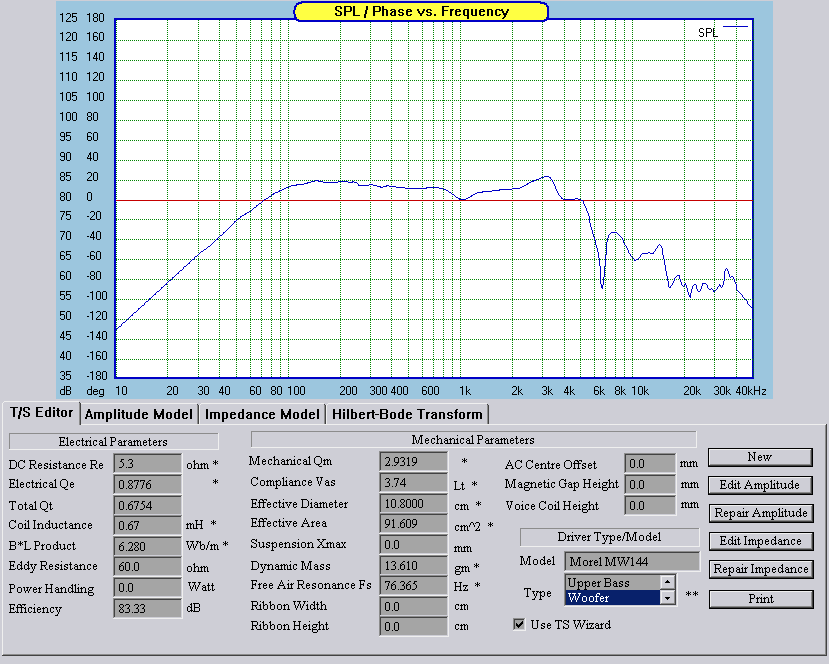

here is the link to the MW144 datasheet http://www.eltimaudio.com/products/MW 144 datasheet.pdf
I'd never really noticed that it had the impedance peak at about 75-80Hz!!! must be an in box impedance plot too.

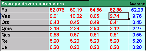

The ones I tested were also the Isreal Morels. (which, in my opinion are the REAL Morels)wintermute said:I don't think it can possibly be the same driver, either that or something was horribly wrong with the sample he had or something went horribly wrong with his testing (no offence zaph... I know I have had some doozies at times 😉 )..... It's not just the FS that is so far out, look at the Vas less than half (closer to 1/3rd) my measurement, the le (more than three times my measurement) and the qes which is at least half as much again..... about the only parameter that bears any resemblance is the re....
My drivers are from Isreal btw....
There's always the chance I screwed up the measurement, no denying that, but it's more likely that there was simply something far out of spec with the woofer. It's not like I tested a a large batch, just a pair. I've tested a lot of woofers, and I've come across some that are even further off that that, but I've come across some that are dead accurate to the manufacturers specs.
I use delta compliance because it's much more accurate than delta mass. I frequently compare modeled response with measured specs to actual measured specs in the modeled box size. Usually the F3 is right where my software predicts it to be.

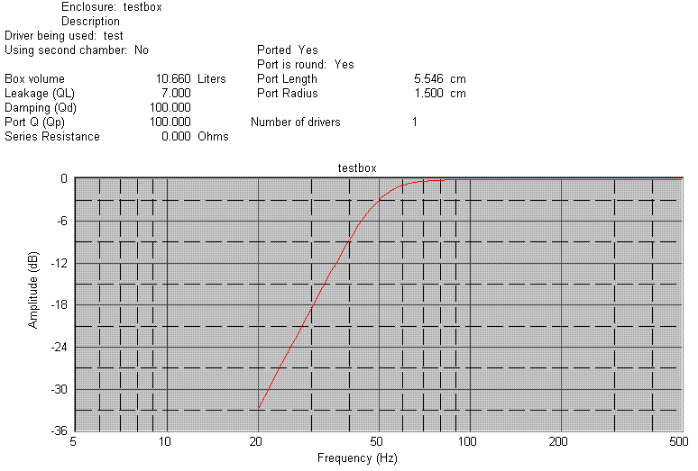

I used delta mass because I didn't have a test box (or the facilities to build it, I drive 7 hours to my parents place to get acces to woodworking facilities).... probably something I should do when I go up to do the final boxes as I'll have spare MDF. The other reason is that I bought an extremely expensive pair of scales for acurately measuring the added mass, so I feel I have to get back my investment 😉
when I got some valid acoustic measurements, they matched up pretty well with my sim too, except that the level was rising a bit instead of falling from 200Hz down, but the F3 was pretty much spot on.

just wondering how you have gone??? I noticed the other day they morel Isreal now have the Fs listed at 52Hz on their web site for the MW144, which is pretty much what I measured.....
I'm still doubting my gated measurements.... but subjective testing with a basic 1st order crossover (ie no impedanace comp, just values chosen based on impedance at xover freq) have been very promising....

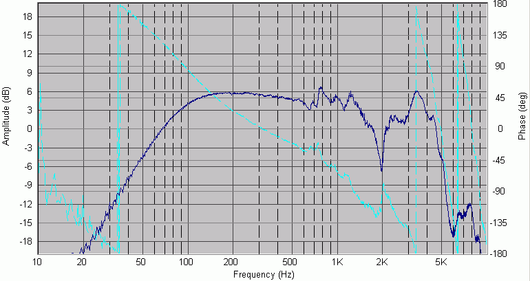

I'd say the new specs are the ones you should trust. Note that I did a free air measurement a while ago (don't know where I saved it, or if I did at all) I had a big dip at 1Khz not quite as wide as on the new datasheet but overall the response graph looked quite similar to that. Funny thing is, in a box there is no dip at 1Khz at all. Maybe they have decided to put the specs up warts and all 🙂
I simulated a 4th order LR crossover using my audigy II ZS and played some music. Must say that appart from the lack of low end they sounded very nice 🙂 seemed about best crossing at 2.8Khz to my DMS37.

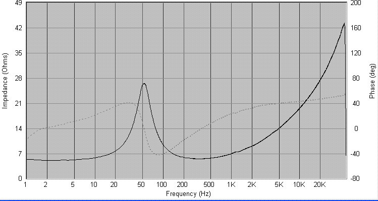

I never managed to find any datasheet on the morel isreal site, I'm glad they have them up now! the one I had was off Eltim Audio's site...... this new one looks much more realistic to me!!! (or at least it seems to match my driver much better
You might want to check this post ---> http://www.diyaudio.com/forums/showthread.php?postid=734505#post734505 the blue trace is pretty smooth IMO, yeah it is a nearfield measurement but the problem with nearfield and higher freq's is that the higher the freq the lower the relative level, I think it actually still gives an accurate idea of the smoothness, just that the magnitude is more and more inaccurate with increasing frequency.... overall I think it is pretty good 🙂 after re visiting some of the measurements in dickasons cookbook, I decided that they were not as bad as I was thinking!!
