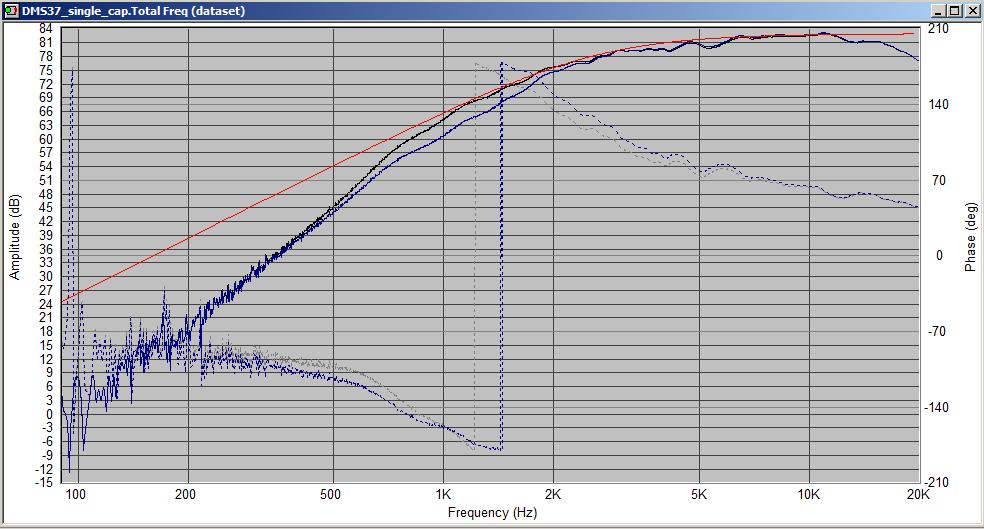

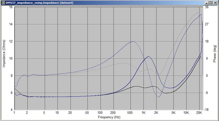

I would not bother with impedance compensation on the cat378. I have the DMS37 (it's predecessor) these tweeters have ferrofluid and thus a very low impedance peak. Compensating it will result in virtually no difference.
also note that my examples had resonant peak nearly 400hz higher than the datasheet!
I ran sims to check what difference there might be. As you will see it's almost imperceptible.
Tony.
Tony.

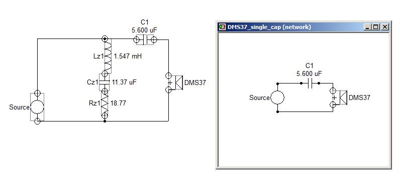

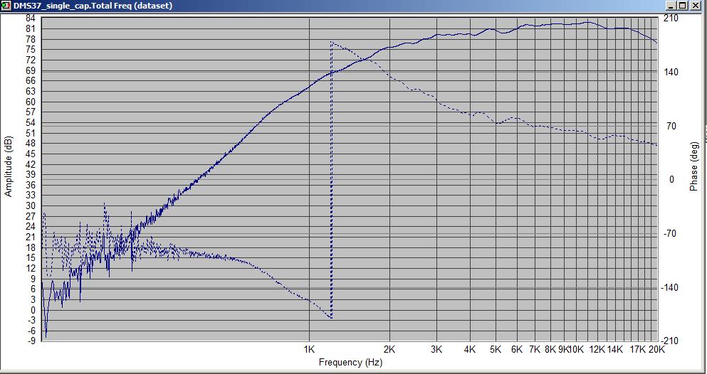

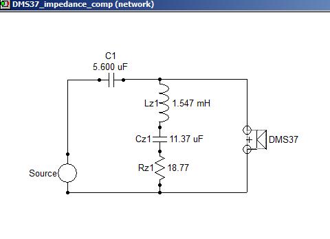

Bugger i stuffed up with that! Teach me to sim before ive had my morning coffee! I'll get back to you. I thought it odd it made no perceptable difference! :embarrased:
Tony.
Tony.
Well that's a bit embarrasing!! 😱
I'll revise what I said to it will depend on your actual crossover!
See below the difference when it is implemented correctly 🙄 I added in an arbitrary goal that seemed the closest fit to the curve achieved with the 5.6uF cap. The blue is with the impedance compensation network.
The red curve is target of 2.6Khz 2nd order bessel at 83db.... Depending on what your goal was and how you chose to get there, the impedance compensation may make it better or worse! it clearly is reducing the spl in the resonant peak range, but whether this is a good thing or not will depend on the implementation.
Sorry for my posting of mis-information, and thank you freddi for questioning it!!
Tony.
Tony.

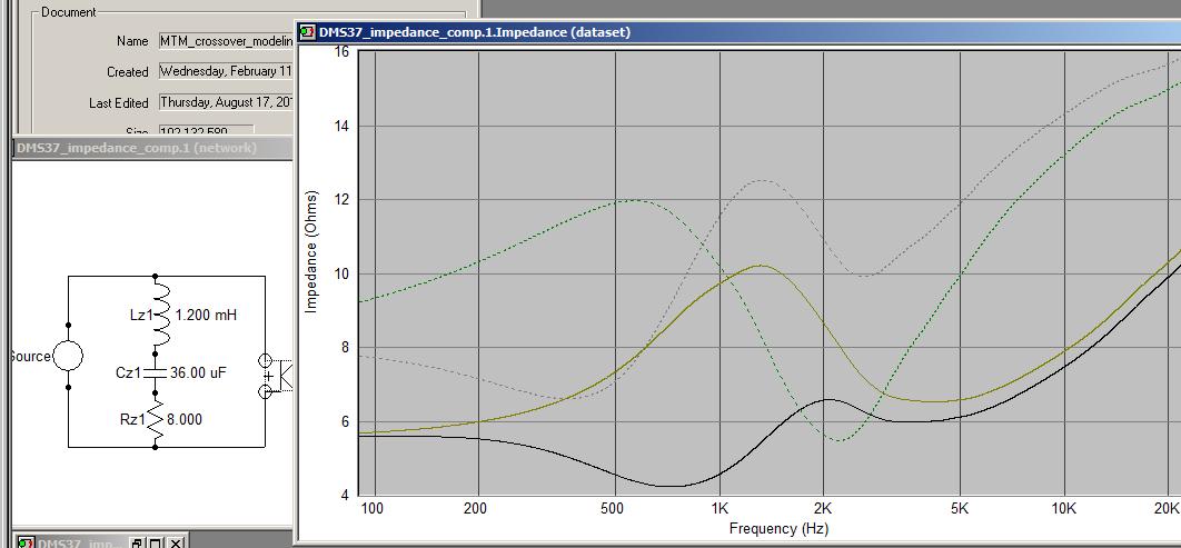

Thanks - (I'm on stale before bedtime Gevalia right "now") - its going to be 5.6uF with CAT378 and most likely the unfiltered Eminence B102 - I'd like to protect the tweeter. What happens if the values are set to around 1.2mH + 45uF-50uF + 6R-8R ? I'm just guessing from my graph below. I probaby can string something together and take a measurement.
- - would the filter do enough good to matter in reducing excursino? -
resonance looked pretty close to 600Hz on my sweep below (green trace)
it was hitting 4 ohms (yellow trace) with ~47uF, 1mH steel-core choke + 5.2R, but missing the target
If the primary concern is reducing excursion, then from the second sim with my DMS37 there is a reduction in SPL of around 3db with the notch at the resonant frequency (and that tapers off gradually over a fair distance iether side of the resonant frequency).
Whether this will help a lot, a little, or not at all I'm not sure.. What it might do is make your tweeter curve closer to your target acoustic response, but it could also make it further away. This is the real crux I would say. You can meet the target curve in multiple ways, and if one of those is using the notch then it may be an option, if you can meet the same target curve without the added complexity of the notch then I'd do that instead, because the excursion will be dependent on what the actual rolloff (regardless of the crossover topology to achieve that) .
