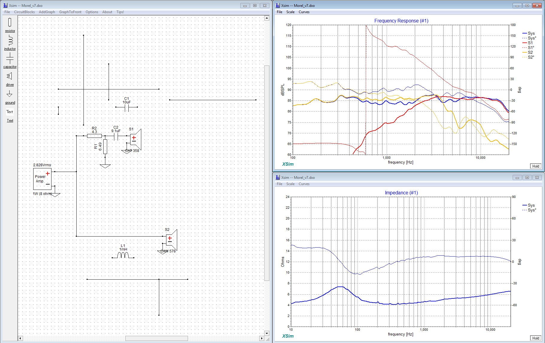

I have a Morel CAW 538 and CAT 378 I am trying to design into a 2-way bookshelf in a 7L bass-reflex enclosure tuned to around 42Hz. I know if I flush mount the tweeter and surface mount the woofer I will have near perfect time alignment. It is coming down to the crossover and I wanted to bounce a few ideas off the forum because I see two strategies.
First strategy is to do a simple 2nd Order LR Filter at 2500Hz with an L-Pad on the tweeter and call it a day.
Second strategy is a little more ambitious, but I think may yield a better result and take advantage of the excellent FR of these drivers. I think I can get away with a Dynaco A25-esque design. The woofer has a nice rolloff starting around 4000Hz with a small peak around 8000Hz (cone breakup?). My idea would be to address this with a 1st-order filter around 5-6kHz to make sure it is far enough down it will be inaudible with a simple 0.5mH coil (impedance is about 13 ohm at this frequency). Then use a 1st order on the tweeter around 7000Hz. I say 7000Hz and not 4000Hz because the tweeter has a subtle rise (going backwards towards the crossover point) from 6000Hz-3000Hz that could be nullified by the gentle slope of a 1st order crossover. I would likely use 2.2uF cap. Am I crazy or would something like this work and give better transients?

I hadn't considered directionality, but the tweeter is very directional as well so I don't think that will be an issue. I forgot to mention, but I will use an L-Pad on the tweeter in this configuration.
There shouldn't be a power dip at 4k. The tweeter has a slight (5-6dB) rise around 4K so the idea was to move its crossover point a little higher and take advantage of the gradual slope of a 1st-order crossover to stamp it out.
With this in mind, are there any glaring issues with this idea? Suggestions for improvements?
If your aim was to get a flat response, then that is a reasonable goal. The method is fine.. On the other hand how is this different to using less components to complement the natural roll off the woofer. Is this better in this respect than a 2,500 cross?
I'm not sure if I understand what you are saying. I think this is the fewest amount of components I can use. A cap on the tweeter and (if needed to stamp a breakup peak) a coil on the woofer with an L-Pad on the tweeter to attenuate. Can it get any more simple?
As with the point about crossing your tweeter.. whether the rolloff comes from the driver mechanically, electro-mechanically, or by way of extra components the end result is the same. You suggest using less components, but more driver rolloff at the same time. The response and its phase end up the same as if you'd used more components but at a flatter region of the driver aiming at the same overall rolloff.
If it were me I'd probably end up using more components than that as I would want 5k to be sufficiently out of range.
Speaking only about electrical order of the crossover makes little sense. You should aim for a specific acoustic slope. In this respect, looking at the spec sheet your horn loaded tweeter can probably be crossed 2nd order LR at some 2.5KHz with only one cap. But I suspect that in order to achieve the same slope on the mid will be more difficult and will require more than a single coil. Time to open a crossover design app (XSim, VituixCAD, Boxsim) and perform some tests.

Thanks for all of your insight. I will pull out my old windows laptop and run some simulations tonight. I do have a Dayton DATS I can use to measure the speakers as well as a cheap calibrated mic. Which of the parameters did you find far off from the spec sheet?
Seeing as the drivers are seemingly descendants of the mw144 and DMS37 I would surprised if they didn't have similar characteristics. What was the range you found most success crossing them over at? I am tempted to just try your crossover point and design, but with the very natural roll off of these drivers it seems like there has to be simpler solution. What made you finally go for a higher order crossover sonically?

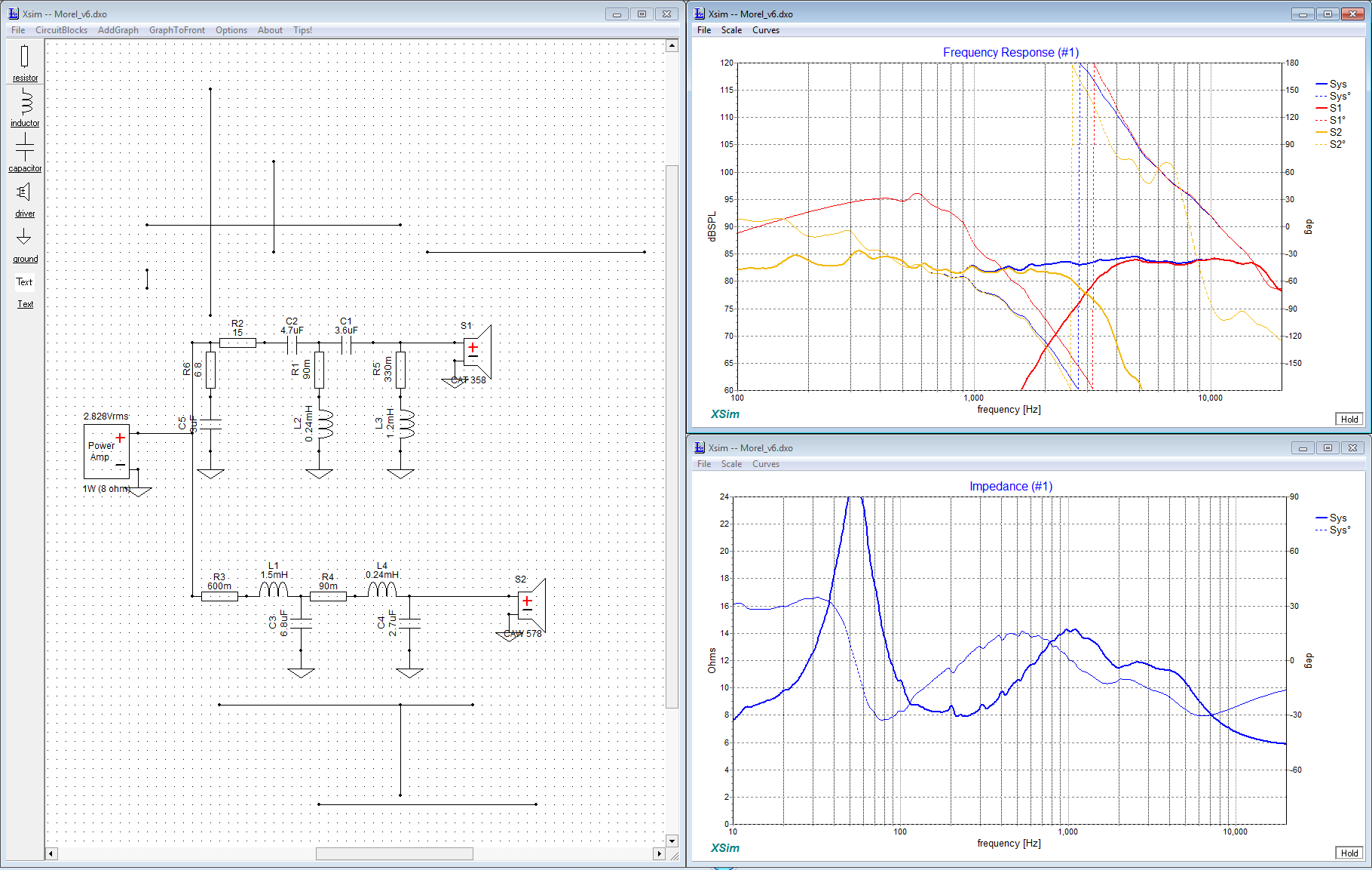

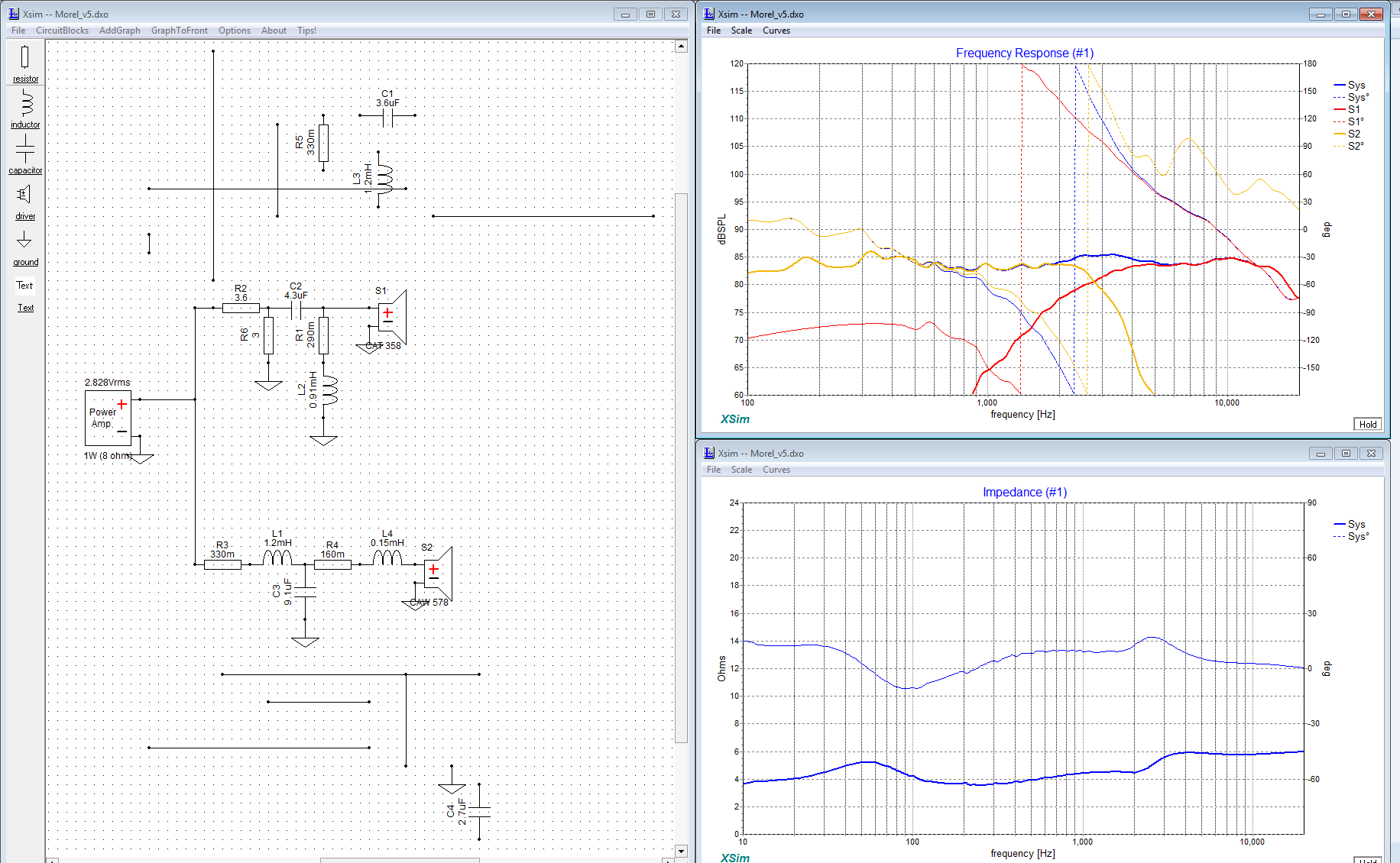

I brought these into XSim last night and played around with them for a few hours.
I got interesting results with the simple 1st order on the tweeter. The best overall FR resulted in a higher crossover (3500Hz) which is higher than the driver spacing should allow, but it is so beautifully simple I think I may give it a go.
The 2nd order on the tweeter and 3rd on the woofer worked and used less components than the 4th order filter, but not well enough to justify its use. On paper, the 4th order filter is clearly the best. I forgot to complete the L-Pad on the screen shot I took of this so ignore the impedance plot. When completed it looks good.
Now its time to build the box for the speaker, try and take some measurements of my own, bring them into XSim to see how far they deviate from the manufacturer's, and tweak as needed before buying parts.

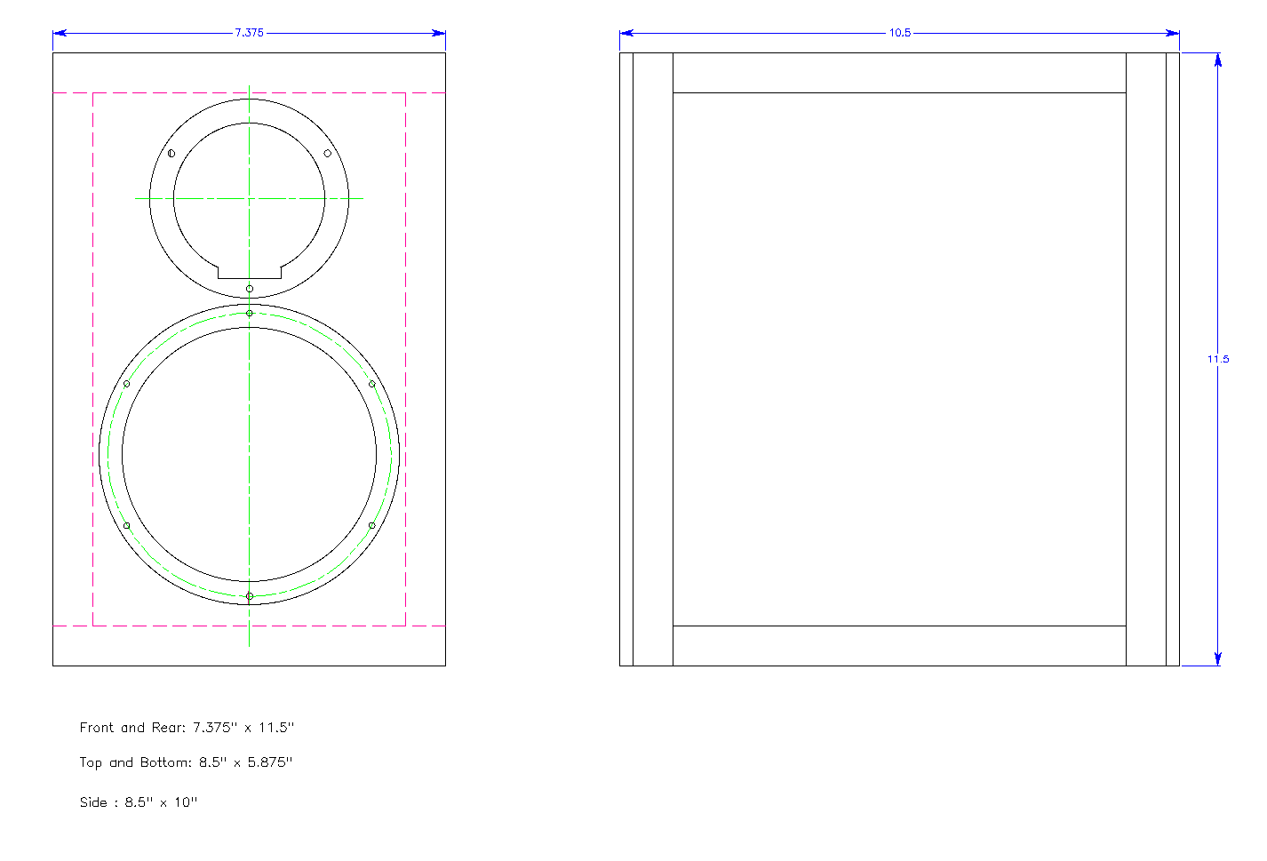

I drew up a little box in CAD over my lunch break today and will see if I can find time this weekend to build one so I can start to play with them and take some measurements.

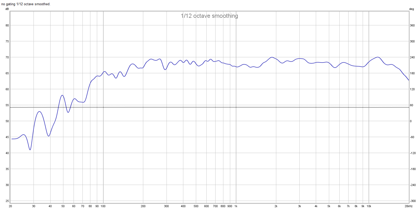

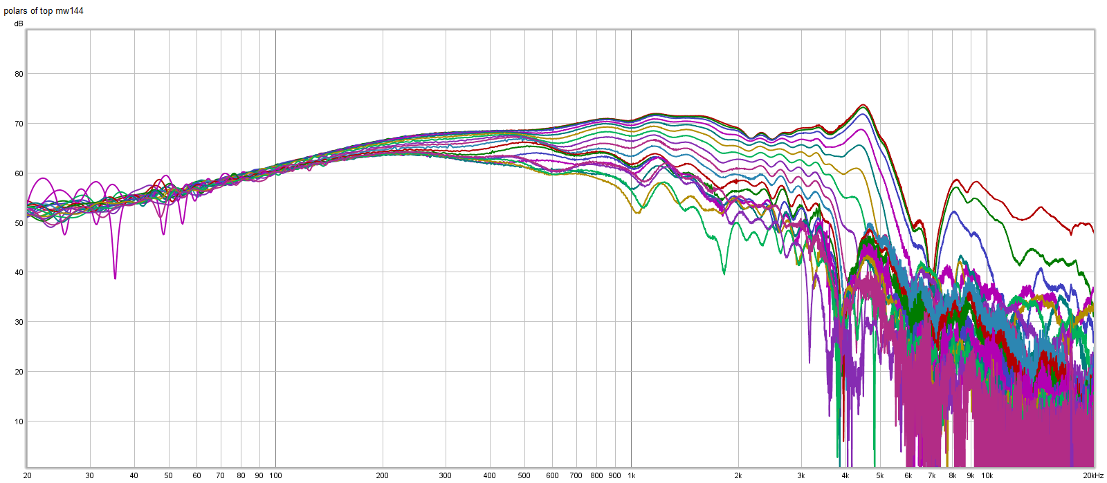

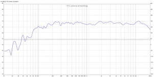

Hi drewrf the problems with my mw144's was big SPL anomalies after 1Khz with the problem centered around a big dip at 2Khz (see attachment). Looks like you don't have that issue at all which is great.
Despite that I managed to develop a crossover that gave me a pretty decent response (and they sound really good), but not without complexity in the crossover. the crossover point I settled on was 2.8Khz This was the frequency where it just was easiest for me to get both drivers playing well together. I have contemplated doing a 2.2Khz crossover, and have run some sims where it seems to work ok as well. My particular MW144's just can't be crossed higher that the 2.8Khz due to their response anomalies, and ideally probably should be crossed much lower. 2nd attachment is of the final speaker, measured outside, no gating, 12/th ocatave smoothed.
For me the biggest plus with the 4h order acoustic at 2.8Khz was that the speakers stayed much clearer at higher levels with dense music.
I augment the low end with a couple of Vifa 10" M26WR09-08's crossed inactively at 270Hz. So effectively a three way, though I did live with the lack of bass (mine are 5L sealed) for a number of years without any regrets.
Tony.
Thanks for getting back to me with your experience.
