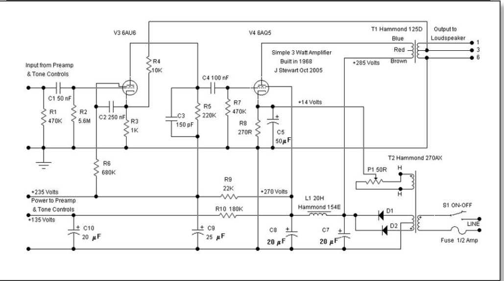

If your concern is that the screen is at a higher voltage than the plate, that is not a problem at all. The screen resister is meant to suppress parasitic oscillation of the output tube, as sometimes happens, especially when driving a complex load such as a loudspeaker. The 100R is OK, just needs to be carbon composition so that it still looks like a resister at RF.
Another common misconception is the need to run indirectly heated tube heater on DC. They are meant to run on AC, that is why people put a lot of effort into perfecting them. The added complexity & cost of a DC supply for IDHT is not justified at all.
And if there is hum, better start looking for defective tubes or some other problem in the system. The brute force PS in the original design of this amp is a disaster. An R between the filter C's is a good start. A small choke would be even better.
Try something like 10R in series with the PT HV & the diode bridge. And remove the paralleled caps from the diode bridge. I think your HV PS circuit is a high Q circuit, needs some resistive damping to prevent ringing in the AC HV winding. A scope would see that.🙂

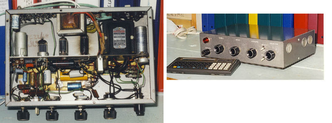

I've used the basic circuit in this thread often, never with any problems. The attached amp has run in my workshop since 1968. Only a couple of 6AQ5s were ever replaced. There is no hum with AC on the heaters, even from the on board very low level magnetic phono preamp.🙂

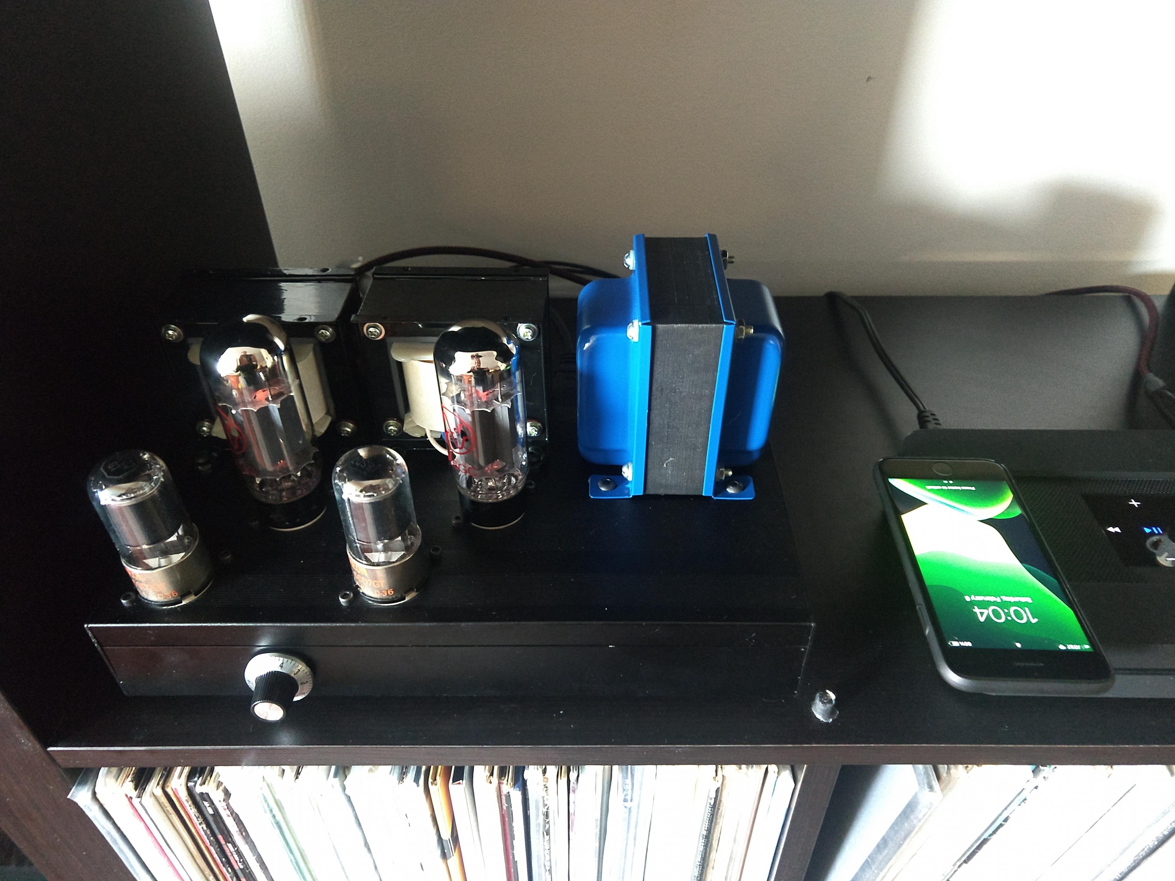

Got a photo?🙂
Sure! You can see how tiny this thing is, footprint is roughly equivalent to a piece of letter sized paper. Because I hardly know what I'm doing, i was able to cram all of those 330uf caps under there as well, in what is likely far less than a conventional layout which will have to wait till next time it's popped open to photograph. I did my damndest to keep all the audio stuff to the left and all the power stuff to the right.
So is the earlier suggestion (thank you) of a resistor between cap 2 and 3 and reducing caps 5 and 6 to 47uf a good place to start? I ask because I have all that stuff handy and why not make the stuffed to the gills underside a bit less stuffed?
Haha, i don't want to say i'm not savvy enough to use/understand the emulator, but in reality, that's just it (i.e. can't seem to figure out the transformer's impedance using an ohms law calculator). I'd like to understand what I'm doing/why it makes a difference. I realize I have a massive amount of capacitance in this design, the music plays for upwards of 45 seconds after i flip the power switch, but in the end, what the was the ultimate goal of this layout? You'd mentioned brute force......is this opposed to a choke or something more conventional? I'd originally settled on this design because it didn't have a choke (see picture).

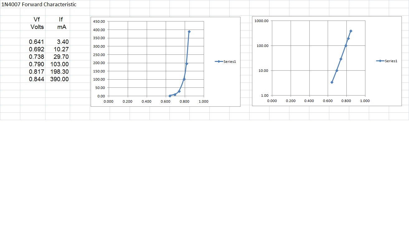

Attached are linear & log plots of a real 1N4007, on the bench. A few years ago I did Silicon, Germanium, Selenium, Red, Green & Yellow LEDs. The data here is from that group.🙂
