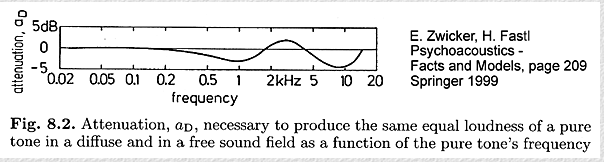

You nailed it! 🙂 Now I'm going to summarize what methods we can use to implement it on different speaker types.
Correction for in post #6
Initial text:
"My conclusion from this picture is that for in-room listening for frontally lineary responding speaker the best dispersion pattern curve would follow this suggested equalization line, or directivity index curve following just inverted version of it."
Corrected version:
"One that designs correct loudspeaker system for in-room reproduction must aim for most linear frontal response measured in anechoic chamber combined with DI (directivity index) curve that follows attached psycho-acoustic correction EQ curve suggested by Zwicker/Fastl and that was suggested by Joachim Gerhard in his thread. In other words narrower dispersion at each given frequency would will excite less reflections which equals higher DI and makes direct signal less masked by reflections while wider dispersion (lower DI) will do the opposite therefore creating desired D/R EQ acoustically rather than electronically. Sum of direct/reflected signal will therefore be correct for in-room equall loudness perception. As this will most probably give correct finally perceived sound in particular room type achieving this DI for particular reference speaker will just set an average baseline for usage in different room sizes. Confirmed yet by few the curve shows with some probability how majority of people would like the sound to be reproduced in rooms to be perceived as linear in terms of equal loudness in particular room used in their experiments. Necessity of correction is highly disputable as it seems to be not widely adopted by industry yet.
For most precise reproduction experience in any particular room that has feature set (size, reflectivity, diffusivity) different from room used for EQ curve creation using appropriate Q (to be determined easily) for each parametric filter. This final EQ must be applied to direct signal to achieve resulting sound power curve that complements with the psychoacoustic EQ curve and satisfies desire for most linear perceived signal (yet to be determined). This may shift direct signal off linear on-axis response for very small levels, but it is the best compromise I can think of unless speakers are designed for the one particular room. Experiments with equalization of symmetrical omnidirectional speaker has shown that only correct sum is what matters, regardless of what we change, in this case EQ of both - direct and reflected signal. This part is the most controversial as it goes against to some historical canons I guess.
For loudspeakers having high average DI and/or used in larger rooms (latter to be yet determined) less of this type of correction will be needed. DI=0 at particular band sets sets maximum of the correction level needed in some 'standard' listening room used by Zwicker/Fastl to equal the correction level shown on the curve. Minimum correction level is yet to be determined or must be found emphirically. 'Critical midbass' or band of 400-500Hz may be a good starting point as speakers directivity at this band is usually is very low already (close to Shroedders frequency) but not yet influenced by room modes"
This essentially answers what in my opinion defines more rewarding loudspeaker directivity pattern for in-room stereo listening. May apply to mono loudspeakers as well. For multi-channel systems where frontal speakers are required to have much narrower dispersion compared to side speakers appropriately corrected DI curves must be achieved for each type.
If moderator could move this to the top before prologue it would be easier for more busy people to get to the point quickly without reading all through.
Any criticism is welcome -as always. Thanks!

This is not what I was referring to. Try pages 457 - 461.

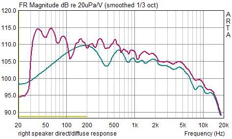

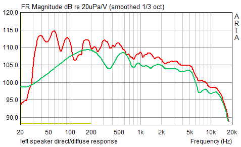

I measured the direct/diffuse ratio at my listening point:
Don't look for the response curve as is - the microphone was directed to the ceiling to get the full horizontal response.
Red is diffuse field without gate (total power response), green is direct response with 5 ms gate. It looks like I prefer only 2-3 dB difference compared to the 5 dB Klippel is talking about.

The graph you've posted is only true for pure tones. We don't listen to pure tones.
Is that graph also true for phantom sources?
How much is perceived loudness determined by indirect sound and how much by direct sound?
The indirect sound field differs considerably between rooms - how is this incorporated in the proposed directivity-based equalization attempt?
Spectral balance is already corrected for in the production process, so why apply it a second time in reproduction?
Markus, thanks for the questions! 🙂
It could be the same regarding complex signals due highly resolutive nature of human perception of the sound. At least that's what I'm hearing which isn't satisfactory proof alone, of course. I'll try to find the ground for this in the Toole's book once I get to it.
I also can't answer about phanthom sources, but if I remember correctly their perception are mostly delivered through specific frequency band. I must check this, too.
Spectral balance of recordings can vary depending on recording techniques, skill, hearing condition and personal taste of recording, mixing, mastering and finalizing engineers. If engineers have used controlled directivity monitors in moderately diffusive studio control room, or mastering grade headphones or both, result will have good chances to be close to pleasant. I personally always have used Sennheisser HD25-C II for ocassional finalizing tasks of already recorded and mixed material and usually was happy with the result. If D/R EQing gives better percieved balance of the loudness of particular audio bands it should just more precisely reveal the result of studio work as it is.
Perhaps you are asking what will happen to reverberant cues that are put into the final mix in some proportion with direct recording - will they be multiplied or perceived 'as is'?
View attachment 352215 View attachment 352216
Red is not diffuse response. It is direct + diffuse. So plots compare windowing of complete response of perhaps 100ms v direct response with windowing of 5ms. Without appropriate normalization and referencing methods for different window lengths, the results do not show a D/R relationship as the area between two plots.
That's right. And I'm not happy about that labeling either.
