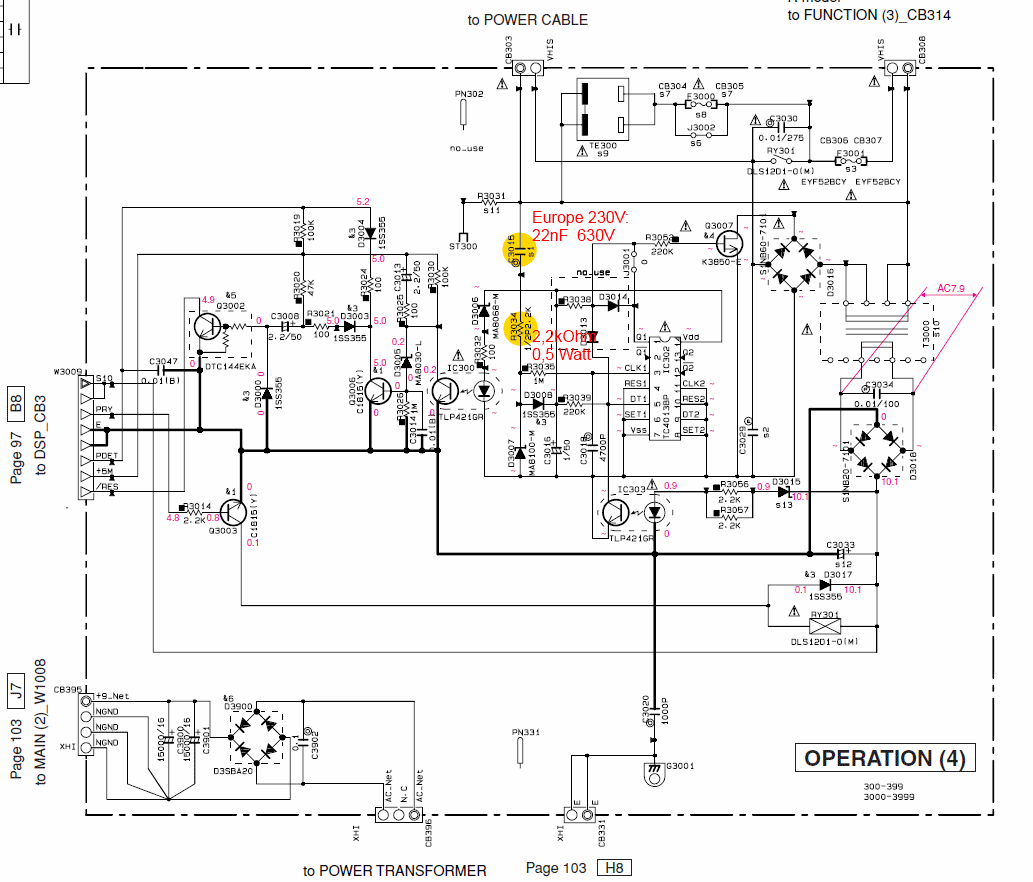

More reliable Upgrade for StBy Control Section in Yamaha's RX-N600 Receiver
Due a bad design in the st-by section always the same parts will be defective after a short time of use - go to the attachment and this video:
More URL's:
http://www.hifi-forum.de/viewthread-220-3803.html
http://www.hifi-forum.de/viewthread-46-16851.html
Are there companies, who offer upgrade kits concerning this stby unit for higher reliability ?
Thanks for an advice.

  • yamaha-rx-n600-schematic-detail-standby-operation-4-pcb-capacitor-c3015-problem_655765.png
