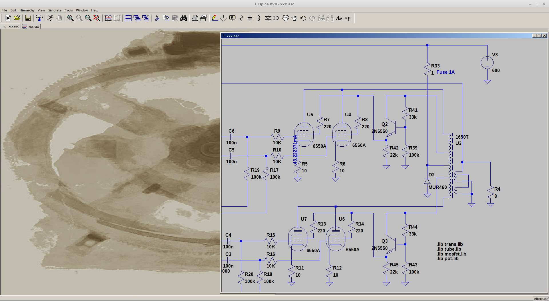

Is this a way of getting more power out of the UL connection. Basically dividing the screen voltage down a bit. This will reduce the UL from 40% to 30%. Am I missing something?
baudouin0,
Good catch!
30% UL.
Another thing I notice about that circuit is:
It puts the screens Quiescent DCV at 75% of the UL Tap Quiescent DCV.
Suppose the UL tap is at 400V. In that case, the screens are at 300V quiescent.
That is Lots easier on the screens in terms of the maximum screen current during the time when the plate is going low voltage on its way toward the cathode.
At 30% UL, If the plate goes to 50V, the change is 350V. 30% of 350V = 105V, that puts the screen at 300V - 105V = 195V
Look at the curves to find the screen current for Vp = 50V, Vg = 0V, and Vs = 195V.
Not too much screen current.
At 40% UL, If the plate goes to 50V, the change is 350V. 40% of 350V = 140V, that puts the screen at 400V - 140V = 260V
Look at the curves to find the screen current for Vp = 50V, Vg = 0V, and Vs = 260V.
Lots more screen current.
How is that for a little bit more analysis?
The simulation agrees.
For the same output clipping level would need to increase the HT from 450 to 510v. But even with this change the peak screen current drops from 54ma to 36ma. For 600v HT I can get 180W output rather than 120W out of the circuit and 44ma peak screen.
Does seem to be something in this.

We need a change of 2.5 mA screen current into a 40% Ultra Linear Tap,
in order to get the same signal power resulting from a change of only 1 mA of plate current into 100% of the same primary winding
(100% of whole winding for Single Ended; and 100% of winding from plate connection to center tap for Push Pull).
For an EL84, I think one of the optimum UL configurations has the UL tap at 25%.
We need the screen current to change 4 mA in order to have the same signal power resulting from changing the plate current by only 1 mA.

baudouin0,
In answer to your post #9 question:
If you AC couple the UL tap to the screen, and you supply DC current to the same screen, then the DC current either has to come from a resistor that is connected to a + voltage, or from a current source.
You can not AC couple the UL tap to a screen that is DC connected to a constant voltage screen supply, or it will short out the AC of the UL tap.
Using a resistor to supply the DC screen current means the UL tap has to drive both the parallel impedance of the screen and the screen resistor.
If you use a current source, then the UL tap only has to drive the screen impedance.
You could feed the emitter (or source 😉) followers (but not their voltage dividers!) from the supply voltage directly. Thus the OPT's windings were relieved from the screen current. Or were you hoping to yield more output power with feeding the screens from the UL taps?
Best regards!
Yes you can feed the collector from the HT providing the base does not overtake the HT. In simulation made very little difference to the output level or the distortion. The screen current and plate current virtually track by a constant ratio.
What it does do is reduces the screen dissipation allowing for a higher HT and hence more output power from the same valve. You could also use it where the OPT has no UL connection.
