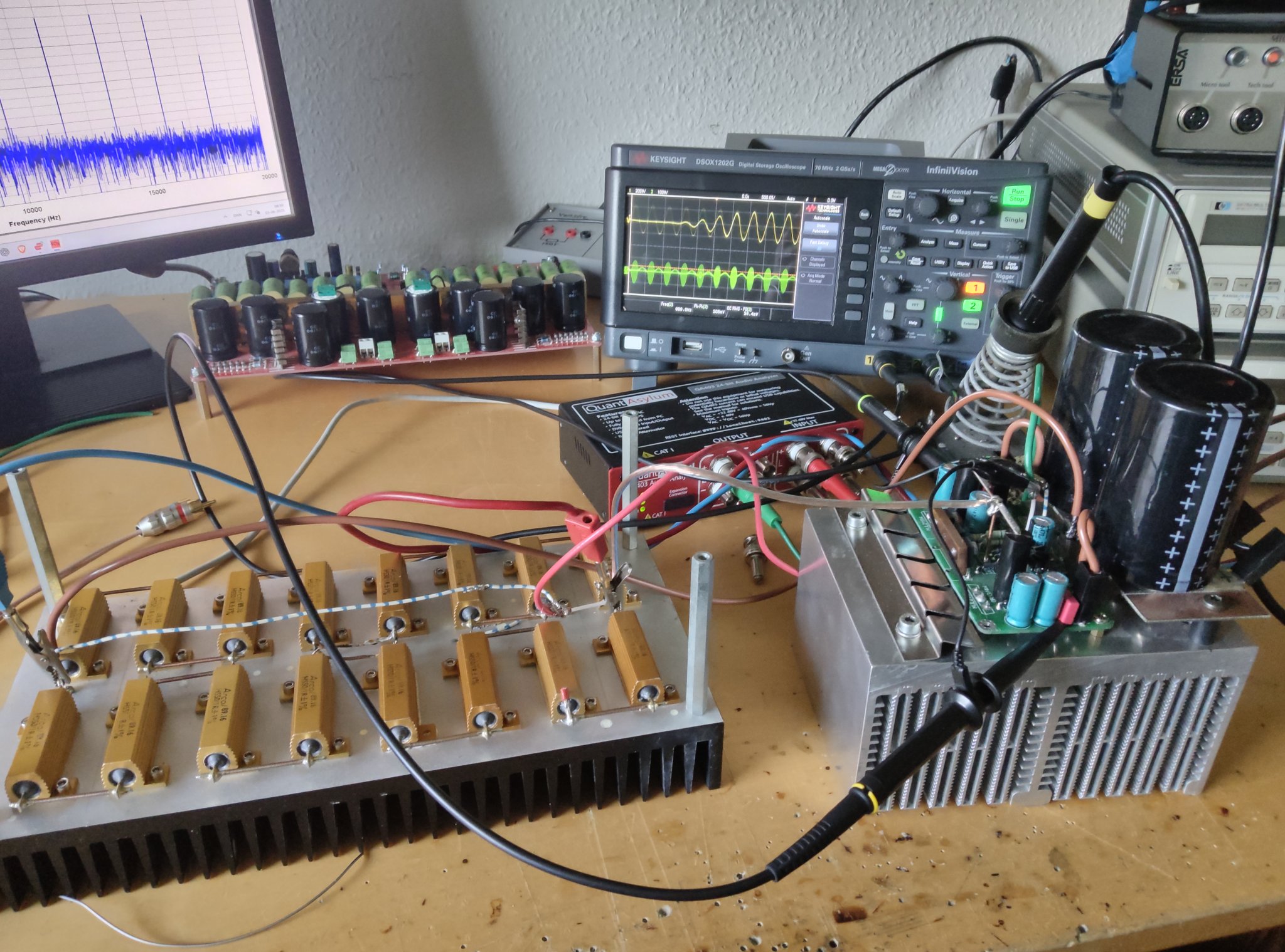

P3a will definitely like a clean dc source, low impedance off course, i just bought a qa403 , i will post som measurements today, 4 different measurements at different bias levels. Im thinking 50ma 100ma 150ma 200ma, see how it beshaves.. i do have som capacitance multipliere i could hook them up afterwards, and re test, see the differences..

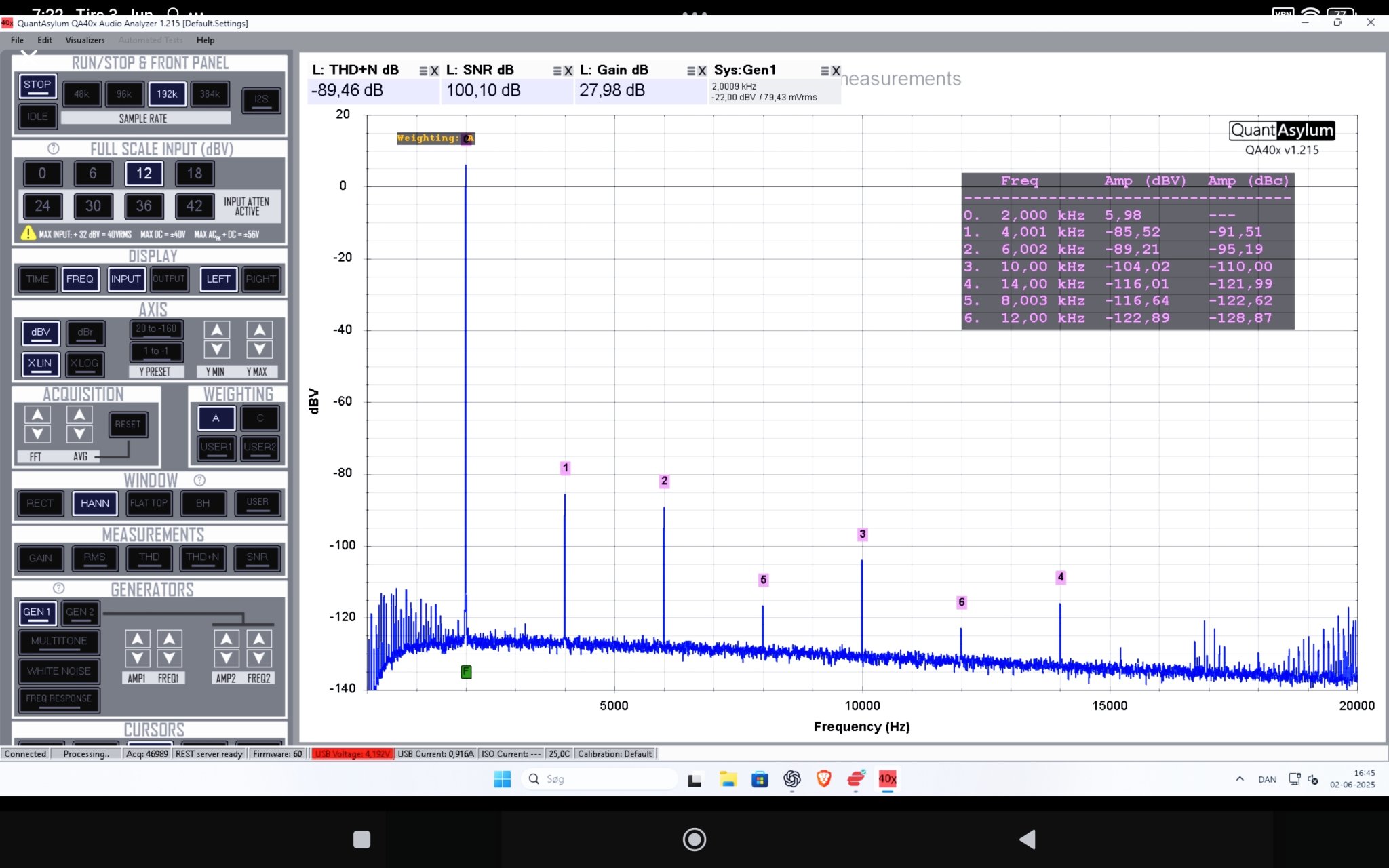

I promised some screenshots from qa403, but im having issues with its current draw, if you notice the red box below, just a tad over 4v.
I should receive a better cable soon.
But heres one screenshot.. load is 8 ohm, 2.5v rms.
Thats roughly 0.0033% distortion.
I Dont trust the readings totally until the red box turns green.
Also im new to qu403 so i need to get to know better .
More trouble.. i tested p3a from a siglent lab psu, right before p3a i have two large epcos sicorel 10000uf... It seems my lab psu is not happy with running capacitve loads..
I need to make a old style power supply with transformer and capacitors instead, when i try push p3a the lab psu becomes unstable.
