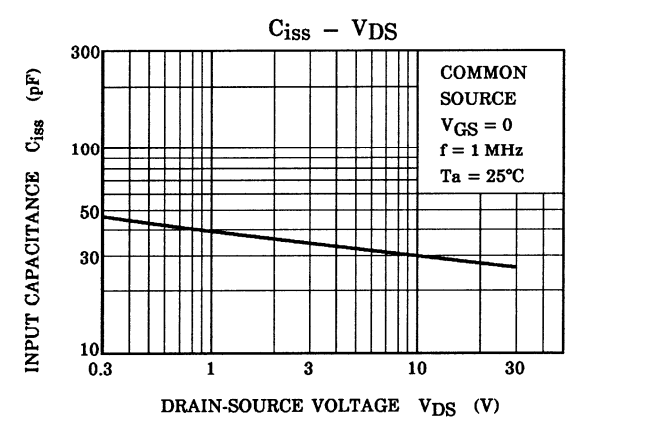

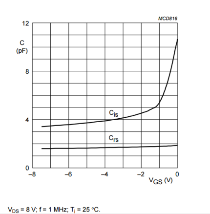

For illustration of the voltage dependence, here two figures from DS of 2SK170 & BF862.
Patrick

So I did 2 measurements today using the circuit in #64.
Vg needed a high Zin buffer (OPA192).
Stray capacitance of the setup was pre-calibrated (0.8pF) and substracted.
With Vds = 10V, Vgs = 0V, driving signal 100mV 10kHz (not 1MHz as in datasheets), Ciss for
2SK170BL = 22.4p
2SK222E = 10.2p
So the measured values are some 25% lower than datasheet.
But it gives a good indication for such a simple setup.
Patrick
