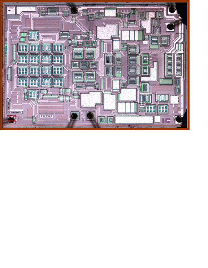

Yes the scopes are Leitz, but they are equiped with high rez video as well as confocal lasers for chip surgery. The total cost is >$100K

This is what you can do with 2k worth of Sigma glass and a Flashlight... 😛
These images are also absolutely diagnostic 😎
Notice BB logo and part number, and BIG JFET's
Thanks for clarification, and nice to see designer of the IC I decapped 🙂
Reader sent me another OPA627 and it matched your image.
OPA627, genuine one this time : weekend die-shot : ZeptoBars
