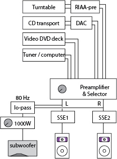

I wish you good luck. If you would like a diagram, see the attached.

The 3-channel solution

I got a doubt in the diagram, even drawing a bass channel, it seems to me that all all sound frequencies would still heading for the main speakers. Am I right?
If I extract a bass channel directly into the tube amp. Is it possible? How to do this? In that case, I'll need an active filter?

All the frequencies would be going to main speakers, but not all the power. The additional power would be going to the subwoofer. If you want to attenuate the lower frequencies, you always could just use a simple capacitor-inductor combination (passive high-pass filter). Many of our audiophiles here though deplore the sound of capacitors, so this will be challenged as a good idea.
The bigger problem they introduce is that there is definite phase group delay ... which can change the perception of ultra-baixo freqüência, of how "fast" it is, and so on.
ACTIVE filtering can be better - but introduces "color" of its own into the signal path. There are no perfect solutions!
In other words... the diagram, as I show it, remains the closest-to-straight-through that will still accomplish your high-bass desire.
