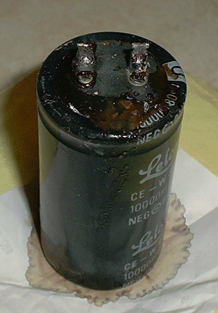

This could be part of the problem!
Look what I found when I removed the cover from the amplifier!:eek:
Needless to say, the failed cap and it's conductive ejaculate all over the regulator and amplifier pcbs was having an adverse effect on the sound.
That's one failure out of twelve for those capacitors, so far, if another one fails I will replace them all. :whazzat:
Anyways, I replaced the capacitor and cleaned up the inside of the amplifier, and then I ran some tests. Using the speakers themselves as a load, I was able to check the output of the amplifier with both sine and square waves (unfortunately I don't have the equipment for tone burst testing). There was no significant distortion, ringing, or noise that I could see at any frequency from 10Hz to about 40kHz, where the corners of the square waves began to round off. This was the same anywhere from no signal to close to clipping. The amplifier seems to be quite stable from what I can tell.
As for the sound, some recordings are just fine, but others still seem to have an unpleasant hard edge to them that really comes out at higher levels. For the most part the speakers are sounding better than they ever have, so maybe part of the problem is that I'm hearing just how bad some recordings really are. Still, I certainly would like the overall sound to be a bit smoother, so I'll continue to work on this. I'll post again when I've had more time to investigate what is happening here. Thanks everyone for all of your help!
