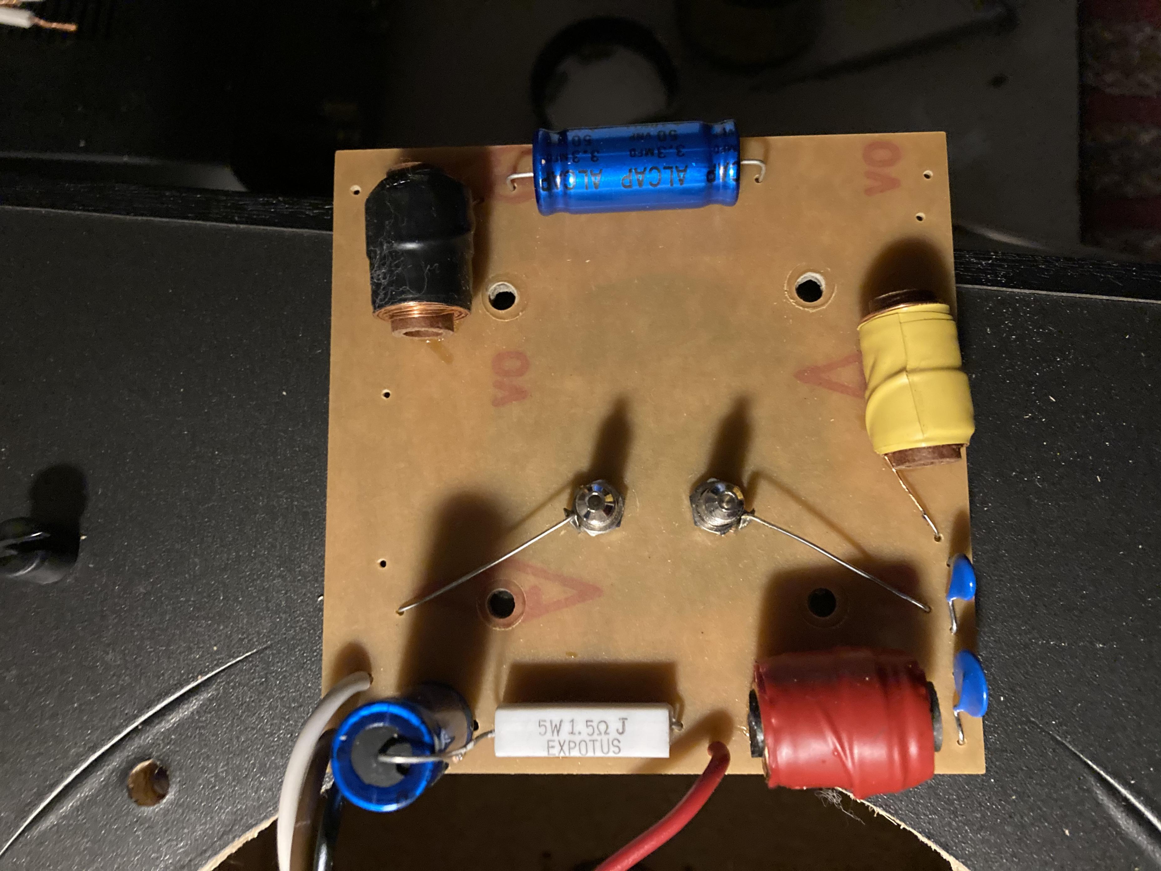

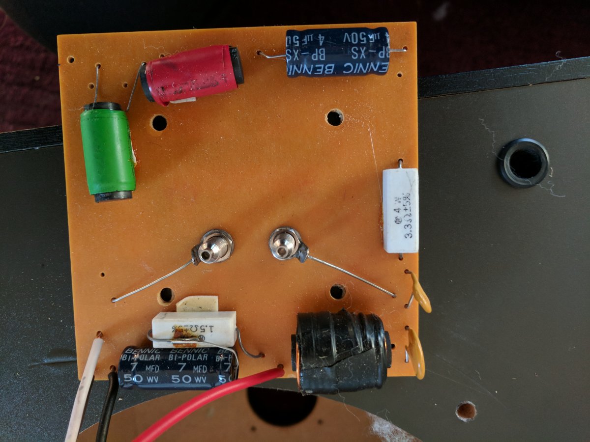

Ok. Let's see if I was able to post a photo. It's of the MS25Ti crossover from one of my pair. It looks a bit different than the one you posted, Galu. So, I need to figure out which are the electrolytic capacitors, to replace, and which are part of the overload protection circuit, to bypass. It seems the two blue ones are the caps to replace, unless they're part of the protection circuit.
The large blue cylinders are the non-polar (bipolar) electrolytic capacitors.
The small blue discs are the Positec protection devices.
Apart from the above, there are three inductors (coils) and one resistor, which you may leave untouched.
The 25s have always been a bit bright in some of the highs...

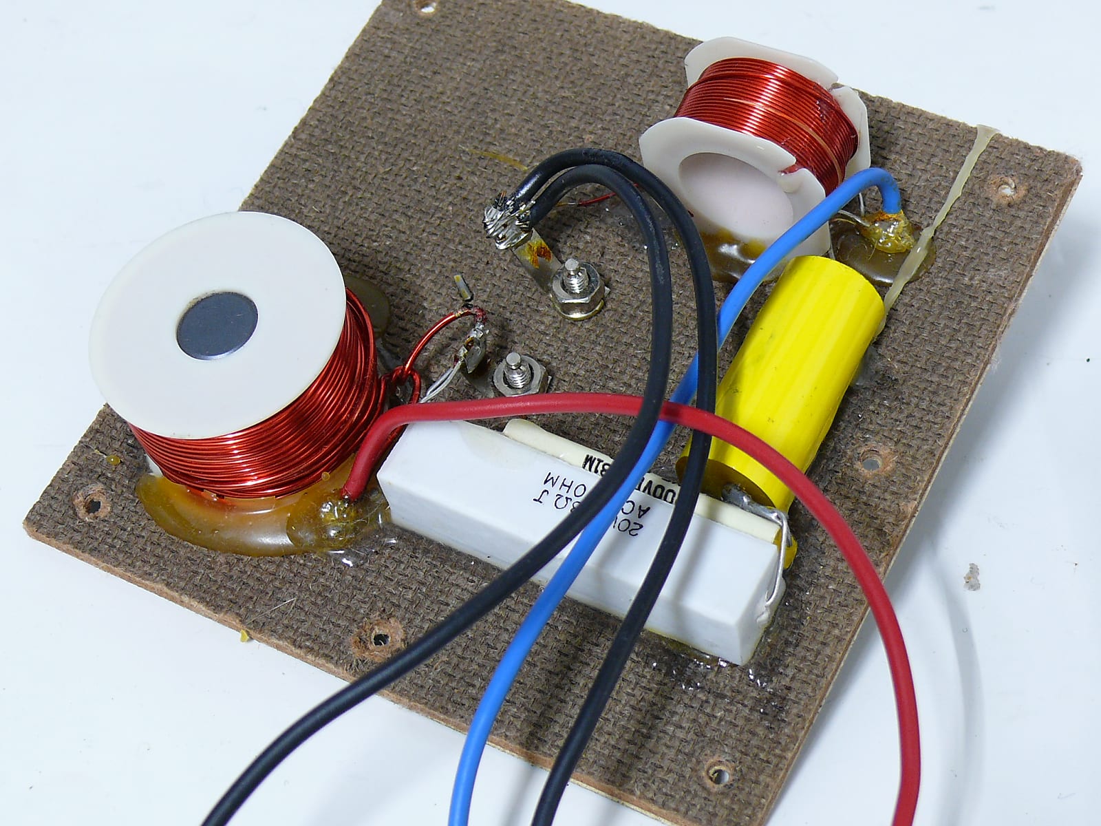

I've put the two crossover versions side by side for comparison.
The main difference in Version 2 compared to your crossover (Version 1) appears to be the inclusion of a 3.3 ohm resistor in series with the tweeter capacitor.
Adding a small value resistor in series with your tweeter capacitor (the 3.3uF) will change the response of the tweeter, and that's something worth experimenting with when replacing the capacitors.

Galu, thanks. Very good information for me as I'm starting. Yeah, I could try to add a resistor.

The MS25Ti has a simple crossover which makes it an ideal basis for experimentation.
You may like to try the effect of replacing the bipolar electrolytics with MKP polypropylene film capacitors. This may help brighten up your muddy midrange sound.

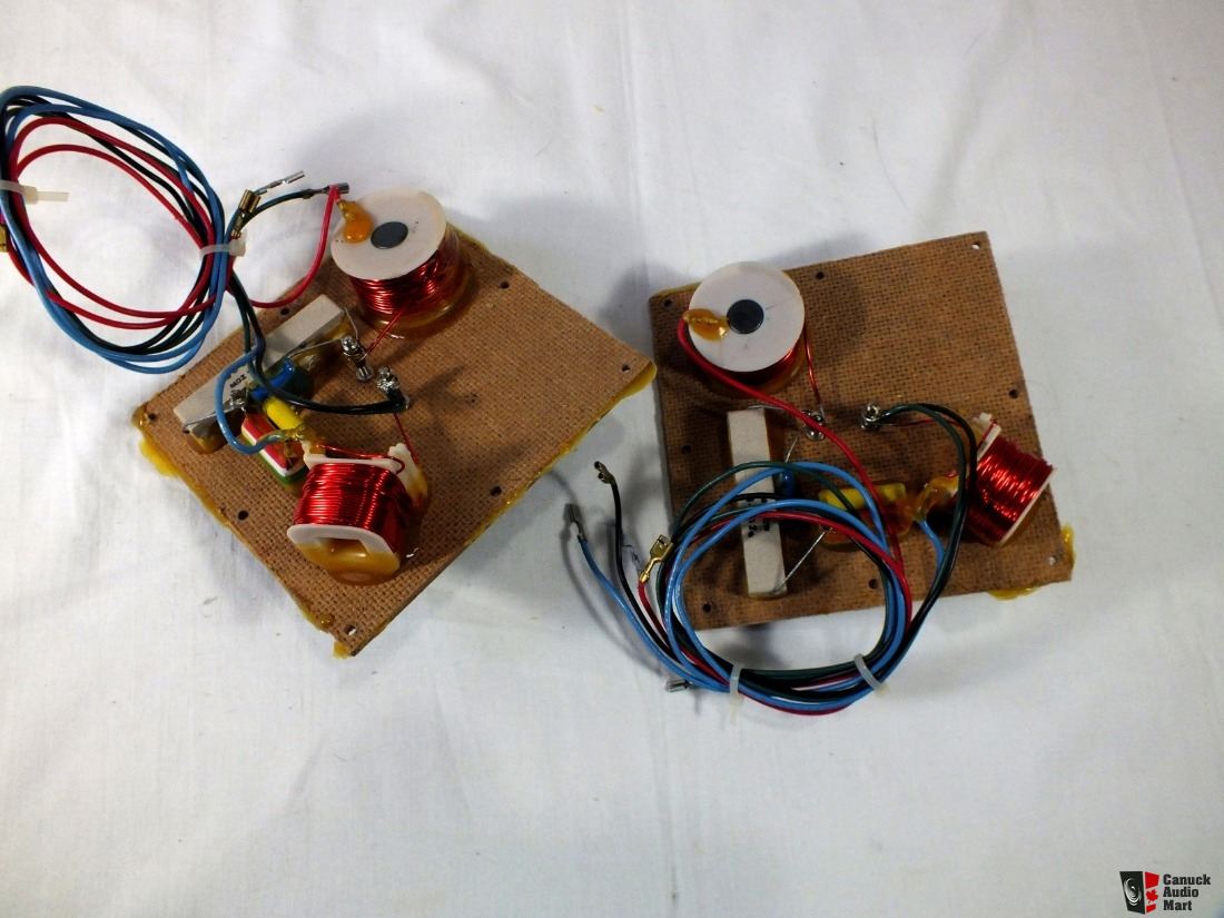

The Paradigm 7se crossover is also simple. Post a photo of yours to see how it compares with the ones I have attached.

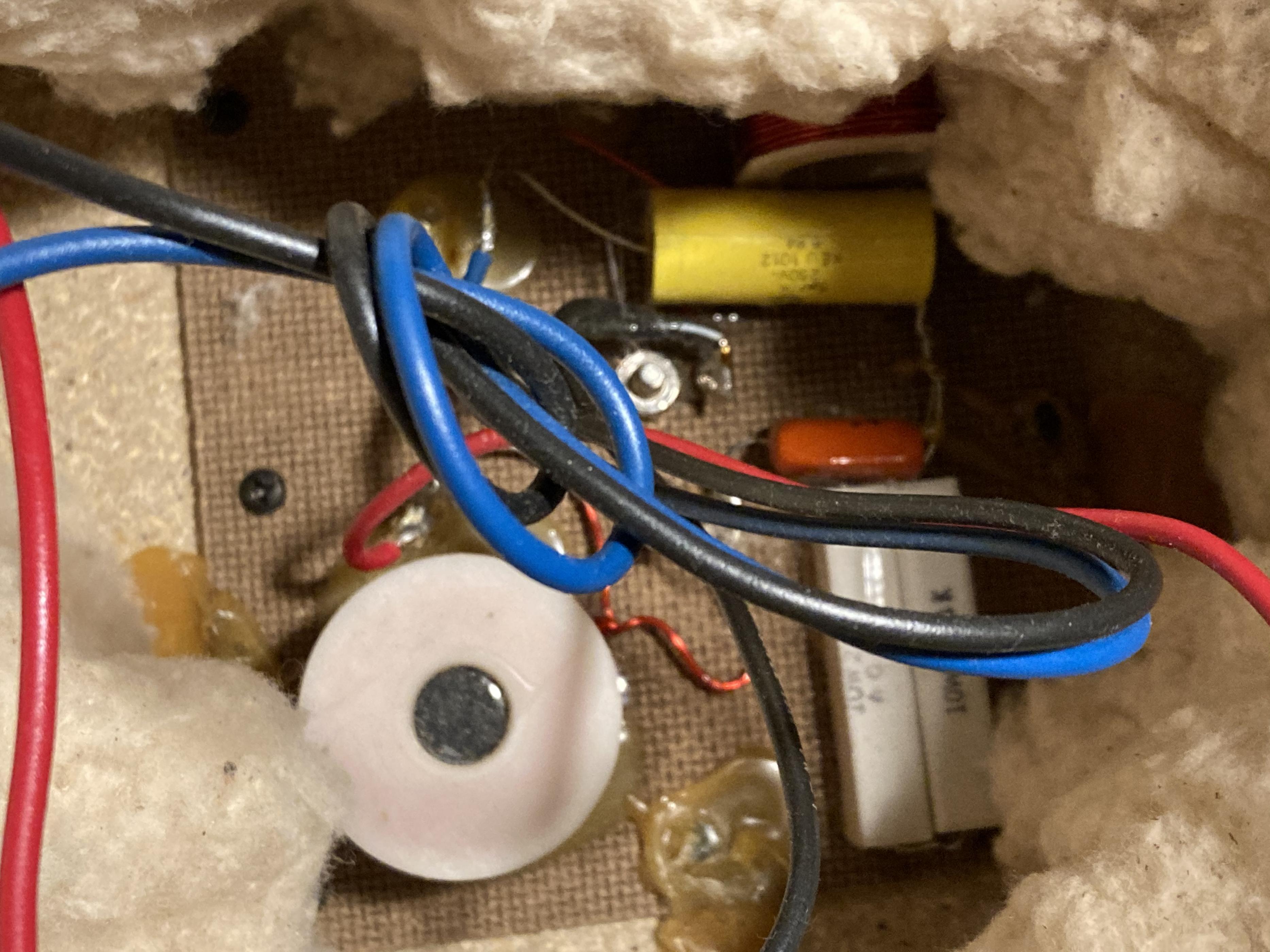

Galu, right on it, as ever. I had a photo of my 7se crossover to post, here it is.
I was going to ask, I've identified the big yellow film one, and there's the chiclet gum piece down there, and the resistors. But no electrolytics that I'm obliged to replace? I don't want to pull it unless I have to, it's glued and screwed, somewhat less elegantly than the Mordaunt circuit board and gasket.

The small 'chiclet' is a a film capacitor, so there are no electrolytics in your 7se crossover needing to be changed. Film capacitors do not deteriorate with age, so I would leave well enough alone.
In the case of your 25Ti, you have a choice of replacing the electrolytics with new, high quality ones or with MKP ones. The latter are likely to make the most sonic difference, but only you will be able to judge if it is a difference that you like.
By replacing the caps in one speaker and comparing it with its untouched companion, you can monitor the result of your renovation. Capacitors are not expensive, so you may want to experiment with both types. As I say, the crossover is so simple that experimentation is the order of the day, so have fun!

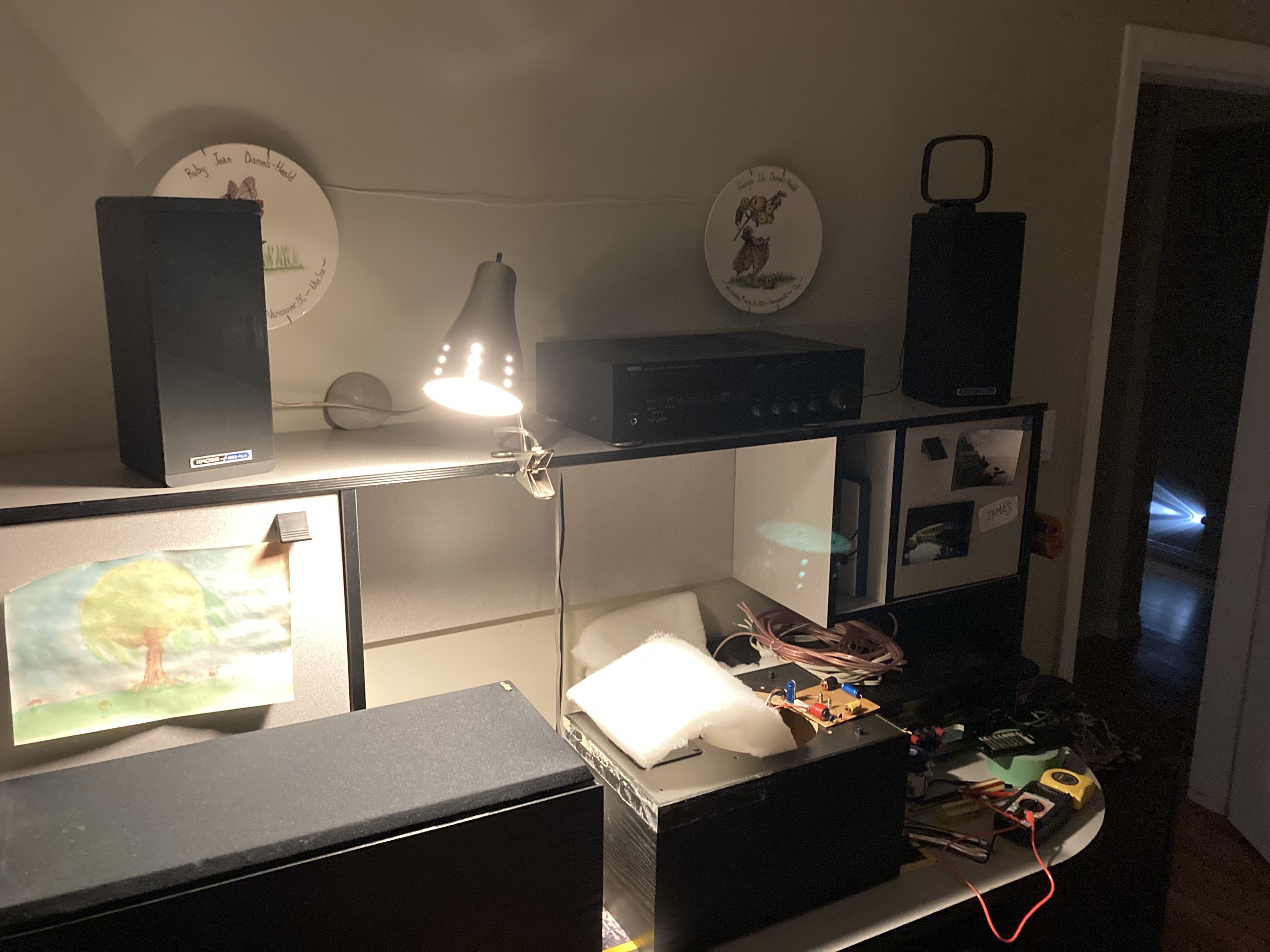

Here are the MS10s doing passable duty while the larger units are on the bench.

Ok, from the two photos, the MS25Ti crossover, tweeter section. The coil and capacitor are reversed, I assume that makes no difference. Your capacitor is 4uF to my 3.3uF, my store has an electrolytic in the 3.3 value, I'm thinking of going with that. My store also has a 5w resistor at 3.3ohm, as in your photo, I'll try that in mine, too. Does that sound good?

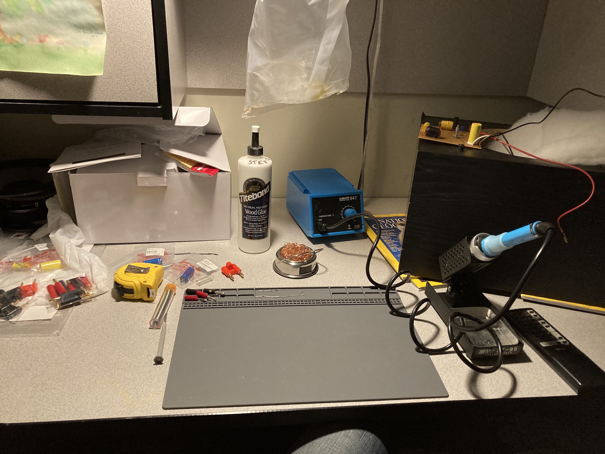

The other photos. It's my new audio work station. Those Koss M85 Plusses would have been joined to my main system if not for the sweet MS10s. Once the dust has settled, the work station is where the 10s may live. The MS25 on the bench is the one that always got knocked, it's why I opened it first. I'm gonna tidy it right up, clean that duct tape residue, glue the grill frame together, maybe cut a new one.
You can see peripherally some half-broken plastic on the Paradigms: the grill badge, and one of the binding posts on the other. But for a couple small scrapes, they're in great shape. A very good freebie set for just gluing on a dome.

Does your store have a 3.3uF film capacitor? That would be preferable in order to match the quite acceptable 6.8uF film capacitor. If not, make sure the electrolytic one is a bipolar (non-polar) version suitable for loudspeaker crossovers. Voltage is not a problem except that the higher voltage film capacitors are physically larger, and hence more difficult to fit on an existing crossover board.
Regarding the tweeter resistor, buy the 3.3 ohm 5W, but also buy a smaller value (or two), if possible, so you can experiment to find the most suitable value for your purposes.
There's no need to bypass the Positecs if they are reading a resistance of under 1.0 ohm (remember to subtract the resistance of your multimeter leads). Any higher than 1.0 ohm and they need replaced (problematical) or bypassed (easy).

Disregard my photo (Version 2) of the MS crossover (I suspect it actually comes from a 35Ti).
On further consideration of the component layout, I now suggest NOT adding a resistor in series with the tweeter.
Let's see how you go with the capacitor upgrades first.
P.S. Mordaunt Short claimed that the resistance of the Positecs was taken into account when designing the crossover network. So, maybe bypass them only if they've gone high resistance.
The resistance of the smaller Positec is in series with the tweeter filter by the way, but I can't predict the audible effect of adding more resistance at this position.
Yes, my store has the 3.3uF film cap, also at 160v. I was shying away from it because of the higher voltage rating, and it's more than 3 times the price of the electrolytics. But if I forego the electrolytics, I will avoid having the other 3 caps from the package floating around my work area, which is good. So the 3.3 film cap is a go.
Ok, editing. I just read your comment about the duelling crossovers. Ah ha! Resistance is futile. No resistors this time.
Thanks also for the tip on ohmeter leads. I may bypass bypassing the positec. I'm reading maybe .5ohms across there.
Yes, I'll do one speaker first and compare to the original. And, again, I have those sweet MS10 as a sort of reference. It was those little buggers that got me on this train in the first place.
Yes, I've noticed that the small Positec lives on the tweeter side of power. That's where our larger resistor lives in the 35 crossover. Cool
