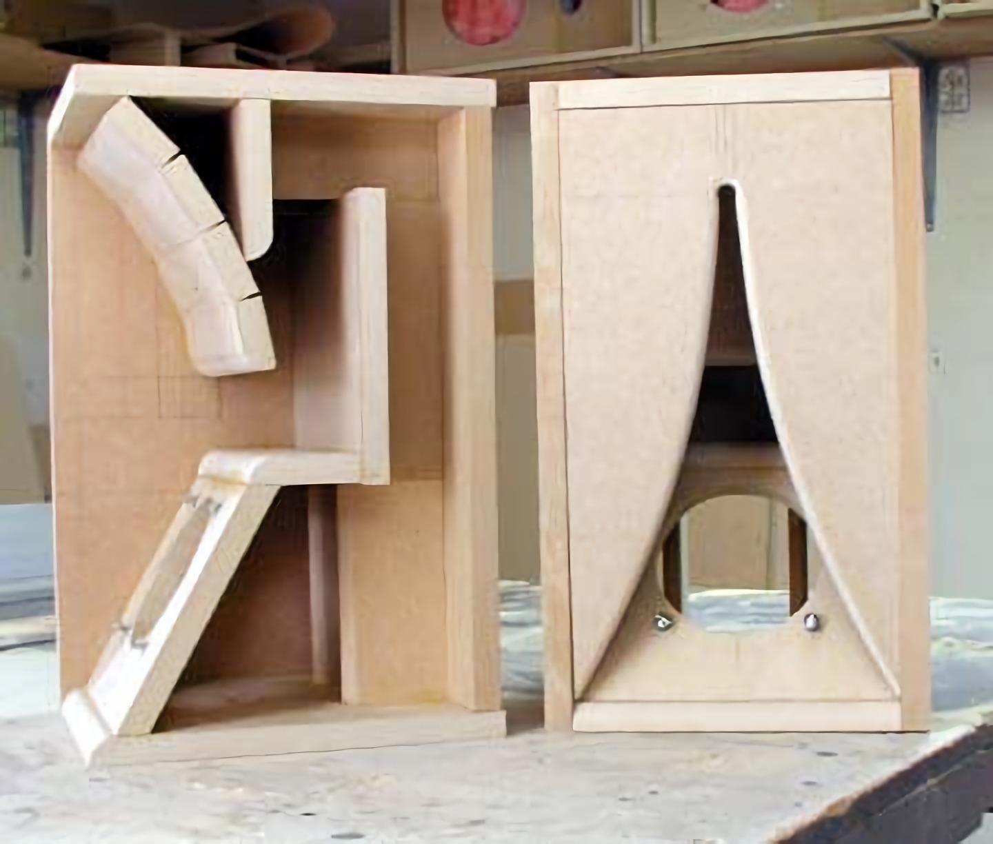

At a later point, Moray "raised" the wings so their lower intercept was with the top of the speaker. Myself, being a stubborn/strict Karlson interpreter, would experiment with aperture flare, top gap, and probably XRK971's suggestion of Melamine sponge pads.

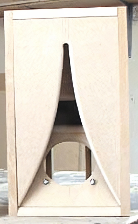

The cabinet's picture taken from the front may be one of Moray's other designs as its aspect appears taller than the one featured in the plans. I'm sure he'll clarify.

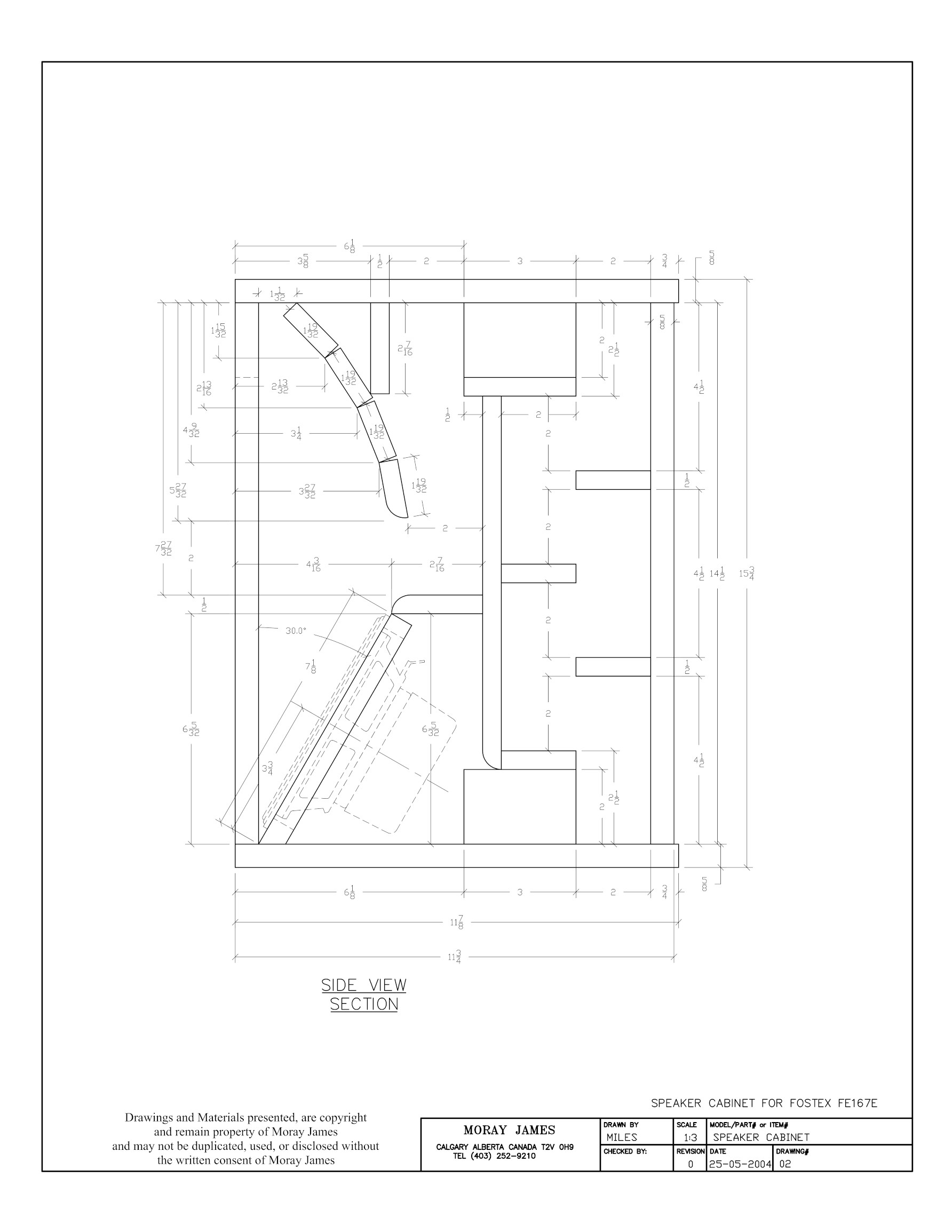

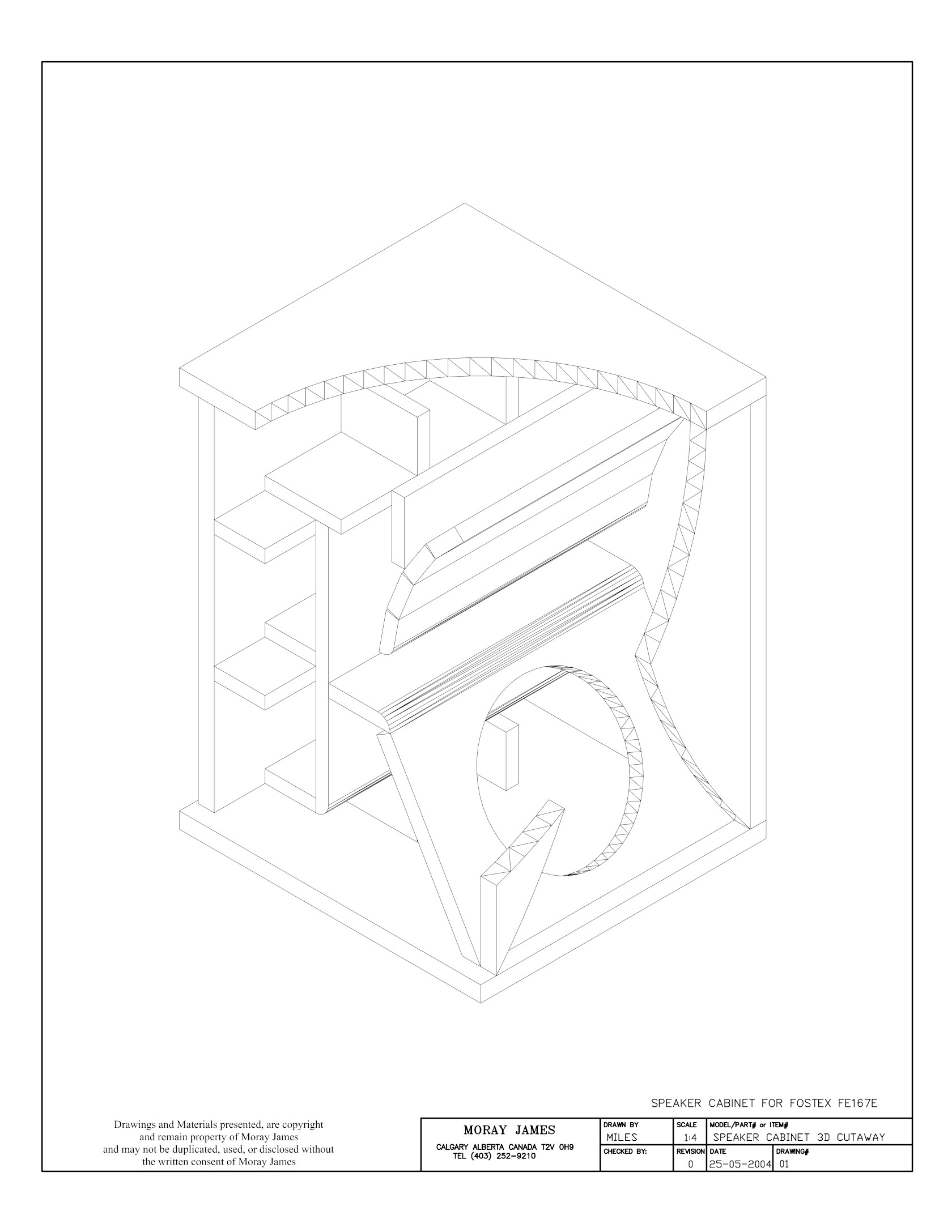

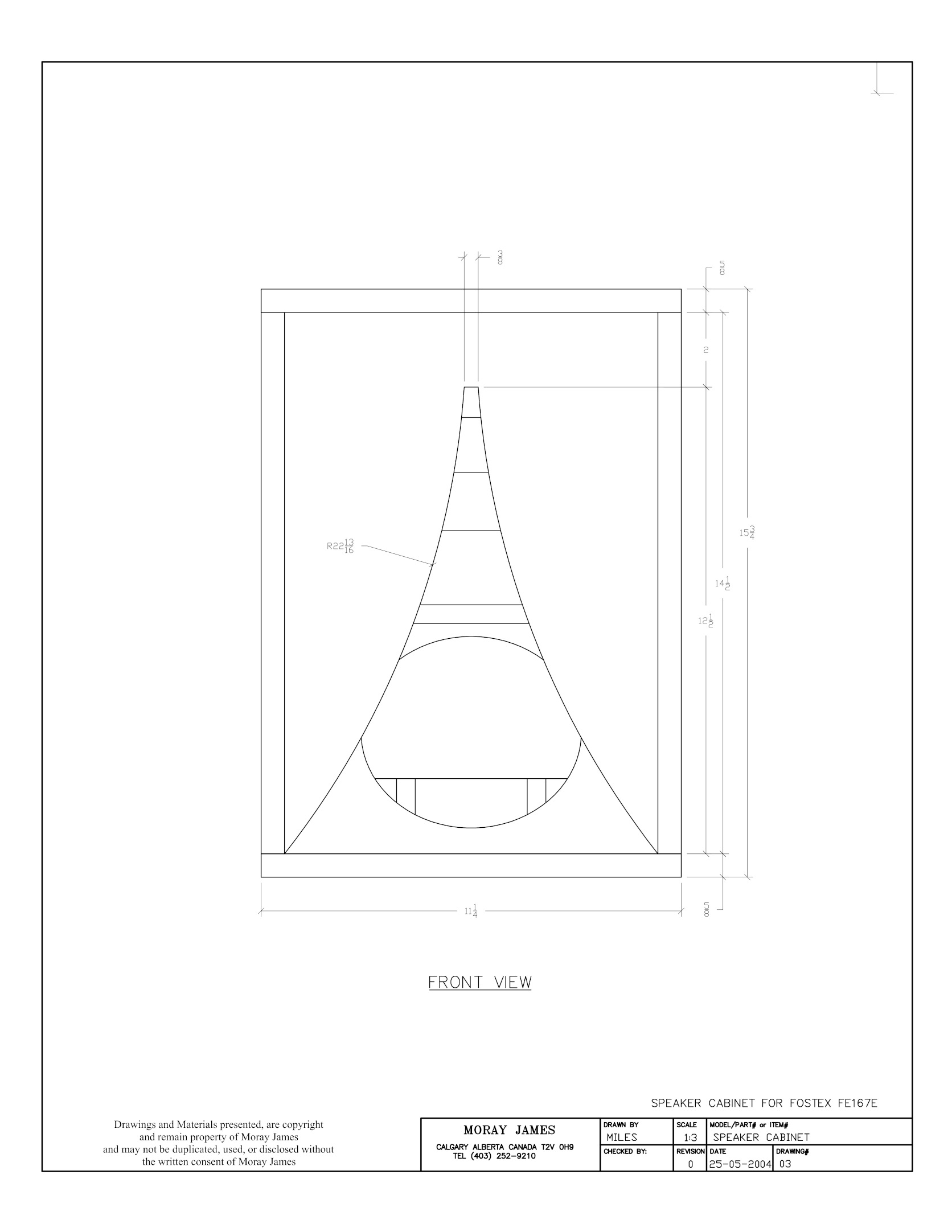

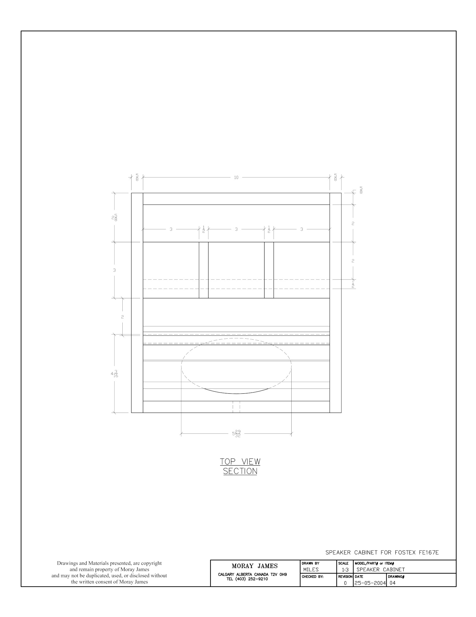

With Moray's kind permission, I present details for that design

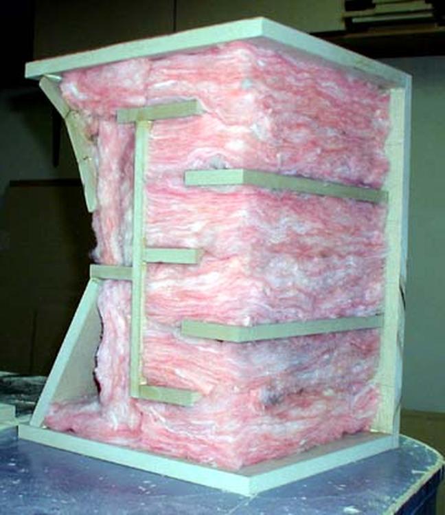

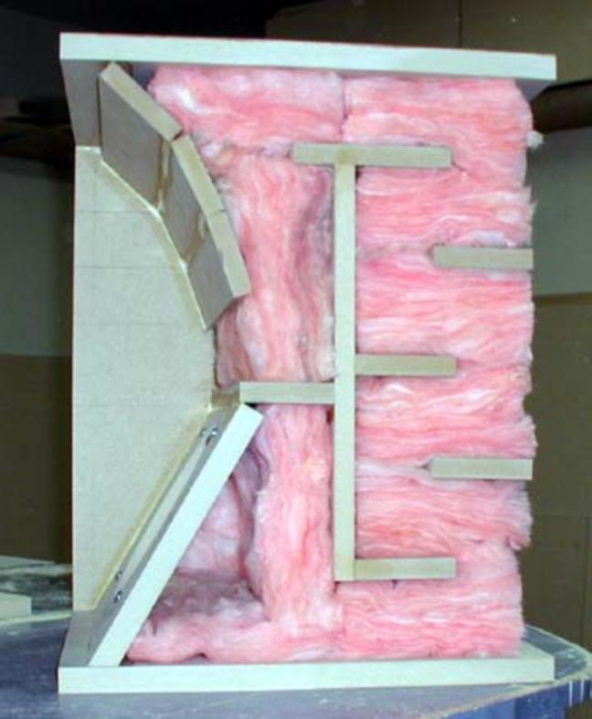

Neat - maybe reduce the fiberglass by a lot as that will be aperiodic when that densely packed. I would line half the walls with thin melamine pads. Use fiberglass only behind the driver.
yes I did take out most of the stuffing and I shortened the length of the tapers so they terminated to the cabinet side walls just at the top of the woofer (this eliminates the cavity resonances of the original Karlson design) and I ran the cabinets on their sides with the woofers facing to the side walls of the room with the centre line of the tapers at my seated ear level woofers on axis to about my shoulders.
There are two designs here both were built at about the same time, the version shown with all the fiberglass was the one I took to Denver in 04. It is easy to see how with just two small changes it can be turned into a Karlsonator. I was building a number of versions at the time when life managed to get in the way of R&D and I went on a another path for a time but I still want to come back. This time with the Tannoy Revolution XT DC drivers.
I should have added that I think the very best way to line the 1/4 wave line is to line just one wall start behind the woofer and keep the lining on the same side to the length of the line start to finish. I also agree that melamine foam is outstanding material butt it does cost a lot. I concur re damping at the rear of the driver and in a Karlsonator could also be placed in the stub above the woofer, this all has to be played with to see what works best.

I'm curious as to the effects subjective and measured of a curved upper reflector vs canted or fully perpendicular panel above the baffle in K designs, and how to determine an effective one without trial and error.

More of Moray's K-T-line speakers - One made for FE126E
just a beautiful size. about 6" w x 9" -10" t x 5.5" d, 5/8" MDF. - perhaps someone here good at drafting can reconstruct a working drawing. Maybe Moray will make some comments upon its range and proper damping procedure.
