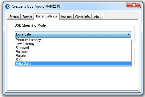

Hi Weissi,
I have the same module with the USB connector soldered directly on the board and had similar distortion issues when using crappy USB cables. If you still have this issue you can try to increase the buffer size. Crescent custom driver for Win7 support this.
Please note that XMOS is a high-speed USB device compared to PCM270X for example which is only full-speed. High speed USB devices routing is much more critical. I guess you have buffer underflow/overflow due to poor USB routing.
