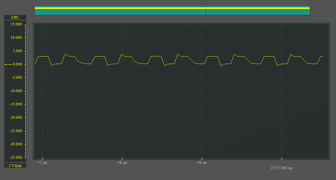

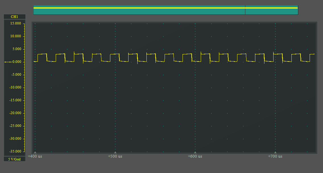

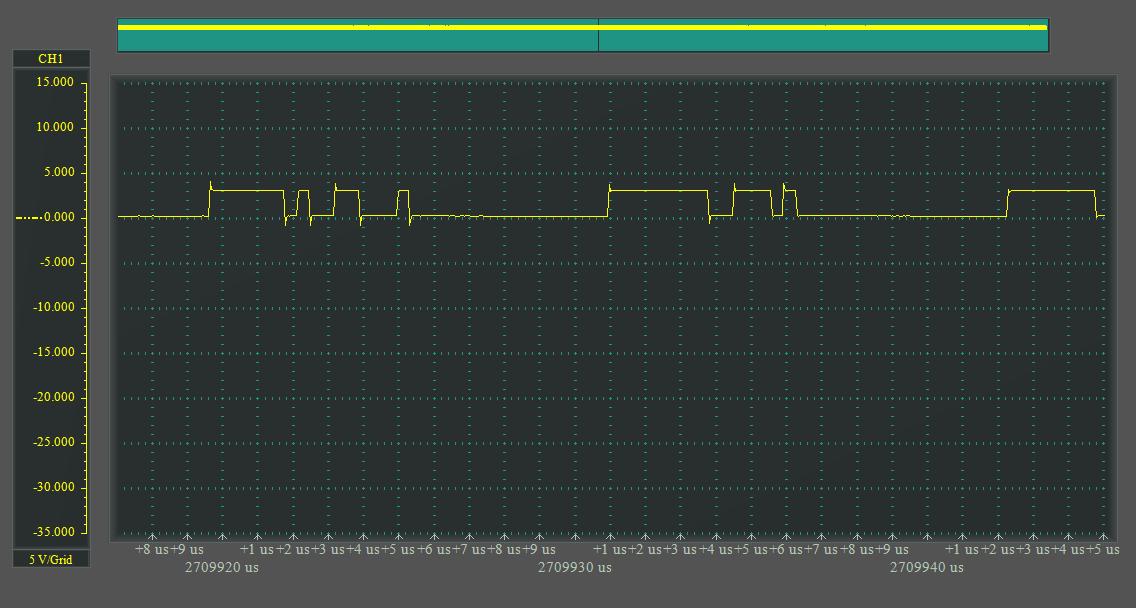

Results:
Data is 0V when not playing (my error earlier). Once playing I can see signal. Looks clean
BCK is a square wave signal with some roll on/off. Not the cleanest.
LRCK is a similar square wave but much cleaner than BCK.
So indeed looks like a compatibility issue.

I've tried WIndows 7, 10 and Linux now, same on all.
It looks to me the I2S signal is malformed in some way.

Does your data recorder have two channels? The most likely thing I reckon is the phase of the word select (WS or LR) is wrong with respect to the datastream. This could lead to always loading in zeroes.
