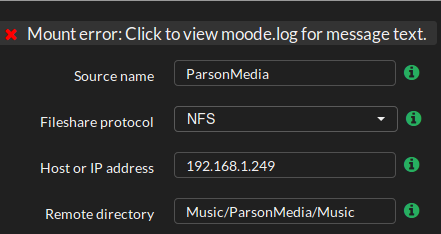

I am using the IP address and not the hostname. But in looking at the logs, it keeps inserting the word NAS in the mount point string and is failing:
20180203 004903 wrk_sourcemount(): Mount error: (mount.nfs: mount point /mnt/NAS/ParsonMedia/Music does not exist).
Not sure why it is adding this, or how to stop it?

Post a screen shot of NAS config or alternatively post the entries in each of the fields.
-Tim
Here is the screen shot and the log entry:
20180203 012906 wrk_sourcemount(): Mount error: (mount.nfs: mount point /mnt/NAS/ParsonMedia does not exist)
Did you make a new NAS config cuz this log entry is different from your earlier post. The first one won't work because of the / (ParsonMedia/Music) which would have come from the Source name entry.
To troubleshoot:
1. Remove the NAS mount.
2. Turn on Debug logging in System config
3. Create the NAS mount
4. Look in /var/log/moode.log for the actual mount string
5. Try that mount manually using the string from the log and see if the error messages provide more insight into whats happening.
Remember to turn off debug logging or moode.log will get HUGE.
I think you are missing the first part of your remote path.
You need to put in the path that you see in your unix share page in freenas, i would expect to see something like this.
/mnt/Data/Music
Where Data is your volume name.
The error message is saying it cannot find your share.

Yes, I did the first one I posted was the exact same configuration that I used with version 3.8 and it worked fine (went back and verified that it still worked on the older version). The last one I posted was one of many config changes I have tried based upon what I see in the log. I will try your suggestions.
