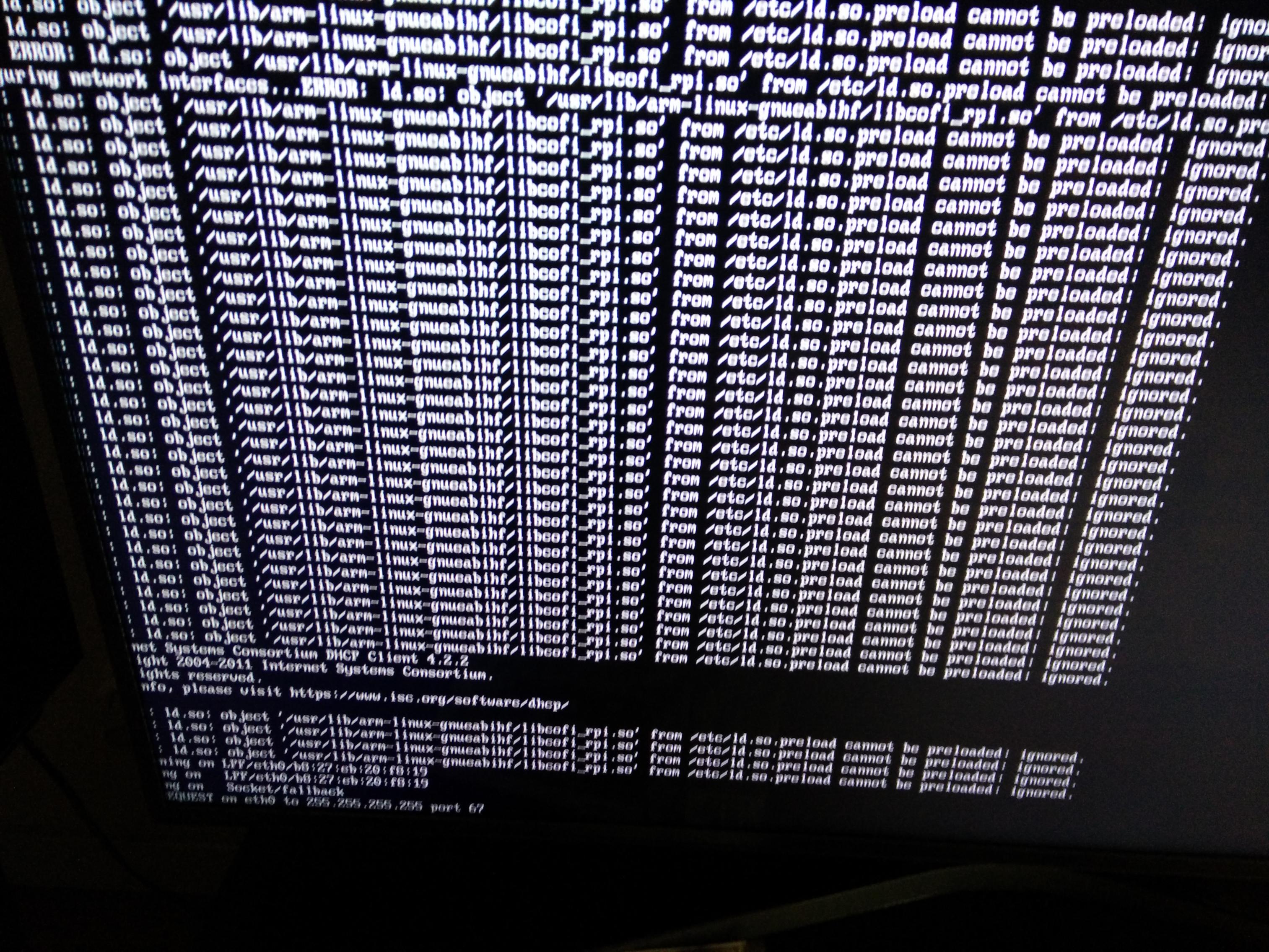

MultiBoot Berryboot with moodeMusic
I would like to have the MoodeMusic on BerryBoot but since it isn't available I had to converted from img to SquashFS format. I did the same steps as described on BerryBoot guide but it doesn't work.
I've a lot of message on loop. Something like
ERROR: ld.so: object '/usr/lib/arm-linux-gnueabihf/libcofi_rpi.so' from /etc/ld.so.preload cannot be preloaded: ignored.
Someone have a functional image of MoodeAudio (or similar) on berryboot?
