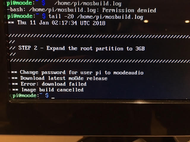

I suspect the build is still incomplete for some reason, perhaps some repositories were not not available during building. I say this because I had similar behaviour from my first build attempt.
Have you checked the build log for errors? As @koda59 has said in another post:
Could you please post the last lines of /home/pi/mosbuild.log?
(tail -20 /home/pi/mosbuild.log)
rhiz,
See attached pic. Clearly the install was not successful. When creating the image file, it gave me an option for wifi or ethernet. I selected wifi. Then it asked me for SSID, and then it asked me to "make connections" to which I responded "Y" first, and IIRC nothing happen, and then when I entered "N" it asked me for a password. Maybe I screwed something up there?
In any case, would you recommend reformatting the card with the current moode install. Restart the image build via Raspbian but make sure I'm connected via ethernet?
rhiz,
Do it via Ethernet, it will be easier with this version of builder 😉

Ouch ! I'm so sad to read that... you can't say that !!! you have made a script who simplify extremely the installation process, it is used by many of us and work well in many case, but yes your first try is not bug free and it's not a problem when you correct it directly like you do for mosbuild. You can't apologise because it's not online now and you can't do anything about that. I'm so sorry to see that !
For the problem of Dkalsi and manniraj i think is because "say yes to all the options" (like suzywong say, but she's right !) activate the proxy and in this case the proxy is not well configured because they don't need proxy...
I recommend to use the moosimbu.sh script to do the installation (bug for localisation and special chars in wifi are corrected)
Round 3 - moosimbu
but before modify the moosimbu.sh script like i say in this post :
you must remove these two lines from the cancelBuild function before launch it the first time (line 48 and 49 of moosimbu.sh)
after that if you have an error you just reboot the pi and the installation restart to the right stepCode:rm -rf mosbuild 2> /dev/null rm -f *.zip 2> /dev/null
and follow the instruction of the first post to install moOde (say no to the proxy !!)
Good luck !

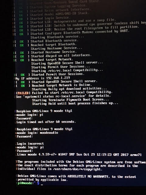

Now after I restart I am getting an error "502 Bad Gateway
nginx/1.10.3" on the browser. What could be the issue has the OS corrupted as I am unable to SSH the Pi, looks like the Beta version is not stable and I need to wait till the month end for the official full release candidate.
Much more likely is that you didn’t complete the build correctly.
The first Beta 4 version I made has been working flawlessly for a couple of months now. The latest (Beta12) that I built last week and have been thrashing, similarly.
Use Koda59s script, start from scratch, use a quality SD card.

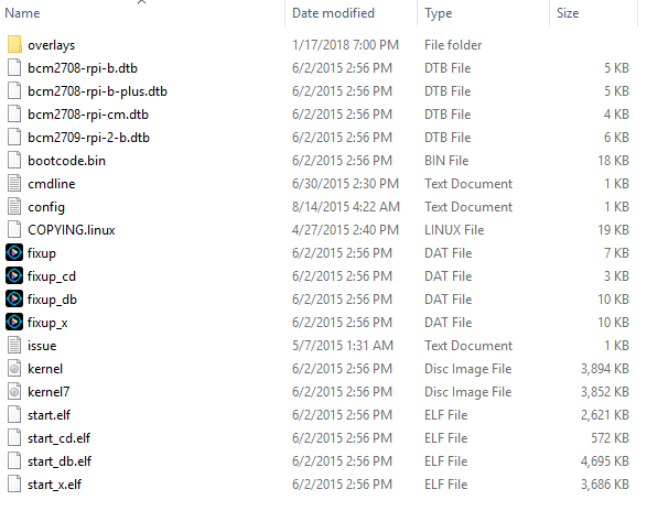

Current Build onto SD Card
I'm out of my league here. I used very old 2015 image and trying to update now. Attached is screen capture of SD contents.
Would you please point me to steps on how to convert current
build into disc image. I am not sure how to to run it from SD card.
I cannot find my old notes. Only recall copying image onto SD card,
running Noobs and Putty to setup.
I hope it is not as bad as it looks 😕

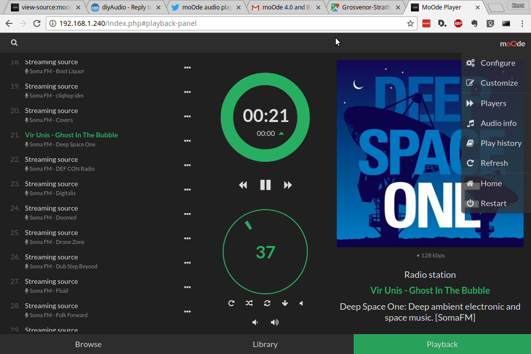

@eala
Here's an example. The first line in the code block below is to be found in header.php (careful, there's a second Refresh line which looks similar). I added the second line just after it
Code:
<li class="context-menu menu-separator"><a href="javascript:location.reload(true); void 0"><i class="icon-repeat sx"></i> Refresh</a></li>
<li><a href="http://somewhere"><i class="icon-home sx"></i> Home</a></li>
I've attached a screenshot of the resulting moOde pull-down menu. Clicking on the "home" entry takes your browser to http://somewhere...

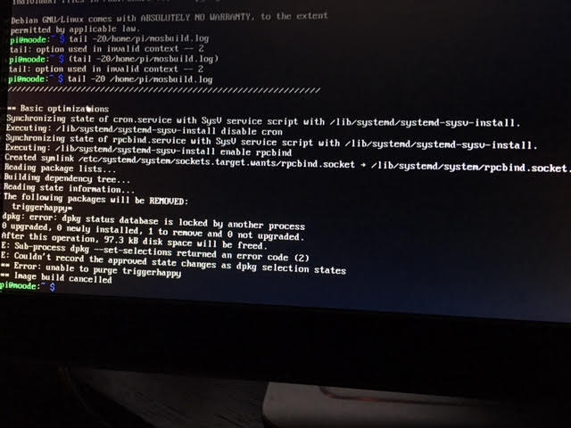

So I tried rebuilding the whole thing. Again no luck.
I've attached an image from the build log. The good thing is that I'm getting a different error than last time 🙂
If you have used the moosimbu.sh script and modified like i said in my previous post, just reboot it and the installation process restart at this step...
For helping this step of the build (and all the build process, i don't know exactly why but i had 100% success with this trick) you can test to launch these 2 commands before launch the installation process (only with the one SD Card method) :
Code:
sudo apt-get update
sudo apt-get -y upgrade
Good luck
