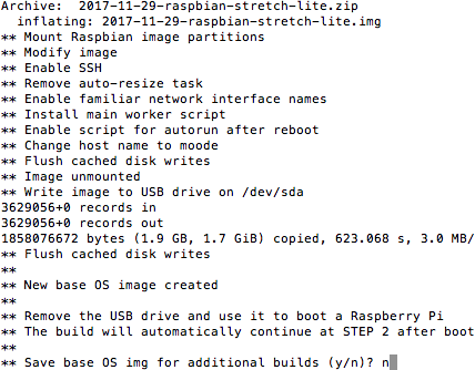

you enter this after you've swaped the cards, started the Pi and logged in through ssh again (remember pwd has changed to moodeaudio in that step)
Tried again. Screenshot of Phase 1 completion. Seems ok to that point but when I power down the Rpi3 and try to ssh to the sdcard with MoOde build get message ssh: connect to host 10.0.0.31 port 22: Operation timed out.
Maybe I should start over or maybe try build with Ethernet.
Sorry to ask this but after powering off, did you remove the old SD Card from RPI slot and insert in it the new one, you just wrote ?
If yes, it looks like your network is not working after the boot ... so maybe something strange with wpa_supplicant 😕

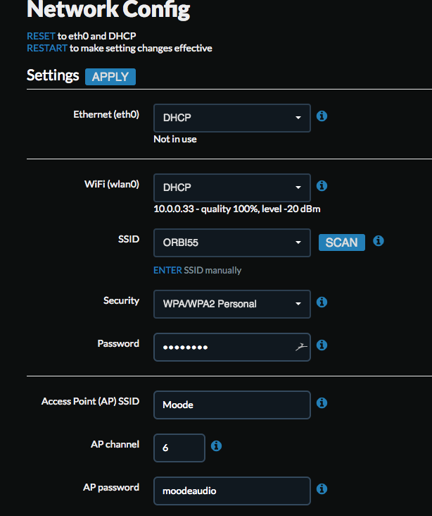

Have you an SSID or password with space in it ?
Why the protocol used ? WPA ? WPA2 ? WEP or other ?
Maybe the country flag but this as rarely an effect on the connection.
If you have an SSID with space, can you test my script (i've corrected this problem in it)?

Here is a screenshot from the network config. Shows my SSID =Orbi55. When I tried the wifi install this is what I used. Maybe there is something with my particular wifi network.
Hell I am just glad guys like you are around as this is much more than a non techy can figure out... I do thanks you and Koda59.
