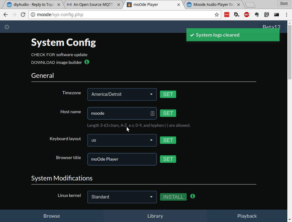

Hi @TimCurtis
`Clear system logs`, `Clear playback history` and `Compact Sqlite database` switches do not work (no change on the UI, maybe they work on the background though)
@zgtc
No change? Yes, these commands work in the background, but when executing each one, you should have seen a window refresh and a temporary green notification box pop up in the upper-right hand corner of the windows. See the screen capture I've attached.

What I mean by "no change" is no matter what I try to set (on or off) the switches will remain as off. Always. I don't know if in the background the changes are triggered, but the UI is not updated.
