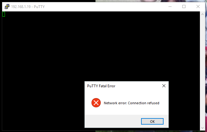

Connection refused
Hi:
1 -downloaded raspbian lite from raspberry pi. and ensured its running on my rpi3
2 - connected rpi running raspbian through lan to my router and started.
3 - error to connected to rpi using putty (ssh)
I reinserted the old Moode 8.3 and Putty connected, help would be very welcome.
I am connected via gigabit lan ethernet with Modem.
Thanks to anyone who solves the problem.

Just create an empty ssh file on /boot to enable SSH 😉
Raspbian image have SSH disabled by default
