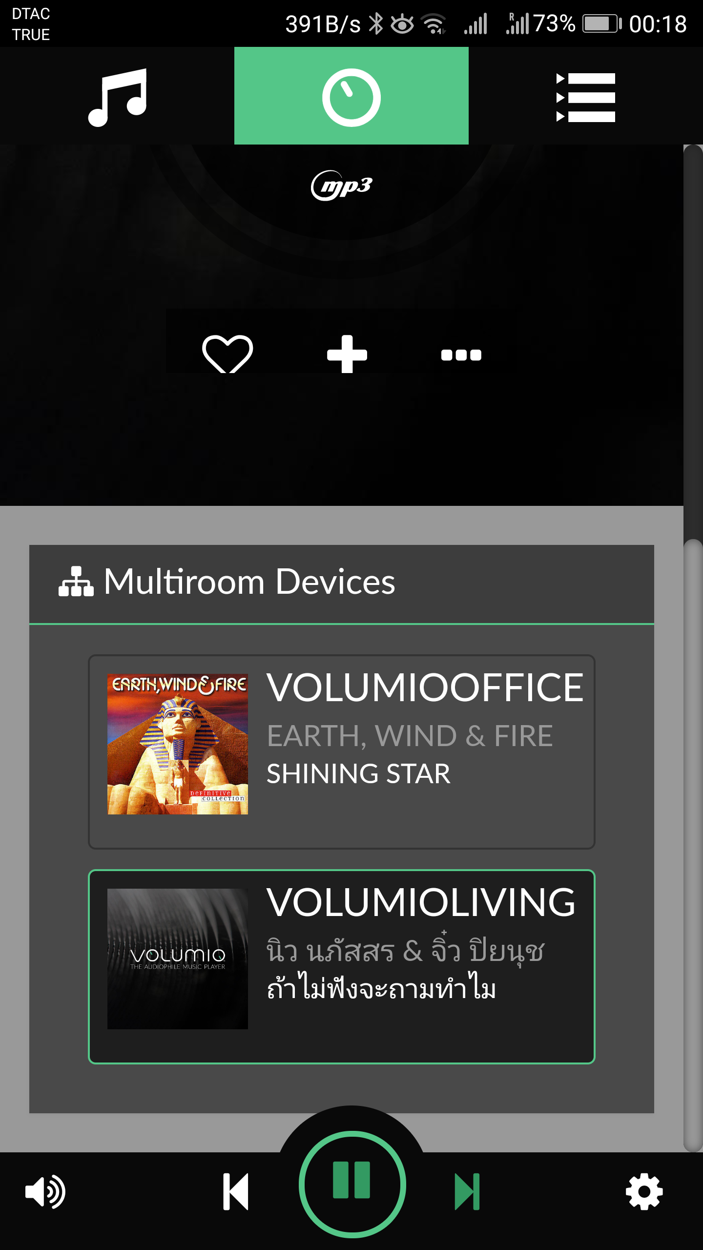

Pretty easy to implement using avahi (mDNS) but whats the usage scenario for this feature?
Typically multiple players would be open in Browser tabs, or is it just more convenient to be able to switch to different player from within the player itself?
-Tim
On android I saved the url to one player on my home screen. From there I can then control all volumio devices. You don't have to type - or remember - URLs, no need to add multiple tabs; It just works. I find it a very welcome addition.

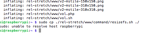

Using Build Recipe v1.9, 2017-11-15. At Step 2 trying to expand root partition.
This error message is returned sudo: unable to resolve host raspberrypi
I am on a MAC with Rpi3 connected via ethernet cause my network can't see the Rpi.
See screen shot attached.
Thanks for any suggestions.

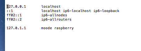

sudo nano /etc/hosts
And add raspberry after moode on the line which contains moode and don’t forget the Space between the two hostnames.
Save and you can resume the recipe
You will be able to delete this add after next reboot if you wish

Thanks I made the change you suggested. Looks like it worked so I am able to move ahead. See screen shot. Cheers

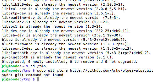

At Step 4.2 getting error sudo: git: command not found
Can I ignore this and move forward? Or must this be resolved before going to next step.

where does the cd ~ come from?
isn't this what you should be applying:

Please note that I am not running this install as 8 worked fine for me and I have simply updated to Beta 9. Good Luck, you will get there through perseverance or help from the forum.

Ok - see there error.
Have started again with Step 4.2. Same error message. Time to start from scratch it seems. Glad folks on this forum are here with a helping hand.
