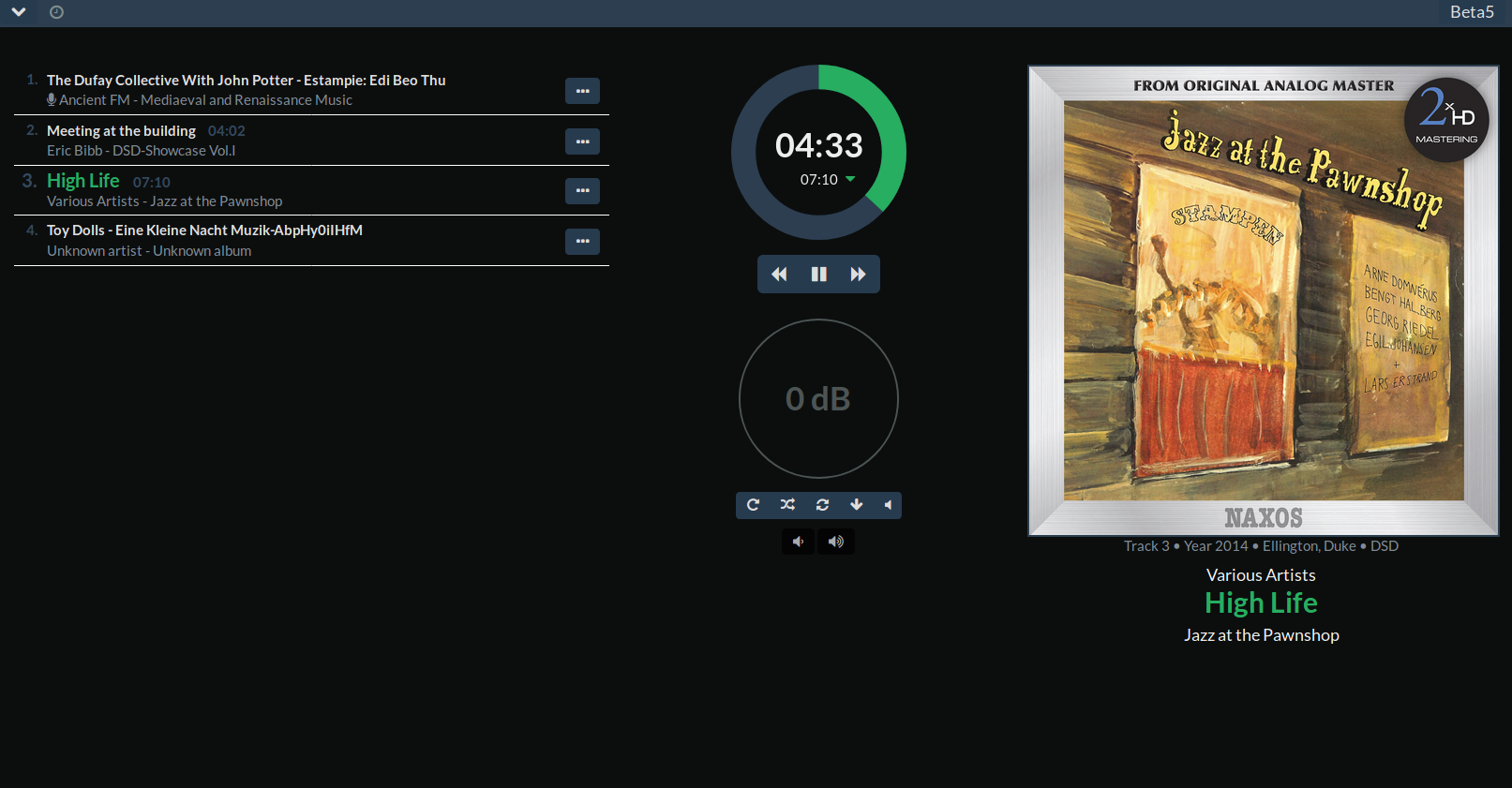

DSD or not DSD that is the question..?
Not particularly interested in Dsd....there isn't much available .
However, I am a little confused about how moode renders it..
I have a dac that will play native dsd 256 and it has both a lock indicator and one for dsd.
In moode mpd settings DoP is set to 'yes' when Native is not available.
If I play a dsd file both the lock and dsd lights come on for the dac.
Moode playback panel shows DSD as the file type being played but the 'audio info' window shows it being decoded at 24/352.8 and output as 32/352.8 ...
If I play pcm and upsample to 32/352.8 the dac lock lights but not the dsd light.
output is via usb to i2s xmos, not direct i2s from the pi.
any enlightenment appreciated
Hmmmm is the dsd light showing because .....
A specific marker code in the top 8 bits identifies the data stream as DoP, rather than PCM.

I'm not sure why the output of moOde is detailed as 32/352.8 but 24/352.8 is what is necessary for DSD128 data to be packed into a PCM stream (this is not to be confused with conversion of DSD to PCM). The following site has more info:
DoP open Standard | DSD-Guide.com
Richard
