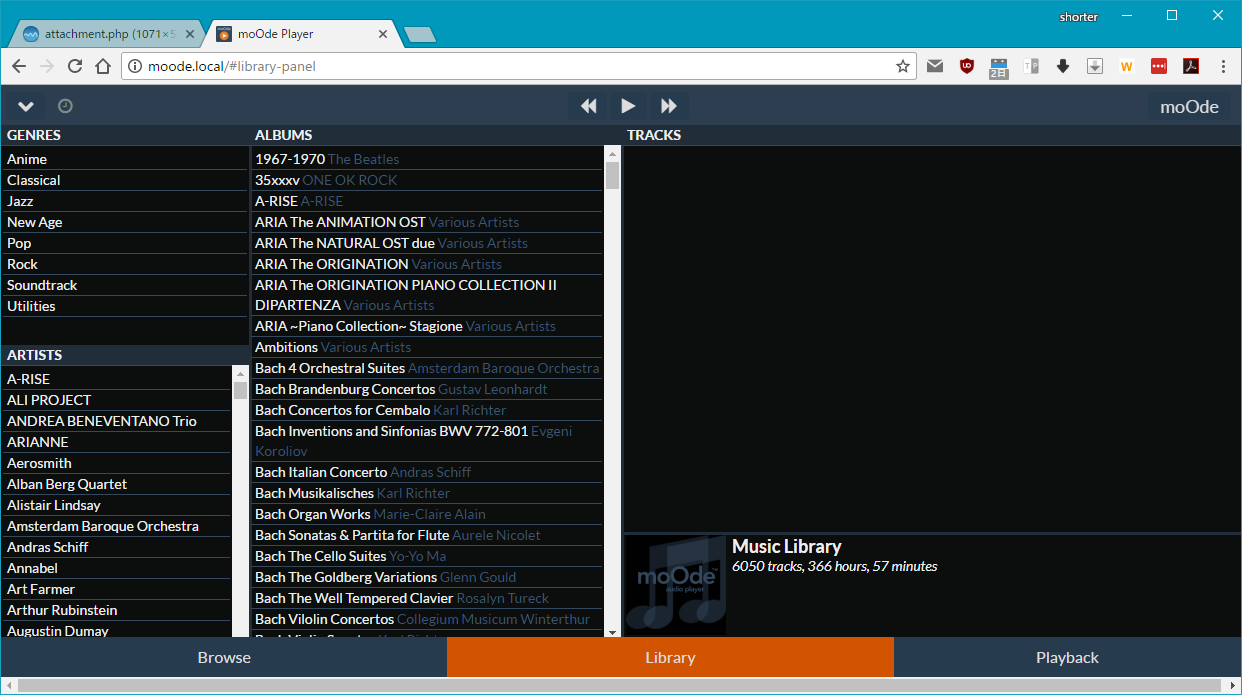

Hi, Tim
A horizontal scrollbar appears in the library view.
It doesn't in the browse and playback view.
Is it intentional?
I think it is useless as there is no sufficient room for the bar to move and it consumes
vertical space.
I checked it on chrome, firefox, IE and Edge browsers on Windows 10 in Japanese environment.
I only test with Safari and it has auto-hiding scrollbars. I never see a horizontal scrollbar.
On Chrome try: chrome://flags and enable overlay scrollbars. Also I think there is a way to save the Browser window as an App similar to "Add to Home Screen" on IOS. This gets rid of the Browser decorations.
