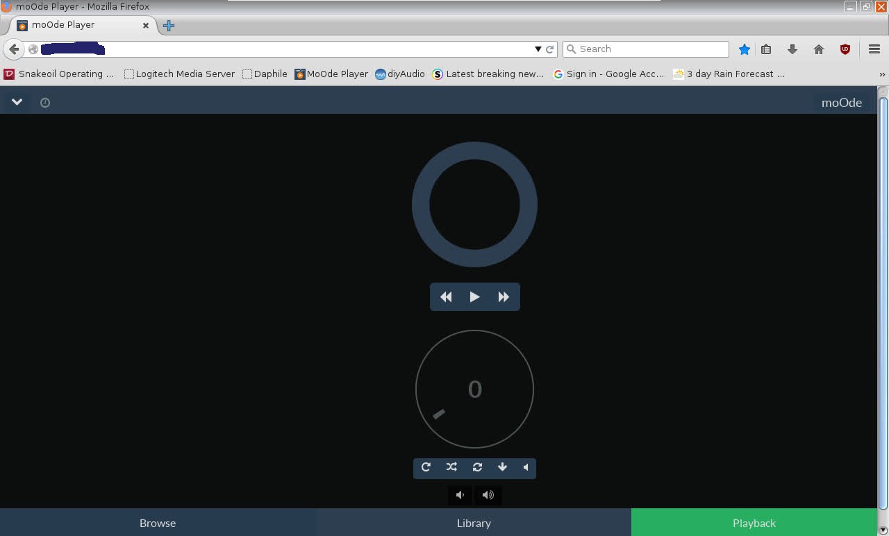

Hi Tim, Autoplay on start seems to be disabled on shutdown-restart.
The UI comes up blank in the playback tab but router activity shows the last playing webradio stream is restarted only there is no output.
If I select the play icon then the tab is populated and audio commences.
Audio also starts if I use the ir remote.
Seems I can reset autoplay by selecting it in the configuration page and it will survive reboots but once Moode is shut down and powered off then a cold start kills autoplay and blanks the playback tab.
Is there a file I can access over ssh to check if the autoplay setting is being cleared at boot ?

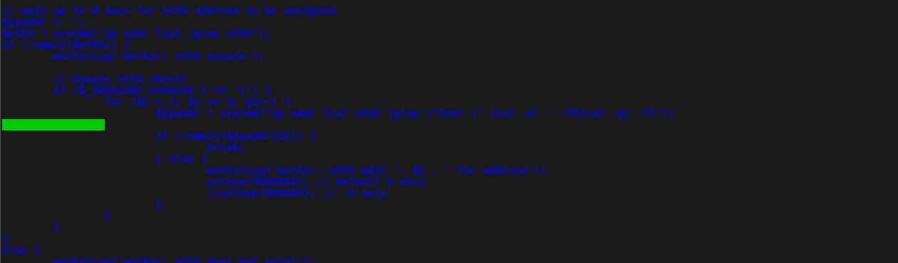

I can confirm that this is only a problem for webradio streams. Local files autostart fine. So it seems this is network related and as I recall I had a problem once before like this but on a PiB....
It was the os not waiting long enough for the eth0 check and was resolved by increasing the wait time.
I looked in worker.php for the line to change and think I've found it but it is different from the last instance... just checking then which value/s to increase...
(using Pi3, tried RR and LL and Std kernels, same for all. Running from usb not sd... so usb speed could be the bottleneck ? or maybe it's my network...)
