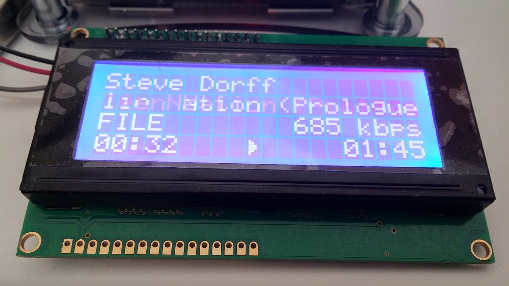

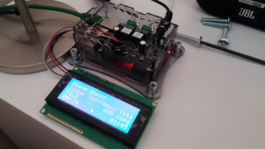

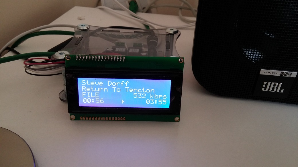

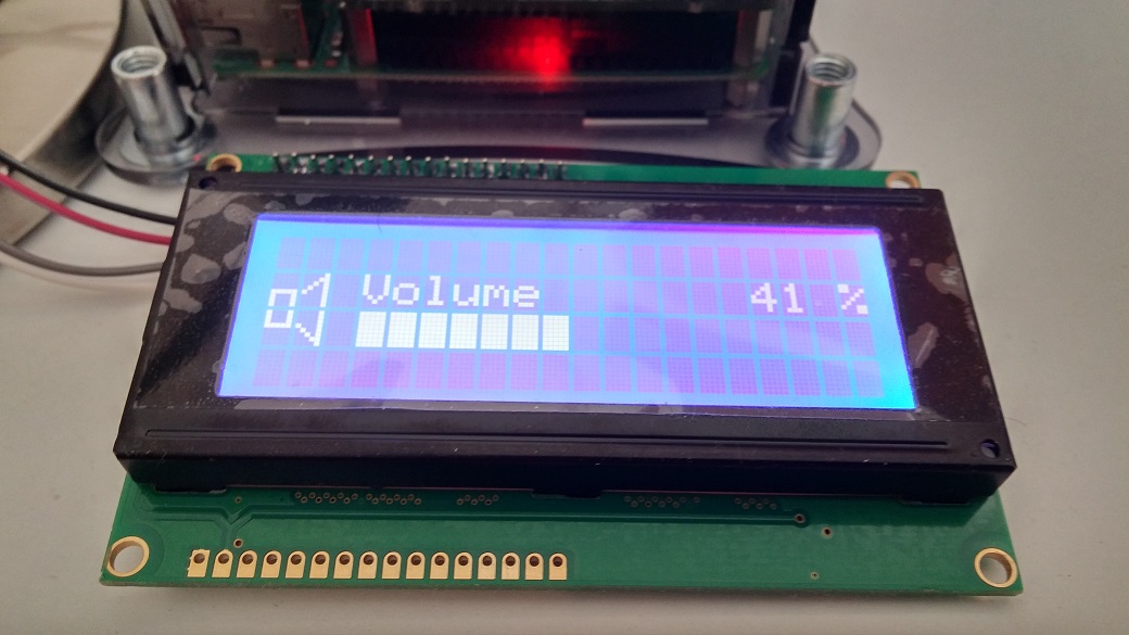

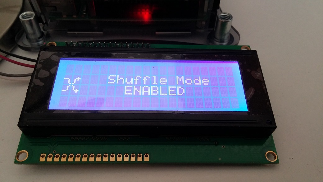

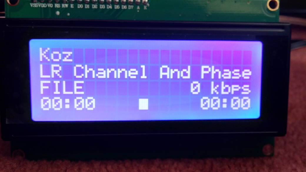

I have been playing with my LCD displays again, still alas using some code written for another product (don't tell them).
The display I thought was defective is indeed okay and it seems when powered up coming up with two of the four rows on solid is not unusual.
Thus I have moved my first display on to my real Moode unit (my test one has no audio devices in use).
It seems to works other than the back-light stays on all the time (it does support being turned off).
I have also ordered an IR receiver and remote plus some buttons to see if the other features work.
I have attached with luck some more pictures and a rough list of commands to install the code.
I also am expecting a 2 line OLED display to play with.
@IM35461
Looks like you have things well in hand (and thanks for the pix).
I know OLED displays are supposed to be brighter and have higher contrast ratios compared to LCD, but I personally would want the larger 20x4 format. It'll be interesting to see if you can squeeze enough info into a 16x2 format (maybe alternate between screen fills, like my car radio does, or perhaps use scrolling lines?).
