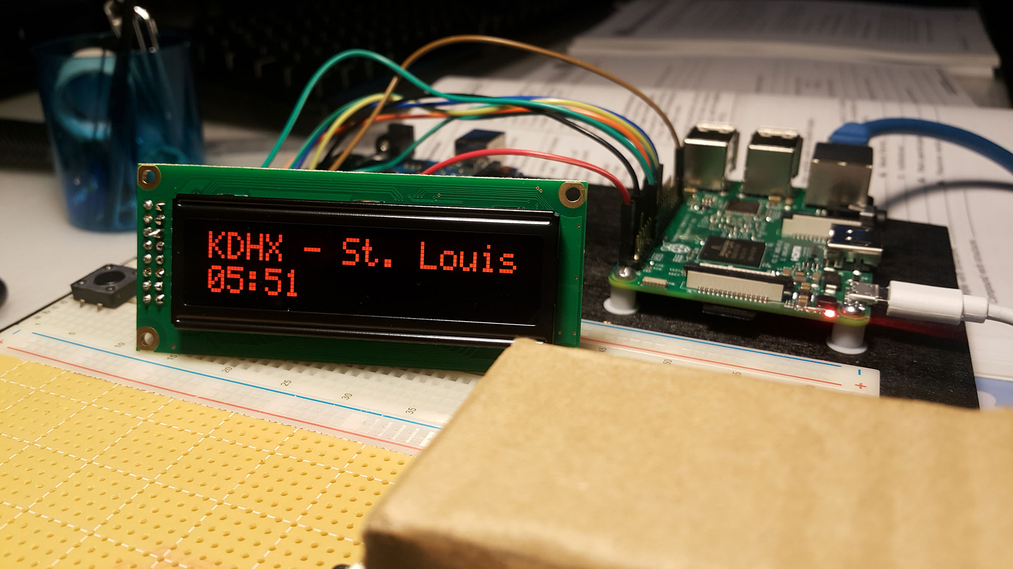

Hi
I am following a tutorial to install the script for an “oled display”. The script needs a module called “moment”.
The problem is that when i try to install that module using: “sudo pip install moment”, i get an error message as in the attached text file.
According to some members in the audiophonics forum, that same command and the script were just working fine in previous versions of moode audio. Any help will be appreciated.
[Disclaimer: I have no experience with the moment module or the OLED display script.]
OK, so at the end of your attached text file we find the smoking gun:
Code:
build/temp.linux-armv7l-2.7/ordereddict.o
ordereddict.c:22:20: fatal error: Python.h: No such file or directory
#include "Python.h"
Sure enough, running the find command on my moode-r3.7 installation turns up no instance of Python.h.
Finding out what package can supply the file Python.h requires a bit of Linux-fu. There is a package "apt-file" which can help with this. You don't need to install this because I just did. I found that the packages "libpython-dev" and "libpython-dbg" both contain the needed file. I chose to install the developer package:
Code:
$ sudo apt-get update
$ sudo apt-get install libpython-dev
Voila, there is now a subdirectory /usr/include/python2.7/ which includes the file Python.h.
With this done,
Code:
$ sudo pip install moment
Kent
OK, so at the end of your attached text file we find the smoking gun:Code:build/temp.linux-armv7l-2.7/ordereddict.o ordereddict.c:22:20: fatal error: Python.h: No such file or directory #include "Python.h"
Code:$ sudo apt-get update $ sudo apt-get install libpython-dev
With this done,proceeds to completion. As always, YMMV.Code:$ sudo pip install moment
Kent
It worked! Thank you very much. As you can see on the attached picture, it now works nicely thanks to you Kent. The oled displays are very nice as you can see. The script works on music and radio stations. When nothing plays it shows the IP address and the time. For those who are interested the display is about 10US$ and i bought it from 16x2 Character OLED Display, Multiple Colors (CFAL1602C)
For those interested i have attached a picture showing the wiring and the script. I got it from Forum Audiophonics.fr • Consulter le sujet - Moode Audio support
I just added the modification for installing the moment module by Kent.
Remy
