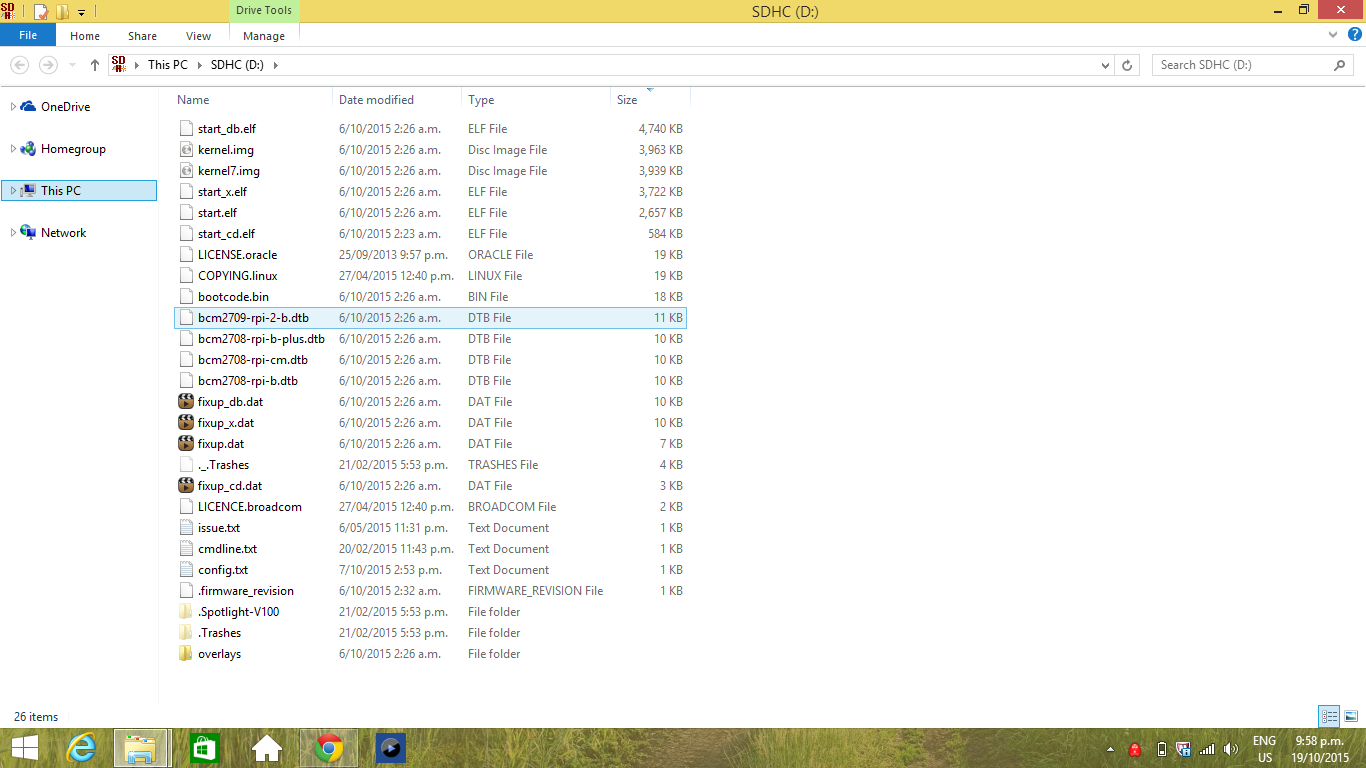

Help!
This is the first time I am trying to put an audio player onto my Rpi but having no luck. I was using the Rpi as a media center but hadn't used it for a while so tried Moode as it has great reviews.
I've tried two different SD cards and downloaded the card image from two different download sites but cannot connect to the Rpi.
Following the player setup instructions, I've powered up the RPi with the sd card and USB storage inserted but using "http://moode" or "http://moode.local" gets me "unable to connect" and the network connection setting shows "limited connectivity" for the ethernet connection to the Rpi.
About the only thing I can think of now is my Rpi is broke. Is there any any other method of connecting? An IP Rpi address or something else?
Not really computer savvy so any help appreciated!
thanks
thanks

I've tried from two different notebooks using an ethernet cable directly connected. One notebook running Windows 7 and the other Windows 8.
How are you trying to connect..? From a computer or a phone ? From a wired network or wireless...?
"http://moode" or "http://moode.local" won't work from an Android device but there is an easy fix.
What web browser are you using ?
How did you write the image to the sd card..?
I used google on one and I think firefox on the other notebook. Used 7 zip to unzip the image and used win32diskimager to put it on the sd card.
Plug the pi directly into the router via ethernet and try again.
Hey thanks, that worked! Do I have to now leave the Rpi connected to my router permanently to access the Moode page?
If you have a usb wifi dongle, you can set that up now:
