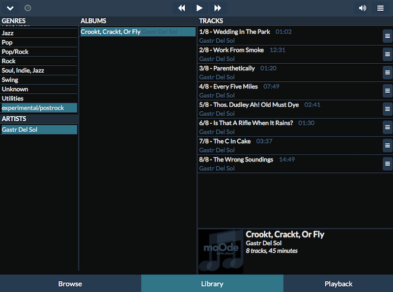

I'm able to repro the issue where AIFF tags are not being picked up by MPD update. The result suggests a possible bug in 0.20.6 MPD based on log file output below.
Added to TODO list for fixes
-Tim
Apr 16 13:06 : audiofile: unrecognized audio file format
Apr 16 13:06 : update: added USB/VFAT-8GB2/Test_mixed/AIFF/Crookt, Crackt, Or Fly/02 Work From Smoke.aiff

Tested with MPD 0.19.19 and the same log file messages appear but no issues with metadata. See attached screen shot.
There are a couple of ways to deal with this, one being to recompile MPD 0.20.6 without libsndfile and libaudiofile and just let ffmpeg handle things. I'd like to try this but it may take me a while to get through the tests.
If you want me to send you 0.19.19 binary as a work around let me know. You won't be able to set resampling because it uses a different conf file param then does 0.20.6

I do not need resampling, so it would be fine for me to use MPD 0.19.19 until everything works again...
