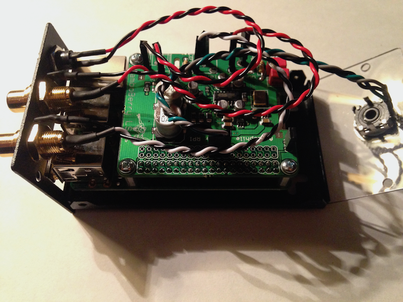

I have a HiFiBerry Digi +- Transformer version and when I play 24-96 music I am getting too much RF interference with my URC home theatre remote control system. The interference is not there with 44.1 music.
Putting a tin plate over the Pi helps but the interference is still there. Does any one know if there is a case out there that will act as a faraday cage?
I don't have the Digi problem, but work a lot with wifi and other rf sources.
I use copper adhesive tape, in 30mm width. Line your plastic case, make sure it's earthed.
You will need to use an external wifi transceiver. If you have shielded it right, no on-board is going to get past the cage.
I get my tape here:https://www.aliexpress.com/item/New...rrier-Preventing-Snails-from/32763668372.html
Easy install - line the case and cut out the holes you need with a hobby knife.
You will use less than half a metre. Getting an Earth can be tricky as it's hard to solder, I usually just run a tap from the pcb mount that I've screwed through the tape. Easy to check for connectivity with a multimeter. Watch for shorts.
Another option is lead tape, easier to join and Earth and gives decent heft to your devices, but some people are funny about using lead.
