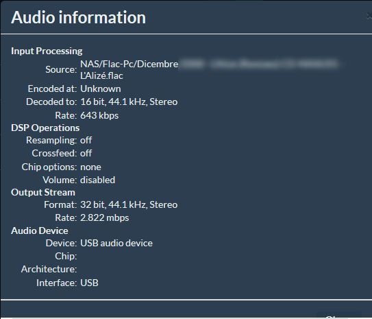

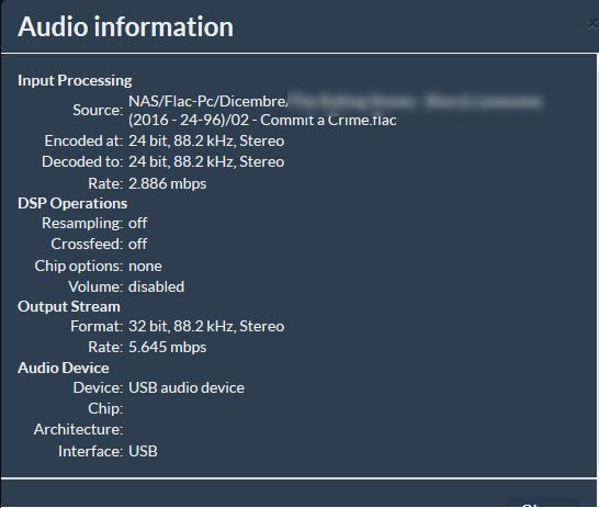

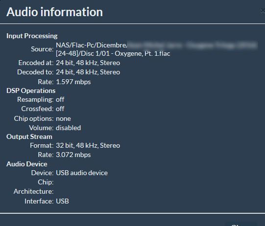

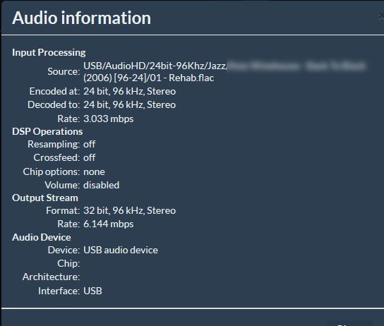

Hello Tim
Is it normal that any kind of file i play gives me always 32bit of output stream?
My dac is a Lector Digitube s192 dac with a 32-bit AK4397 DAC chip from Japan's Asahi Kasei Microdevices Corporation (AKM), supported by an AKM AK4113VF digital audio receiver chip.
p.s Is it possible to add this dac to the list in Customize/Audio device description?
Thanks for your great work!!!! it's stunning... great sound

Hi Marco,
MPD, ALSA and USB audio driver negotiate a format with the audio device and in this case I'm guessing that the USB receiver chip wants everything 32 bit word length.
I'll add to my TODO list to enter a description for the DAC in the audio device table.
-Tim

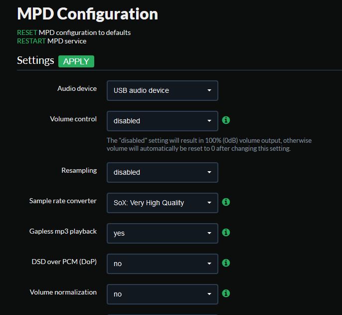

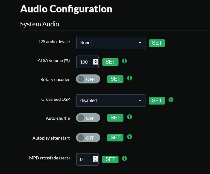

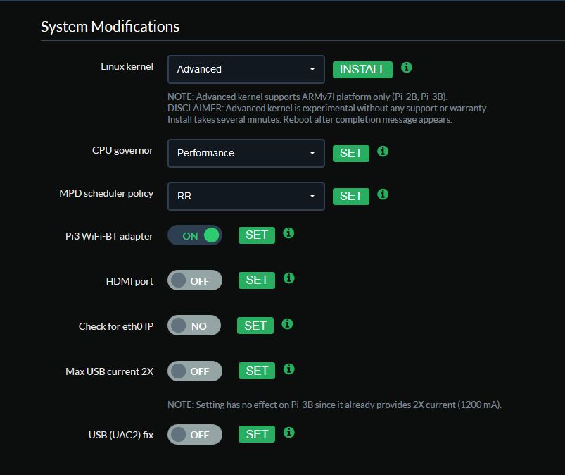

Wow!!! thanks for your quick answer!!
So there are no problems about bit-perfect output...
i set "volume control" disabled and Alsa volume at 100%
It's really faster to boot the last version disabling network discover and hdmi
