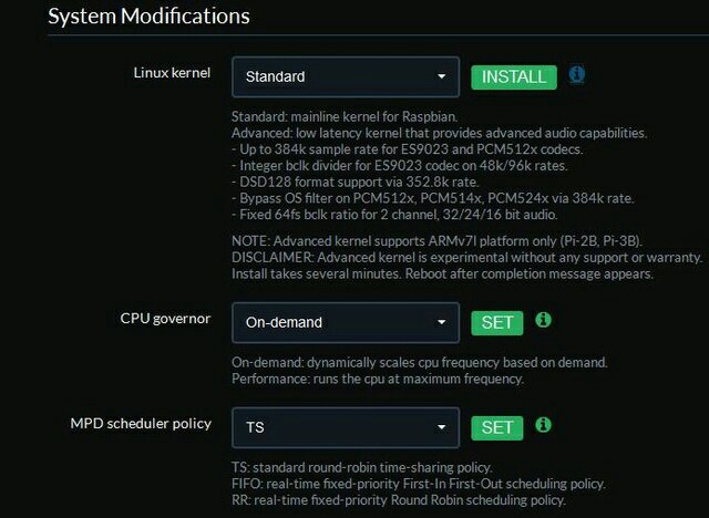

Just installed 3.0! Fantastic job Tim!
Only a couple of questions.
What are best settings for "CPU governor " and "MPD scheduler policy".
I have an rpi3 and pcm5102 and I usually play music upsampling 24bit 192kHz SOX.
First, CHECK for software update, INSTALL, reboot
Linux kernel: Advanced
CPU governor: Performance
MPD scheduler policy: Try FIFO on multi-core CPU, RR on single-core CPU
FIFO and RR are real-time scheduler policies that enable MPD to have priority over other tasks.
With the FIFO scheduling policy, a thread will be suspended when any of 3 conditions occurs:
1. It is blocked by accessing synchronize resource (I/O block, mutex, semaphore...)
2. It is preempted by a higher priority thread
3. It volunteers to give up control of processor (call sleep() or pthread_yield())
In the Round Robin (RR) scheduling policy, a thread will be suspended when any of 4 conditions occurs:
1. Same as FIFO
2. Same as FIFO
3. Same as FIFO
4. Its Time Slice expires.
As you can see, RR includes a time slice component which guarantees that a bad behaving thread can't entirely monopolize the CPU and starve other threads.
