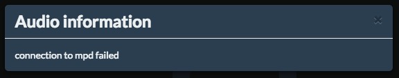

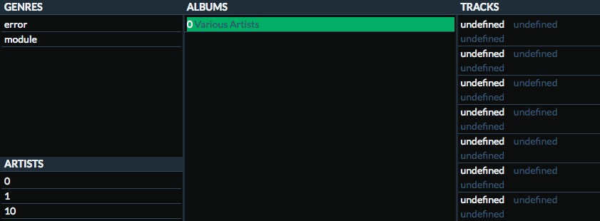

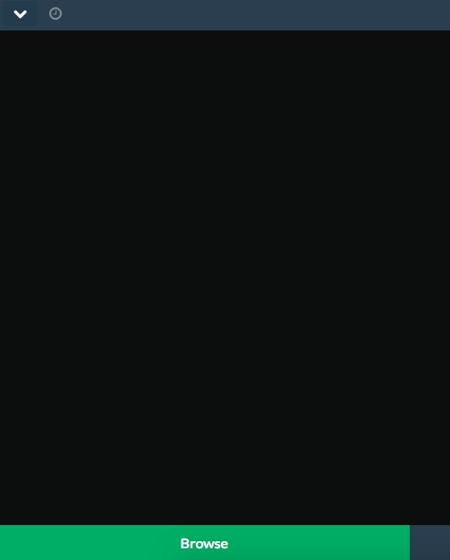

Ok, one step forward 🙂
I'm connected, but now, "mpd-config: connection to mpd failed" and the "Browse" tab is totally empty (library also shows some strange entries like undefined tracks etc).
This was clean install. This happened for the first time yesterday, when I installed the fresh updates. Is my card corrupt or indeed, something got wrong with the update?
