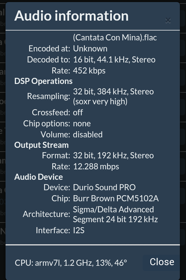

I have a Durio Sound Pro, DAC is pcm5102, maximum sample rate is 32bit 384 kHz.
I have tried upsampling from 44 kHz 16bit to 32bit 384 kHz.
Raspberry pi 3 support it without problems, music go out from loudspeakers, all is fine.
Looking in "Audio info" Output Stream is lower, 32bit 192kHz.
Why? Someone can help me?

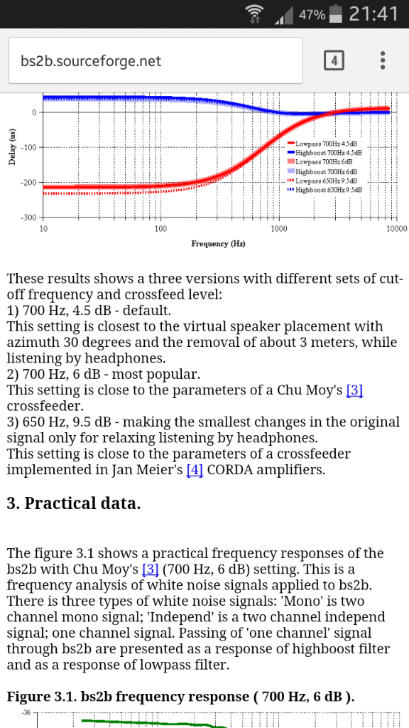

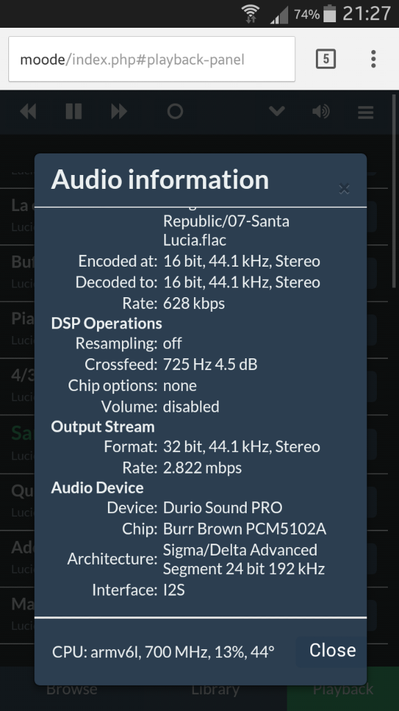

I have tested crossfeed, fantastic job Tim!
Only two very little and stupid comments...
Set up one has ine error:
Is written 725 Hz but it should be 700Hz. See Bauer official page:
Second is a question. When crossfeed is" on" Output Stream pass from 16bit to 32bit. Is it normal?
Thanks a lot again for this fantastic feature!
I think 192 kHz is limitation in SoX, or possibly in some part of ALSA. I recall reading about this in one of the kernel tweek threads on diyAudio.
-Tim

Correct it should be 700 and not 725. I'll make the change for first Moode 2.7 update. Below is from the source code for Crossfeed.
/* Default crossfeed levels */
/* bs2b_set_level() */
#define BS2B_DEFAULT_CLEVEL ( ( uint32_t )700 | ( ( uint32_t )45 << 16 ) )
#define BS2B_CMOY_CLEVEL ( ( uint32_t )700 | ( ( uint32_t )60 << 16 ) )
#define BS2B_JMEIER_CLEVEL ( ( uint32_t )650 | ( ( uint32_t )95 << 16 ) )
I'm seeing 32 bit as well. Its probably Crossfeed using 32 bit internally to perform its DSP calculations and then leaving the result at that bit depth. Something like that.
-Tim

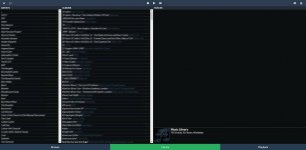

i have no files with a genre-tag. i see only "unknown" under "GENRES".
changed the "panels.css", so "GENRES" vanishes, but even if i make the "panels.css"->ro, moode overrides it
no elegant way, but works (attached pic)
maybe you could give me a hint to do it better
thanks in advance
puxxi2003
Code:
[I]/var/www/css/panels.css[/I]
#lib-artist-header {
    position: absolute;
    top: 220px; [COLOR=Red][B]-----> deleted[/B][/COLOR]
    width: 20%;
    border-right: 3px solid #212D39;
#lib-genre {
    position: absolute;
    overflow: auto;
    top: 20px;
    width: 20%;
    height: 200px;[B][COLOR=Red] -----> changed to 0px[/COLOR][/B]
    -webkit-overflow-scrolling: touch; /* TC testing */
#lib-artist {
    position: absolute;
    overflow: auto;
    top: 240px[B]; [COLOR=Red]-----> changed to 20px[/COLOR][/B]
    width: 20%;
    height: 67%; [COLOR=Red][B]-----> changed to 97%[/B][/COLOR]
    margin-top: 0px;
