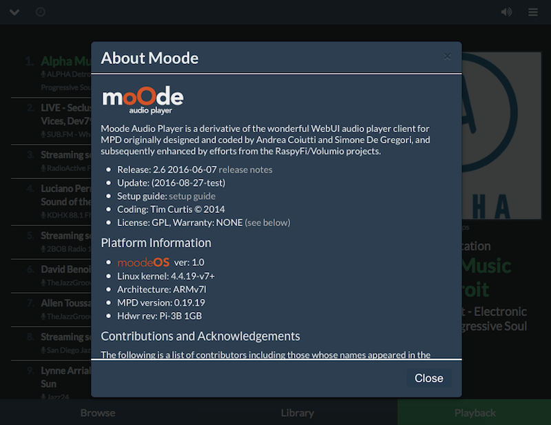

Moode 2.6 2016-08-28 update available.
READ CAREFULLY
Installing this update package followed by manually updating the kernel to 4.4.19 via the rpi-update command below will effectivly upgrade Moode 2.6 to Moode 2.7. If the updated kernel is not installed then NO SUPPORT will be provided!
sudo rpi-update 818a860cf690d64c62d3227ad9c36d5867a671c2
sudo reboot
sudo rm -rf /boot.bak
sudo rm -rf /lib/modules.bak
sudo rm -rf /lib/modules/4.4.8+
sudo rm -rf /lib/modules/4.4.8-v7+
The update package can take several minutes to complete due to components that are downloaded and installed from Jessie repo. After pressing INSTALL, if the message "Software update complete, Reboot required" appears immediately, just ignore it and wait several minutes. There is bug in Worker that prevents System config screen from auto-waiting before displaying the completion message. The bug is fixed in this update.
The update process can be monitored by ssh TOP to determine when its ok to reboot. Look for apt-get and mandb running. When they are both finished and no longer appear in list, its safe to reboot.
1) One of the updates installs HTML files that revert the knob colors to Emerald. Use Customize to set another color, then back to your favorite color, then refresh.
2) The wonderful Crossfeed DSP plugin is included in this update and there is a config change to enable Airplay over AP mode. IMPORTANT: To establish Crossfeed/MPD outputs and Airplay over AP mode its necessary to perform the steps below after reboot.
a) MPD config, APPLY
b) System config, set Crossfeed DSP to 725 Hz 4.5 dB then set it back to disabled.
c) The config can be verified by running the cmd below from ssh session
pi@moode:~ $ mpc outputs
Output 1 (ALSA default) is enabled
Output 2 (ALSA crossfeed) is disabled
pi@moode:~ $
d) Network config, APPLY
e) This will update the configuration for Airplay over AP mode
3) Several configuration changes are included that provide improved support for loading large collections into the Library panel.
4) New commercial-free, listener-supported radio stations and support for exciting new I2S audio devices are included in this update, and a new universal rotary encoder driver that updates Moode volume knob and supports both hardware and software volume.
Finally, it's always a good idea to BACKUP the SD Card before installing updates 🙂
Enjoy!
Tim
