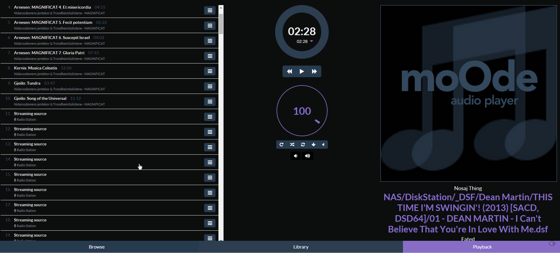

Hi Tim,
would like to provide you my first impression after I successfully mounted my NAS (with about 16800 songs) yesterday evening.
My system contains: (hardwired) RP2 => Geek Pulse Xfi DAC => Integrated => speakers
After the "upgrading" process was done I saw my NAS in the "Browse" page with the corresponding folders where I store my music.
But in the "Library" page none of my music was shown (so add me to the list of users where this happened, too ;-))
I refreshed the side but still nothing was shown. But after I rebooted Moode the "Library" was fillled.
I struggled a bit how to play a song but figured it out finally that I need to add the song at first to the playlist.
Just checked quickly if dxd songs can be played. Confirmed!!! (shown in the Xfi as 24-352,8) Although I haven´t listened to a whole song yet it appeared that everything works like a charm (no dropout, no bufffering).
I switched to another file (14-44.1) and recognized a loud pop sound via my speakers?!?
I will have a closer look at this later this evening and willl see if this pop sound appears whenever the bitrate changes.
Furthermore I hope the "Embedded" album art lookup will be integrated in one of the next releases since all of my covers are directly tagged. ;-)
So thanks so far, Tim, you´ve created a little gem!!!

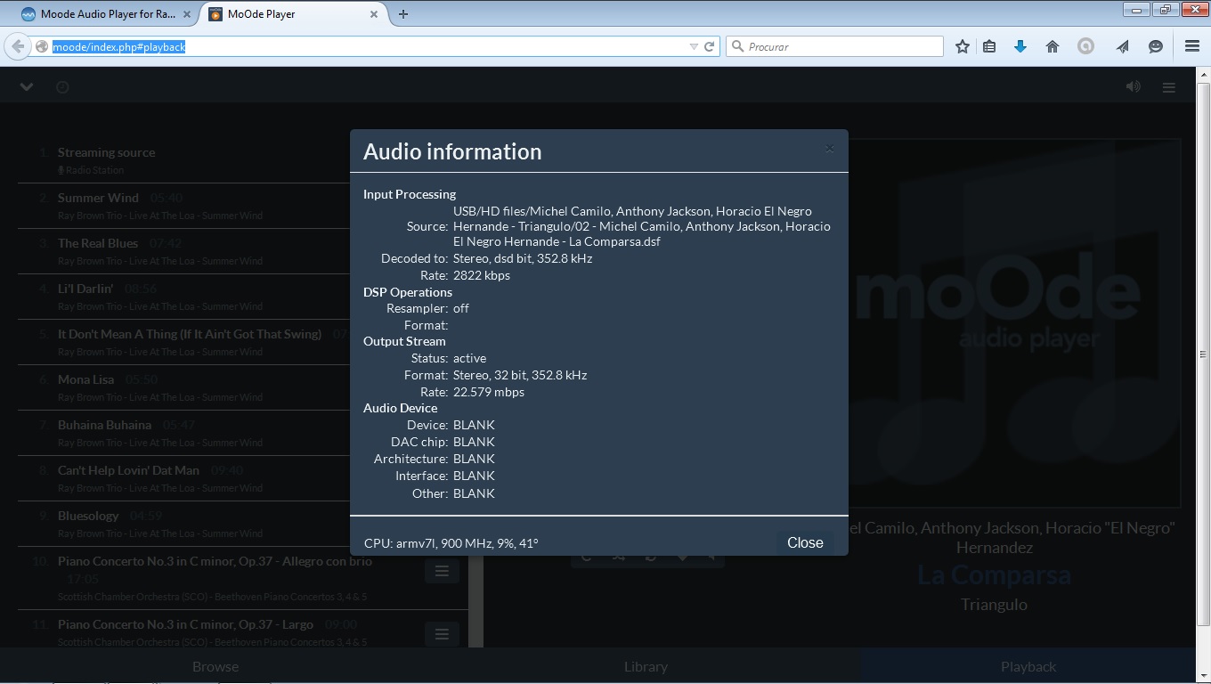

.dsf files
No problem with .dsf files with my Pi2 and diy dac based on a amanero board.
I use the sonore tool to convert .iso files to .dsf.
How about .cue files? Is that possible in the future?
I have a lot of albuns with cue files.
Thanks and congrats!
Thanks for the compliment and feedback on dsf play back!
FLAC/Cue is on my to-do-at-some-point list :)
What is your diy DAC? I can make a device description for it so you can see details on the Audio info popup instead of BLANK, BLANK, ... Send email to tim at tcmods dot org with the following:

I´m also interested if you can see your dsf tagged files in the library and how you managed it that they were shown correctly in the playback window (at least by looking at your screenshot - below the album cover - it appears to me that the song is correctly tagged [Artist, Song, Album]).
In my case - although i see my "_DSF" folder as a subfolder of my NAS´ music folder in the Browse page - none of the DSF albums appear in the Library.
If I add a dsf album from the browse page to the playlist they (i) appear in the playback page as "Streaming source/Radio station" (see left side of the sreenshot) and (ii) aren´t assigned to the correct album (see info below the placeholder for the album cover).
Besides that I can also confirm that dsf files are played smoothly w/o any issues. Very cool :)
My Pi2`s CPU load was between 1 and 9% when I checked and the highest temperature in the low 40s. Quite nice, too.
I think this is a default behaviour for anything not tagged correctly.
I have 24/96 wav that report as "Streaming source/Radio station" because they are vinyl rips without tagging or 'Cough-'tube-'cough' conversions....:)
Yeah Tim mentioned something like this to me, too, Drone.
He checked one of my dsf files with "lsinfo" via the console. And although I tagged all relevant info fields with MP3tag (see below) it seems that MPD doesn´t see the infos.
2015-06-22 20_51_49-Mp3tag v2.64  -  F__DiskStation_1_Music__DSF_Dean Martin_THIS TIME I'M SWING.png
Therefore I´m wondering how @rickpt has successfully managed this ;-)
Should I use another tagging tool instead of MP3tag? Although the flac/mp3 albums are correctly shown in moode?
