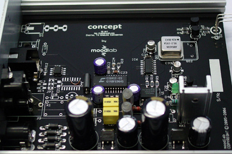

Any experience with the Mood-Lab (under construction) dac? I'm considering buying it. Price is $199 for the basic version "concept" with 1 digital input and $399 for "dice", which has more digital inputs includes Toslink optical, coaxial and USB input for computer.
I really like the minimal concept (no input buffer, no reclocking) while the lay-out allows it to experiment with components.

Bas Horneman said:looks a little overpriced to me.
Care to tell why? I think it's the cheapest commercial available NON-OS dac, isn't it? Furthermore, I have no idea how it sounds! Do you?
Sure. I look at it from the point of view of a diy'er. I don't see fancy casework. And looking at the parts I arrive at a price of say 40-90 euro's.Care to tell why? I think it's the cheapest commercial available NON-OS dac, isn't it? Furthermore, I have no idea how it sounds! Do you?
I have an idea how it sounds but not exactly ofcourse, since I have not heard that particular one. I have heard 3 types of TDA 1543 nos with CS8412 receivers and I liked them all.
2 of them use 8*1543's paralled and the other was with a single TDA1543.
But for a commercial product it is not that expensive ofcourse. There is the pcb design costs. Dealer markup...etc. etc.
Just a bit.
Well, the layout is not optimal -- the PS is poorly done, the IV section should be closer to the tda1543, I have doubts about a carbon resistor for the PLL, the DAC chip is not decoupled well, if at all, the spdif input scheme is not so good, and socketing those chips is not a great idea here -- it makes sense in prototyping, but there is no reason to remove them. Also, the output impedence will be very high, so you will need to run it into an amp with an input impedence of at least 25K, if not 50K.
This doesn't mean it will sound horrible, but the tda1543 is very sensitive to the quality of the PS, and you can find better commercial versions with essentially the same schematic that will sound better. Moreover, you could build this better on stripboard for about $40-50.

What's missing there?
Again, what's wrong? Are you suggesting a input buffer? It's just that i'm glad this design doesn't have it 😉
I'm interested! Examples?
And you can find better commercial versions with essentially the same schematic that will sound better. -d
reMC said:What's missing there?
The 1543 likes a high quality small value film cap right on the power pin, and an electrolytic in the 220uF-470uF range nearby.
reMC said:Again, what's wrong? Are you suggesting a input buffer? It's just that i'm glad this design doesn't have it 😉
Or an input transformer -- it does a world of good.

This is cheaper and corrects some of the issues. There are still some good modifications that can be done to this for cheap and it is missing the input stuff, but it is really cheap.
Thanks for the feedback, but I'm really searching for versions with 1 TDA1543, passive I/V and no reclocking!

1. cheap parts.
2. simple is good but far to simple. Still got cap on the signal path 🙁 that will make the sound soft and sweet but is that what you want?
3. over priced with very little to show 🙁

Hi guys,
Here's a pic of the current version of this DAC. Any comments on this design? It certainly looks more professional, but I'm wondering anyone is able to point out significant improvements. I know the "product features" section on the web page lists improvements, but you guys are the experts 😉
I'm kinda interested in it. I've been thinking of buying a Monica2 for the past year, but the Mood Labs Concept is appealing because of the (much improved) enclosure.
http://www.mood-lab.com/concept.htm
I haven't found any comparisions with Monica2. If the Mood Labs DAC appears to be a solid design, I might go for it, unless I hear a resounding "NO!".
