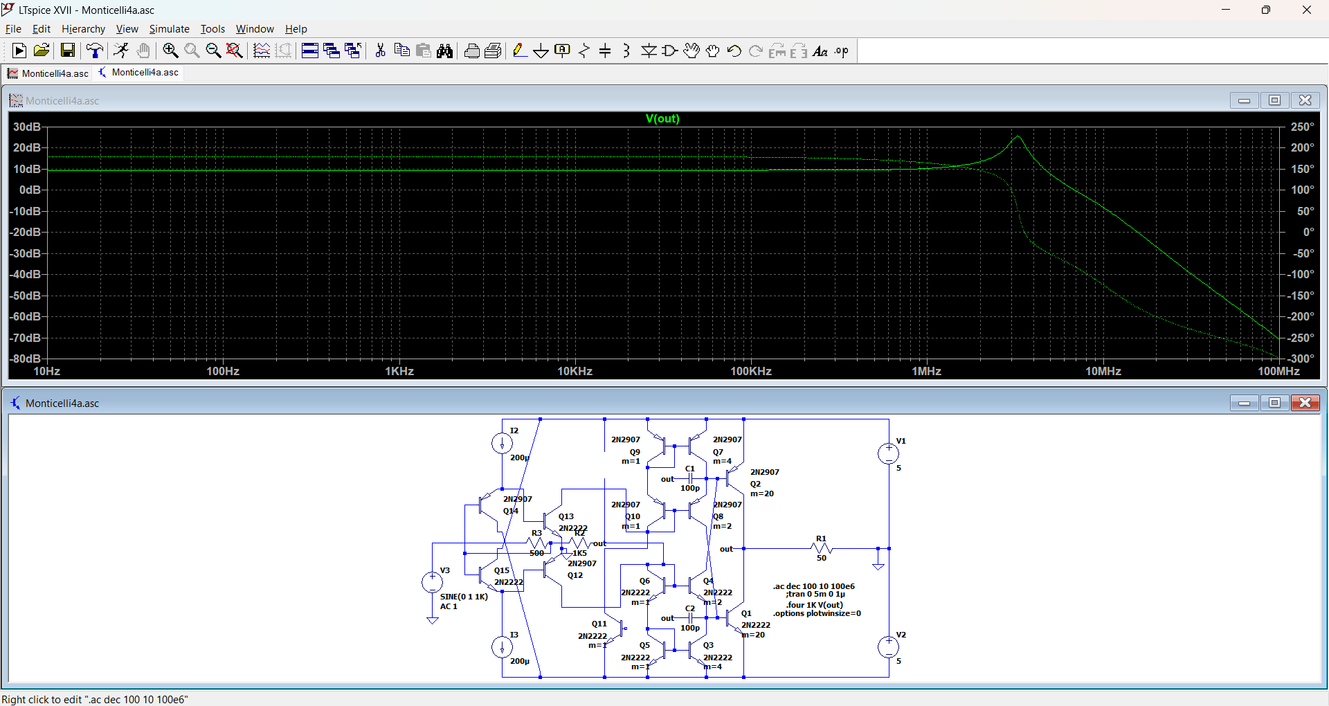

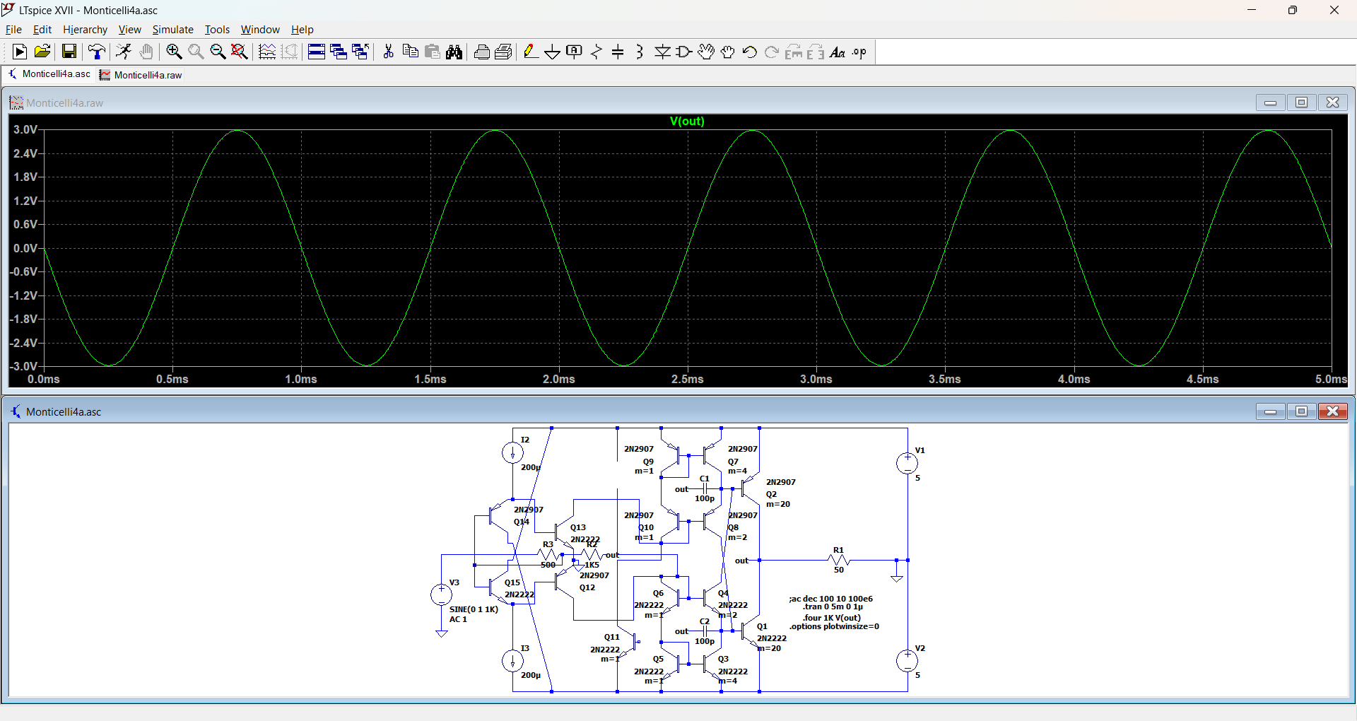

This is my first tentative; I adopted a symmetrical drive, as the circuit lends itself to such a configuration.
The driven nodes are the bases of the OP transistors, and I had to correct the area of Q3 to get consistent results:
The results are disappointing: despite the low closed-loop gain (4), the THD is 0.67%, and the frequency behaviour is dismal:

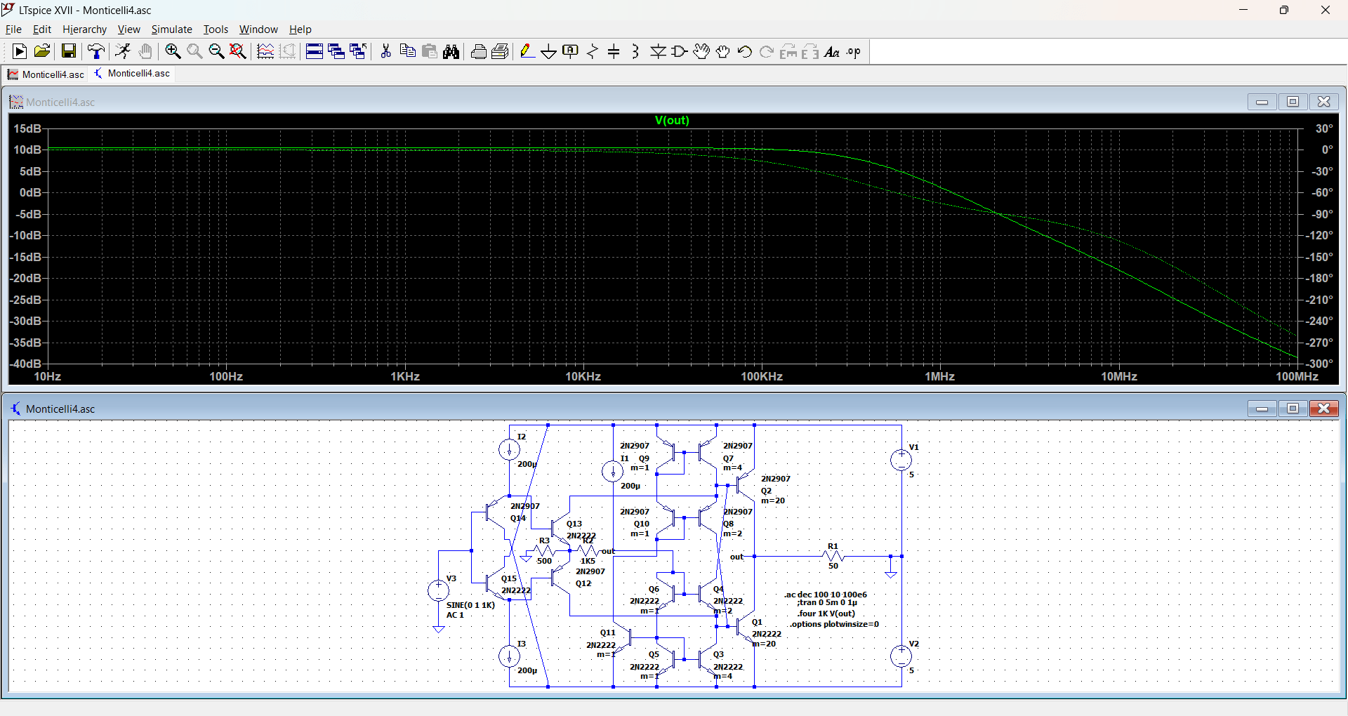

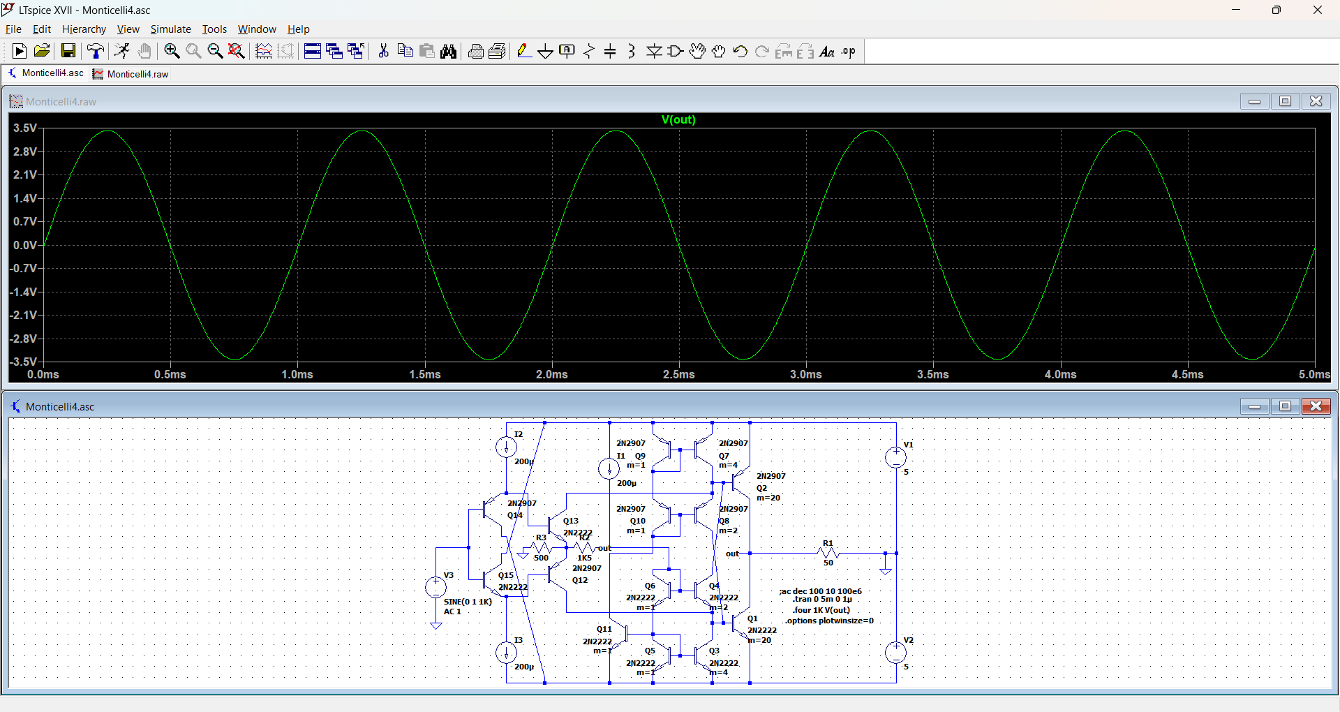

I then tried a different injection point:
As the circuit was not stable, I had to add a summary compensation: C1, C2. Their location and value is certainly not optimal, but the THD has fallen to 0.031%, and the FR has improved too:

Thanks, I can't run sims at the moment so I am very interested to see your results.
That is worse than I hoped, my first suspicion is that it just needs more gain!
Have you looked at the open loop tranfer function of just the output section, comparable to the Art of Electronics plot?

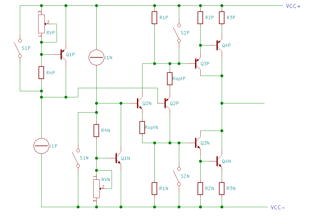

I was thinking of something like this as a possible discrete implementation. Connection to the earlier amplifier stages not shown, as I don't know what those stages will look like.
R3N and R3P are there to improve the thermal stability, but they mess up the harmonic mean control law. I hope that can be fixed to some extent with RoptN and RoptP.
R1N, R2N, R1P and R2P are basically cheap current source implementations. As the voltages across them don't vary much in the crossover region, I think you can get away with using resistors, otherwise they have to be replaced with better current source implementations.
Unfortunately, the Darlington output stage costs some voltage headroom.
To adjust the P side's minimum current, disconnect the earlier stages, close S1N and S2N, short the output to ground via a current meter and trim RVP.
To adjust the N side's minimum current, disconnect the earlier stages, close S1P and S2P, short the output to ground via a current meter and trim RVN.
One could also connect R1N and R2N to the other side of R3N, and connect R1P and R2P to the other side of R3P. The signal voltages across R1N, R2N, R1P and R2P are then somewhat smaller, so the current variations are also somewhat smaller.

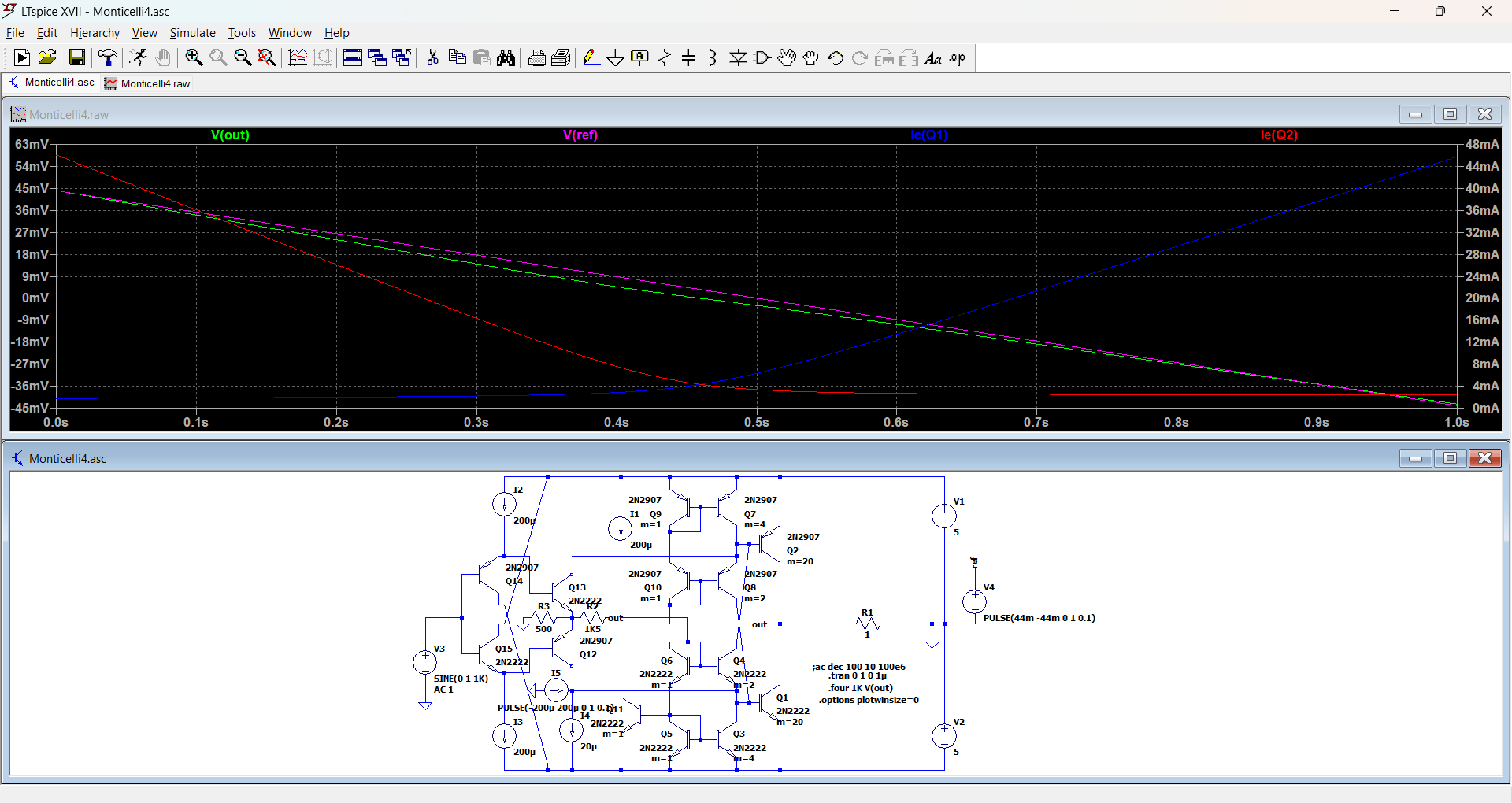

Here it is, green trace.The magenta one is an ideal straight line, for reference and comparison. Red and blue are the currents through the output transistors. The current transfer is 45/0.2=225:Have you looked at the open loop tranfer function of just the output section, comparable to the Art of Electronics plot?
