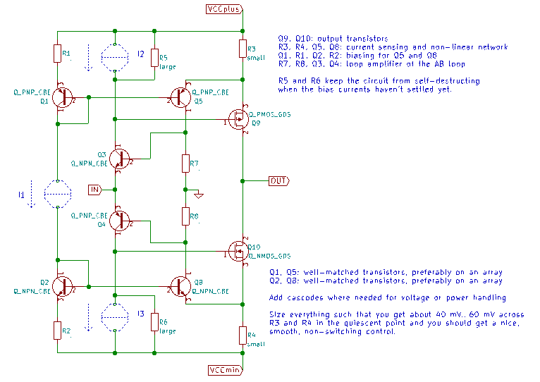

In the Monticelli circuit, the sum of the VBE or VGS of an output device and the VBE or VGS of a common-base (or -gate) stage has to match the voltage across a stack of two diode-connected transistors, so you will indeed need to ensure thermal tracking between one of these diodes and an output device and between the other diode and the common-base or -gate stage. This is not different from the thermal stability issues you have in a conventional complementary emitter follower output stage, though.
I guess you would have to give the output transistors small emitter resistors, replace the stacked diodes with a VBE-multiplier and mount everything on a common heat sink. I don't know how exactly you would have to trim the quiescent current with two trimmable VBE-multipliers.
An alternative could be some variant of the 1976 class-AB bias loop technique of Han Huijsing and Frans Tol. Sense the currents through your output devices with small resistors, pass the resulting voltage through some non-linear circuit made with transistor arrays and use the result to control up or down the current through both output devices.
I meant something like this. No idea if you can get it stable, though.

In the Monticelli circuit, the sum of the VBE... This is not different from the thermal stability issues you have in a conventional complementary emitter follower
Yes, that's pretty much as I see it too.
I expect the two Vbe-multipliers will be referenced/driven by a current source from rail to rail, so they track in unison.
Similar to your circuit in post #9.
