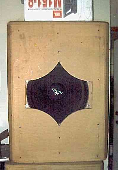

...so it took 9 years for JBL engineers to copy it!I know a guy who did this in his car audio system in about 2005...he was sponsored by JBL.

Put a slot in front of a woofer to change the radiation pattern. Make it funny shaped to spread out the problems. I'm less than amazed. 😉
Seem like a really interesting idea; I do wonder if it skews phase with its turbulent release of the pressure waves along that long, diffractive edge.
So in essence, this acts like a nozzle, widening the output pattern?
A Karlson aperture would work here and give you better horizontal polars.

Seem like a really interesting idea; I do wonder if it skews phase with its turbulent release of the pressure waves along that long, diffractive edge. So in essence, this acts like a nozzle, widening the output pattern?
Yes, as I understand.
I am pretty sure that the JBL guys have studied that better than any of us amateurs can. The mask is on the edges and there distance from mask to membrane is short - interferences appear at frequencis above xo. The shape must have been tested for years and the funny shape is functionally most satisfactory. I am sure that it is matched to the horn well. It is not visble, not a "selling argument" like the funny "phaseplugs" that we see in some fullranges. Also the horn has wedges.
