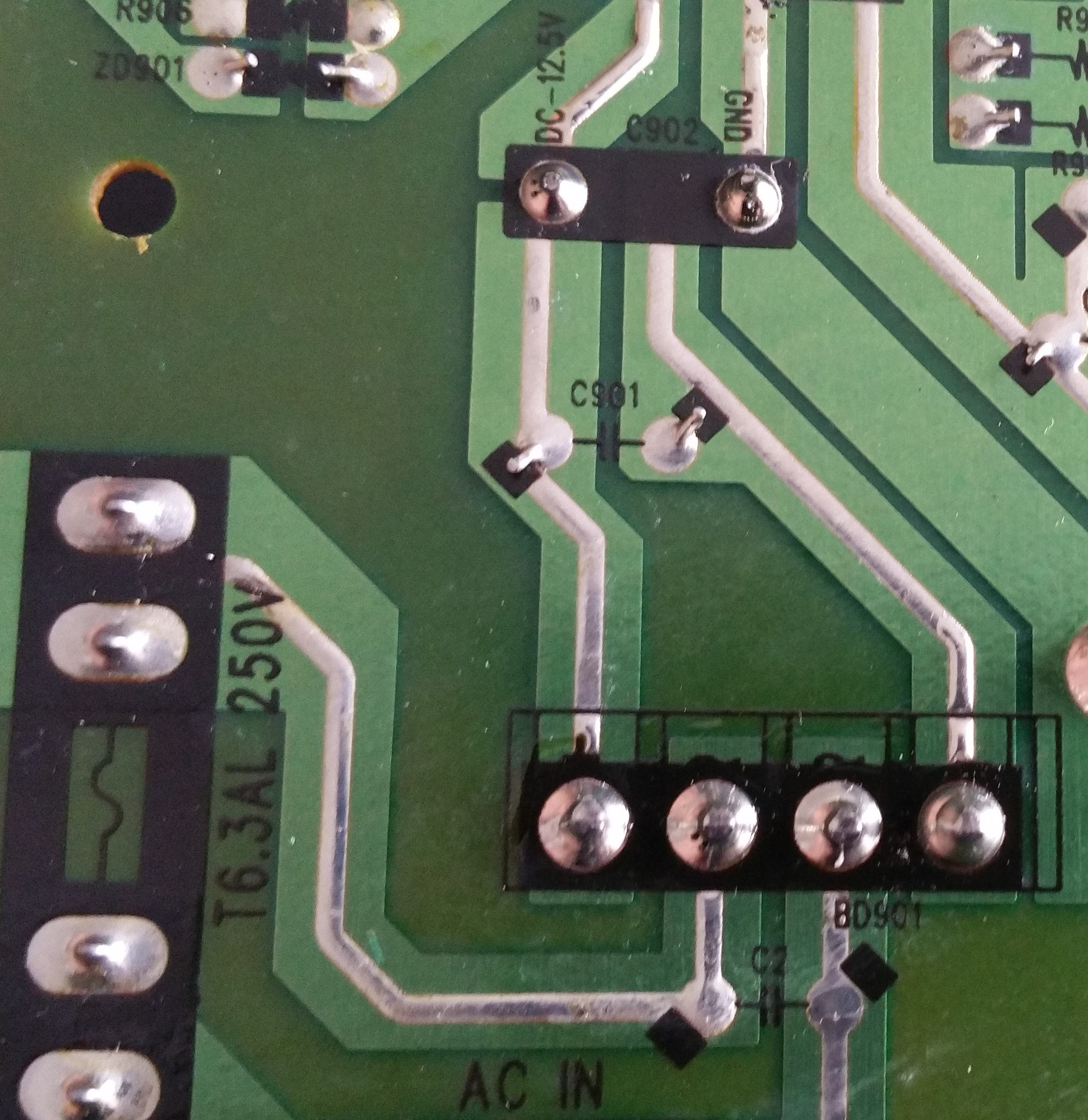

Ok, so I think the rail voltage is 12.5VDC. At least that's silkscreened to the board at the output of the bridge rectifier (see pic). I also know from measurement that the original PT secondary is at 12VAC.
I don't have access to the subwoofer at the moment to measure, but a quick search of a similar Eastech driver shows 3.56Ω (DCR) for a similar 4-ohm (Z) speaker.
So it looks like a ballpark of 12.5V/3.5Ω= 3.57A across that load.
That means a PT secondary coil would need to carry 3.57A*12VAC= 42VA. Then there are some losses to be concerned with.
Am I on the right track here?

Yup. Throw in a few watts for the planars & preamp plus a bit for losses and you're in the right ball park. 60VA would be about right, based on what you've saidThat means a PT secondary coil would need to carry 3.57A*12VAC= 42VA. Then there are some losses to be concerned with.
