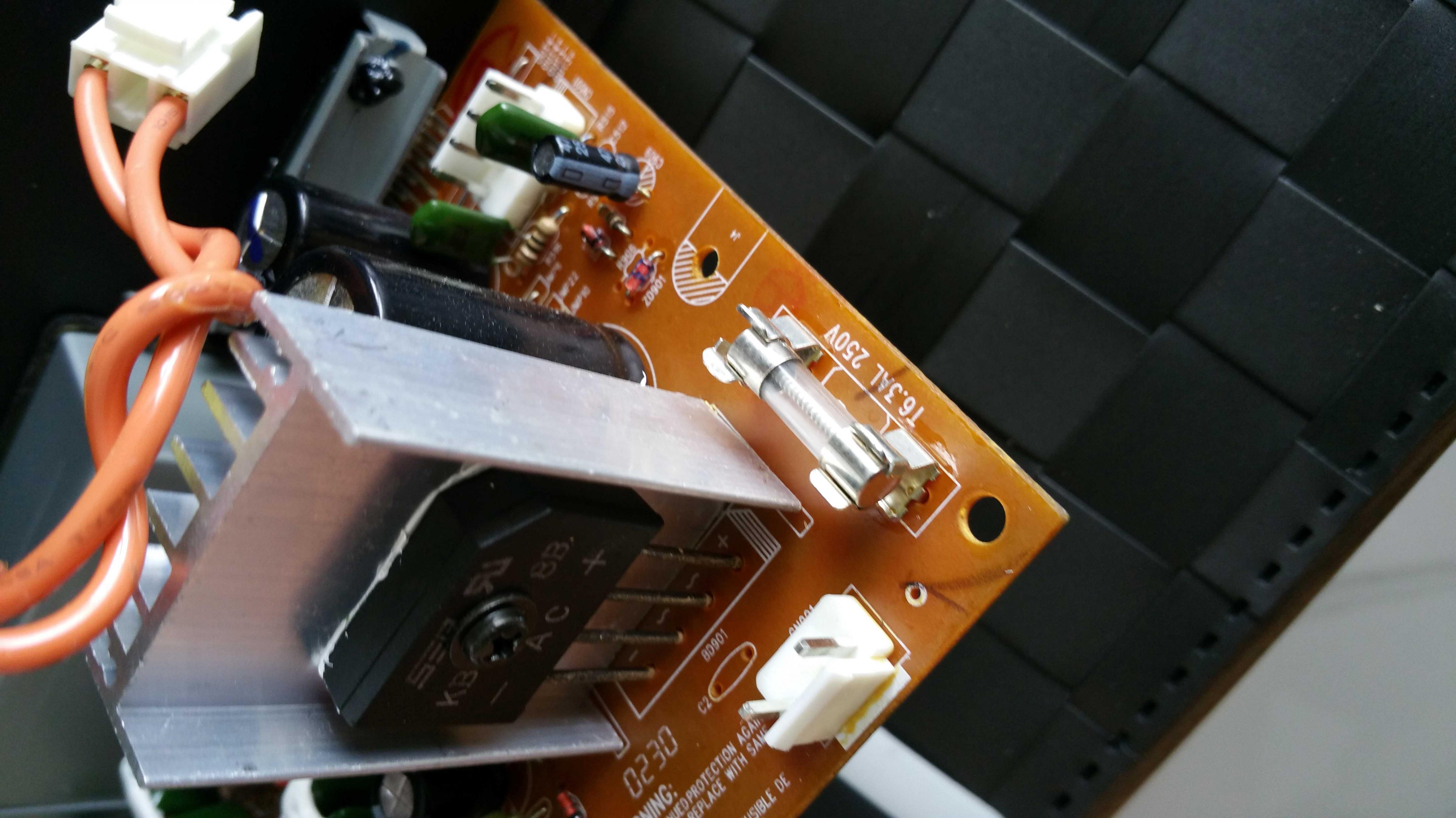

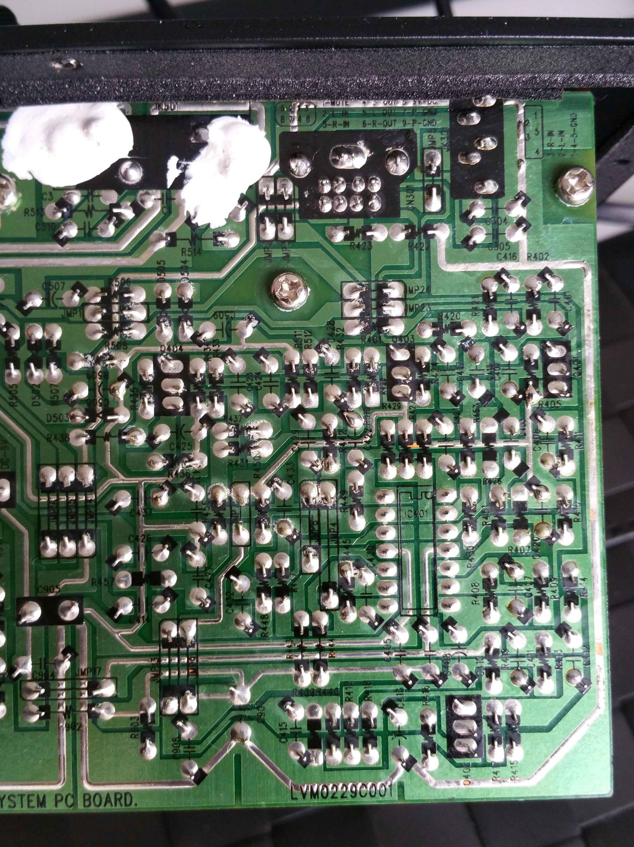

I moved from the US to Singapore about 10 years ago. I had my Monsoon PlanarMedia 9 system shipped with our household items and I'm just now digging it out (yeah, it takes me a while to unpack).
My PM-9 is rated for 120 VAC 60Hz but here in Singapore, the supply is 230VAC at 50Hz. I assume that the frequency difference in this particular application won't be critical (is that correct?). I'd like to swap out the onboard transformer for one that will work with the local supply. I'm not a complete novice, but I haven't done much electronics DIY since moving to Singapore, so I suppose it would be appropriate to respond as though I am a novice.

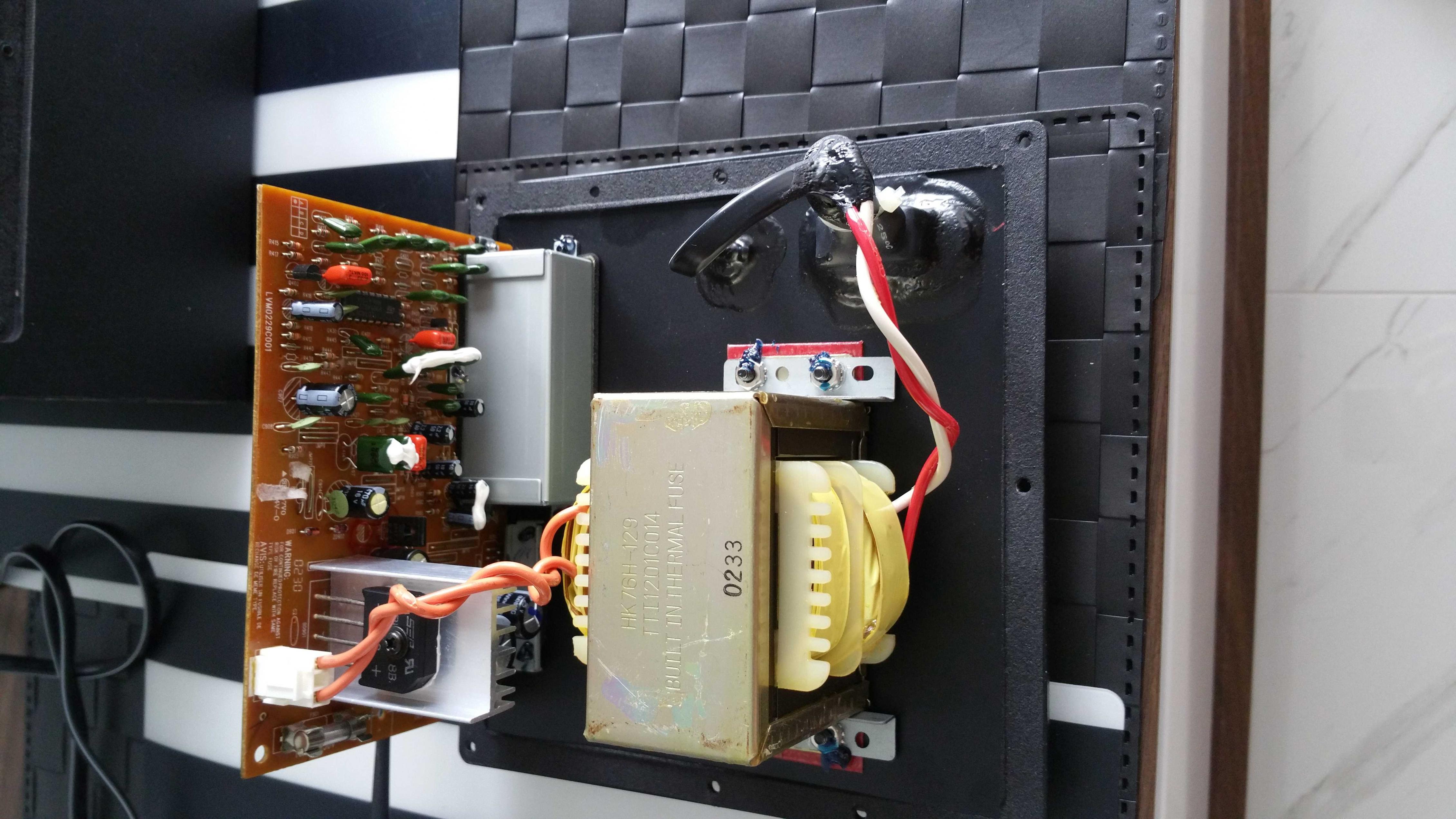

The markings on the transformer are:
HK76H-129
TTI1201C014
BUILT IN THERMAL FUSE
0233
And on the side:
DAR PLUS A
I can't find any info on this part, and therefore, I don't know what the output should be. I also don't have an external step-down transformer in order to be able to power up the unit and test the output.
Does anybody know if I can simply swap out the transformer in this application? Any idea of the transformer output or how I could measure it?
HK76H-129
TTI1201C014
0233
And on the side:
DAR PLUS A

It seems to be an AC power adapter rather than a transformer.

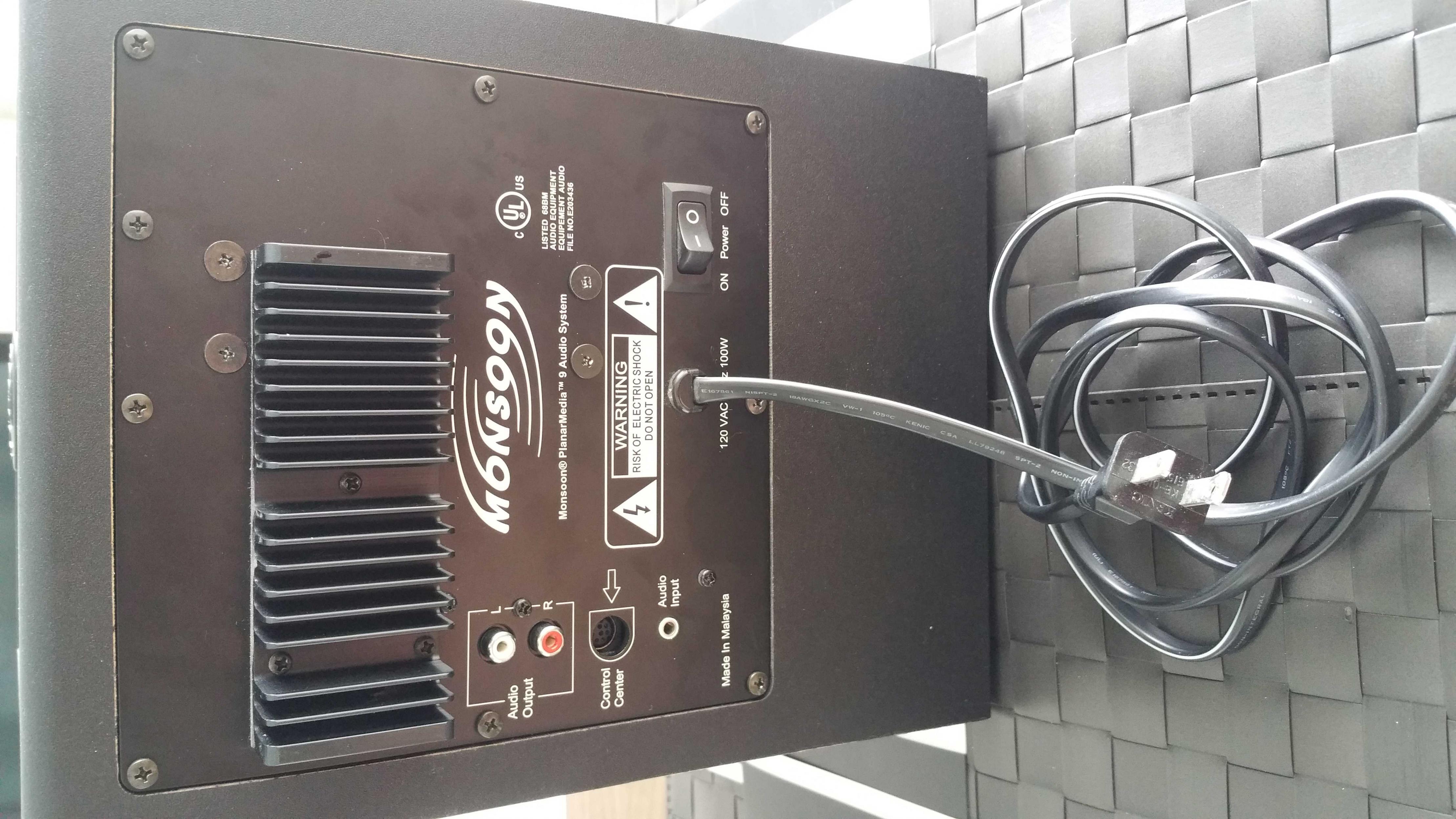

Am I correct that a brick is an external device that is inline with the AC line, similar to a laptop? If so, I don't have a brick.
I have a typical US grounded blade plug (2 flat blades, one ground prong) that runs through a line directly to and through the back of the subwoofer, to a main on/off switch, then to the transformer in the pics.
That's a change then. Monsoon's page states that the power adapter is external.
The voltage should not have changed, so the 15VAC advice should still be gold. There are two wires on either side, so it's definitely just one winding.

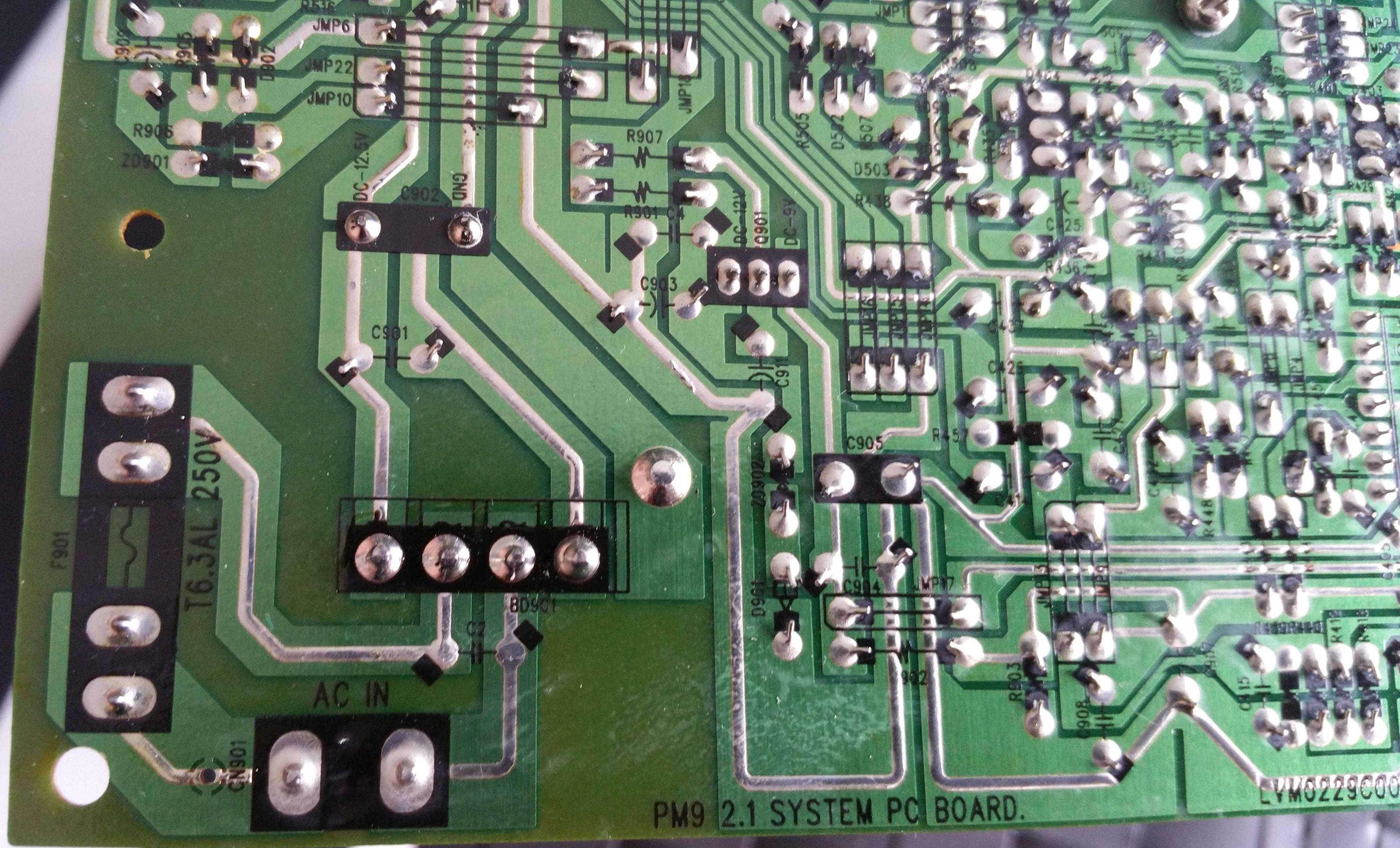

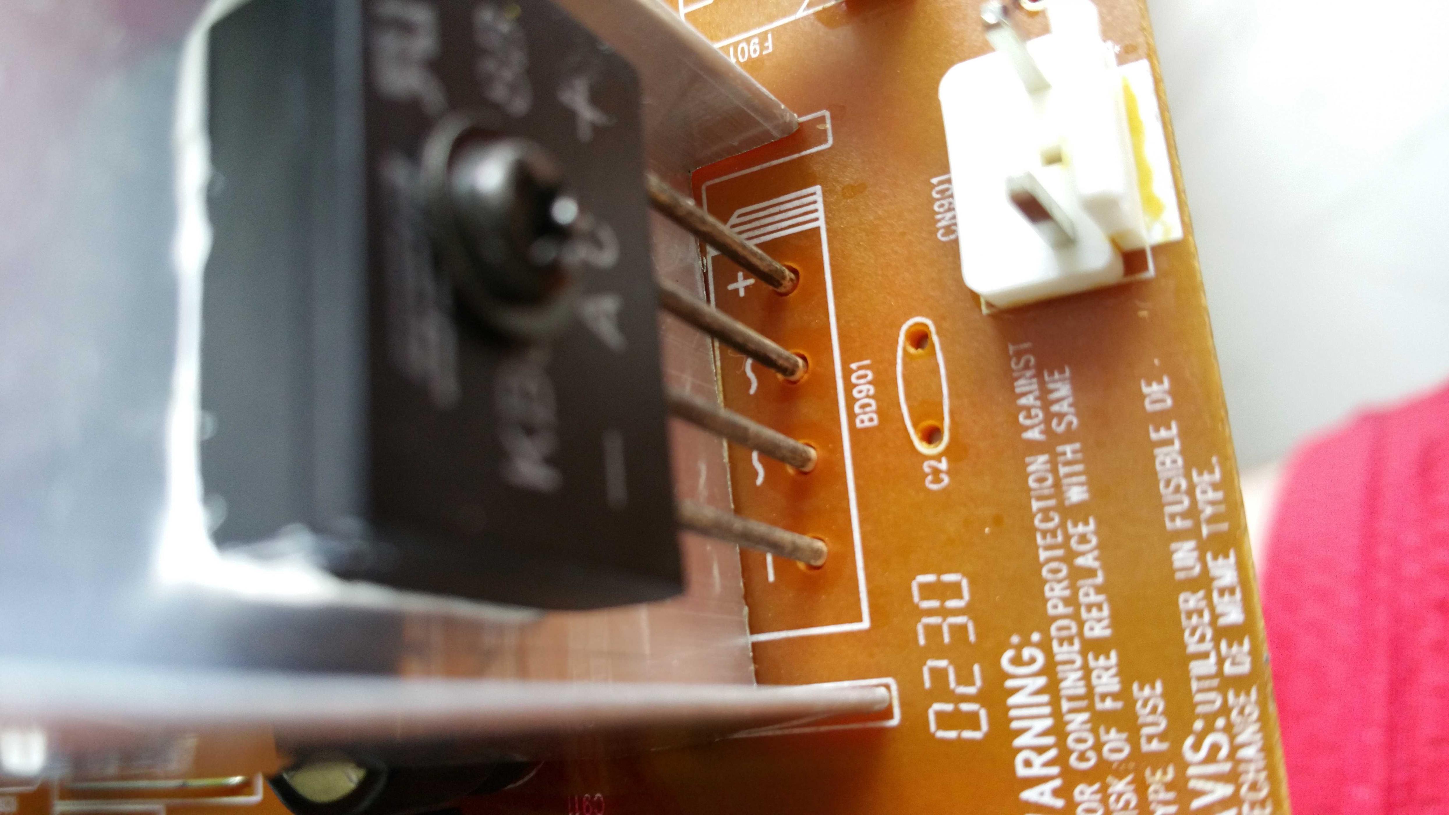

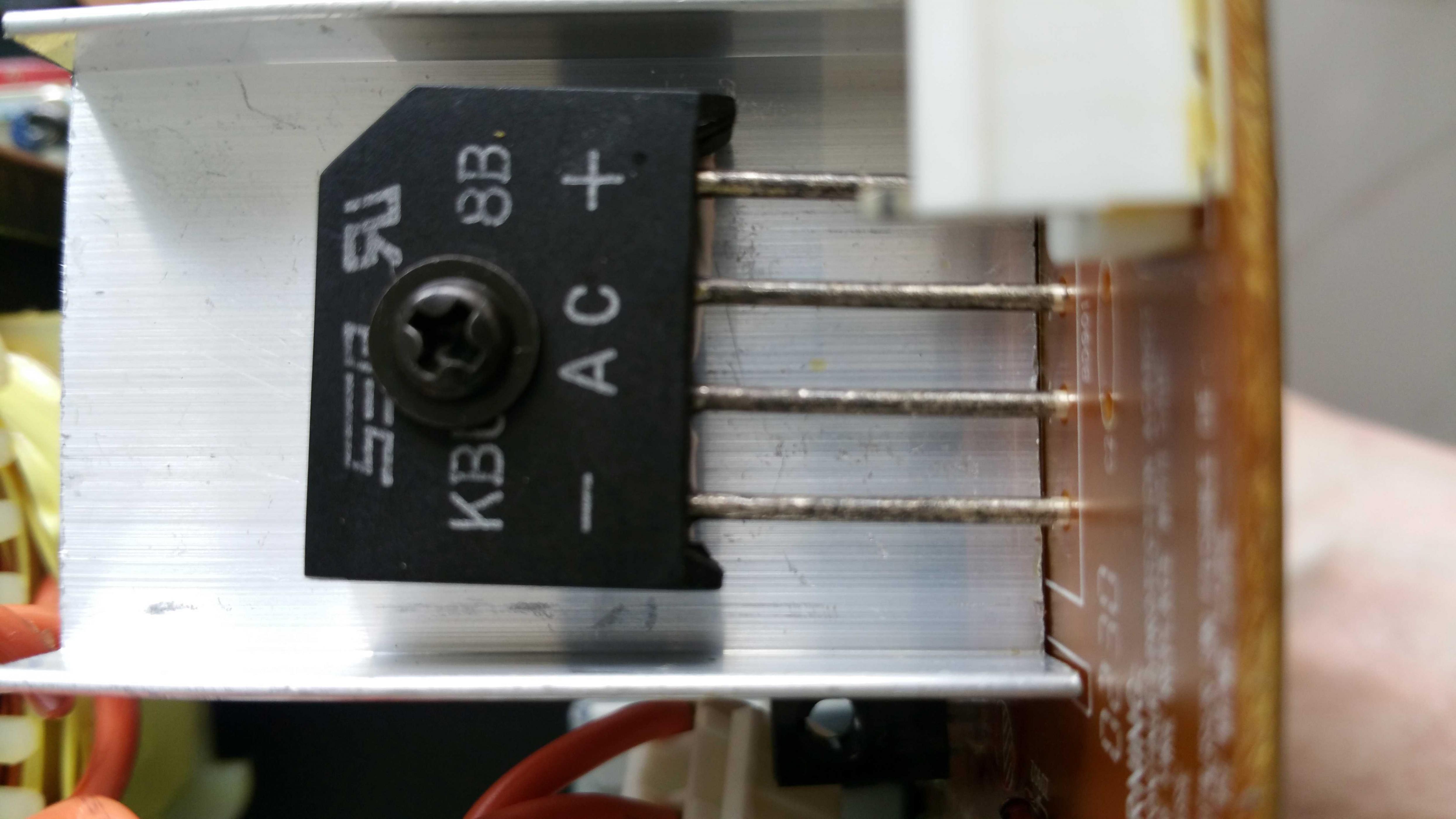

Just to confirm then, I'll need a mains transformer for 50Hz that steps down from my supply voltage of 230VAC to 15VAC correct? I assume the rectifier will have no problem with a 50Hz input instead of the original 60Hz input. Is that correct?

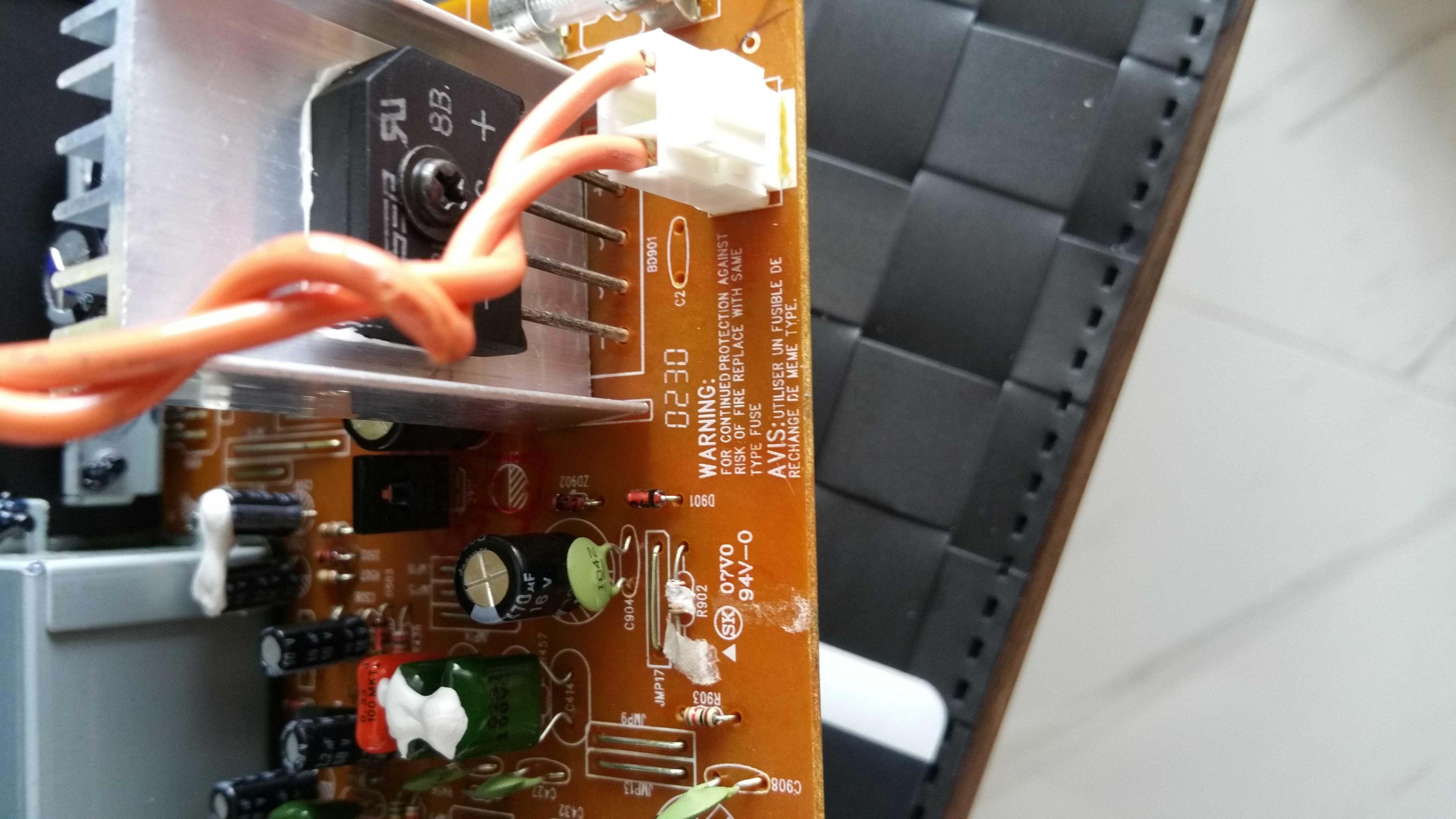

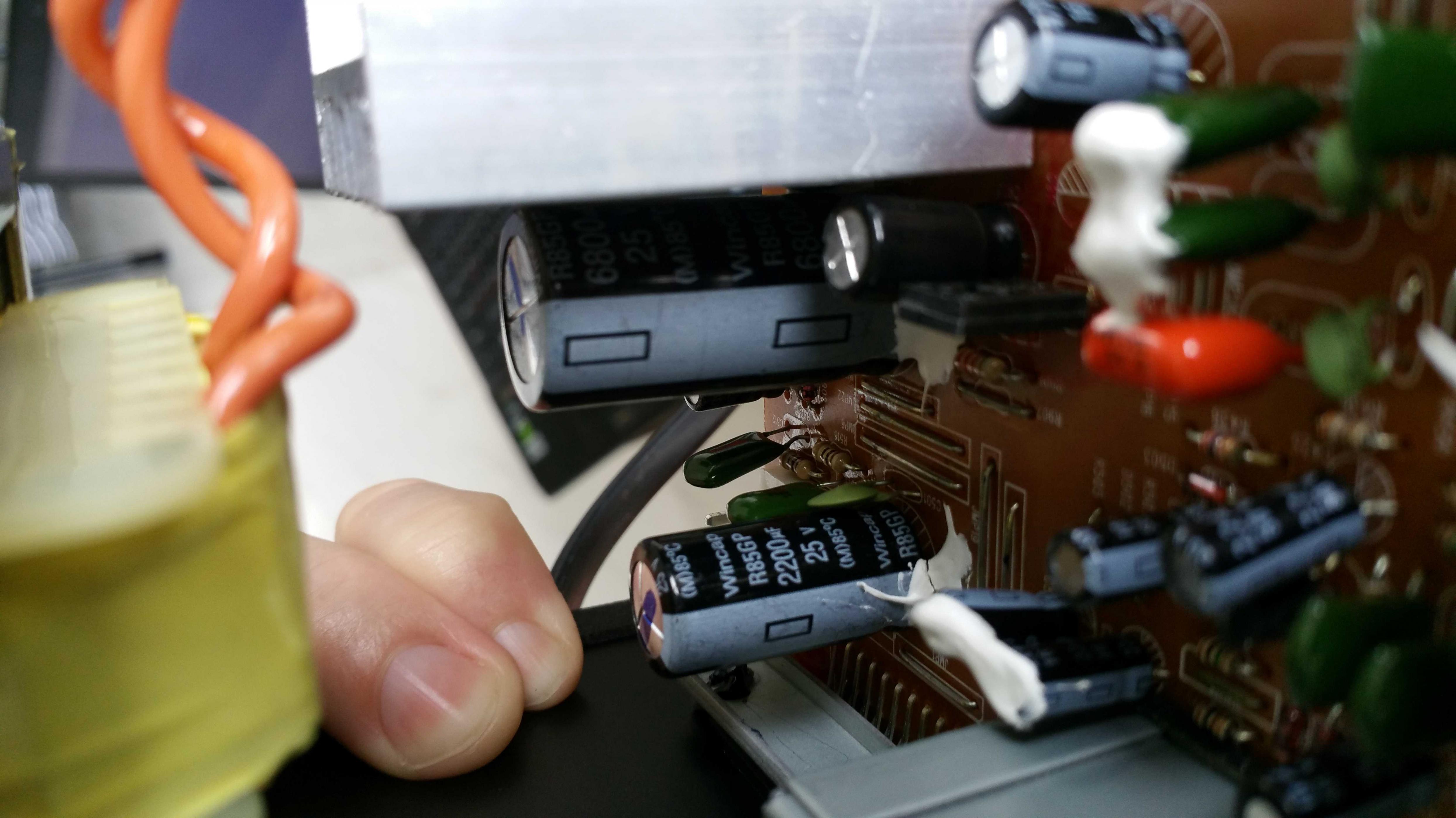

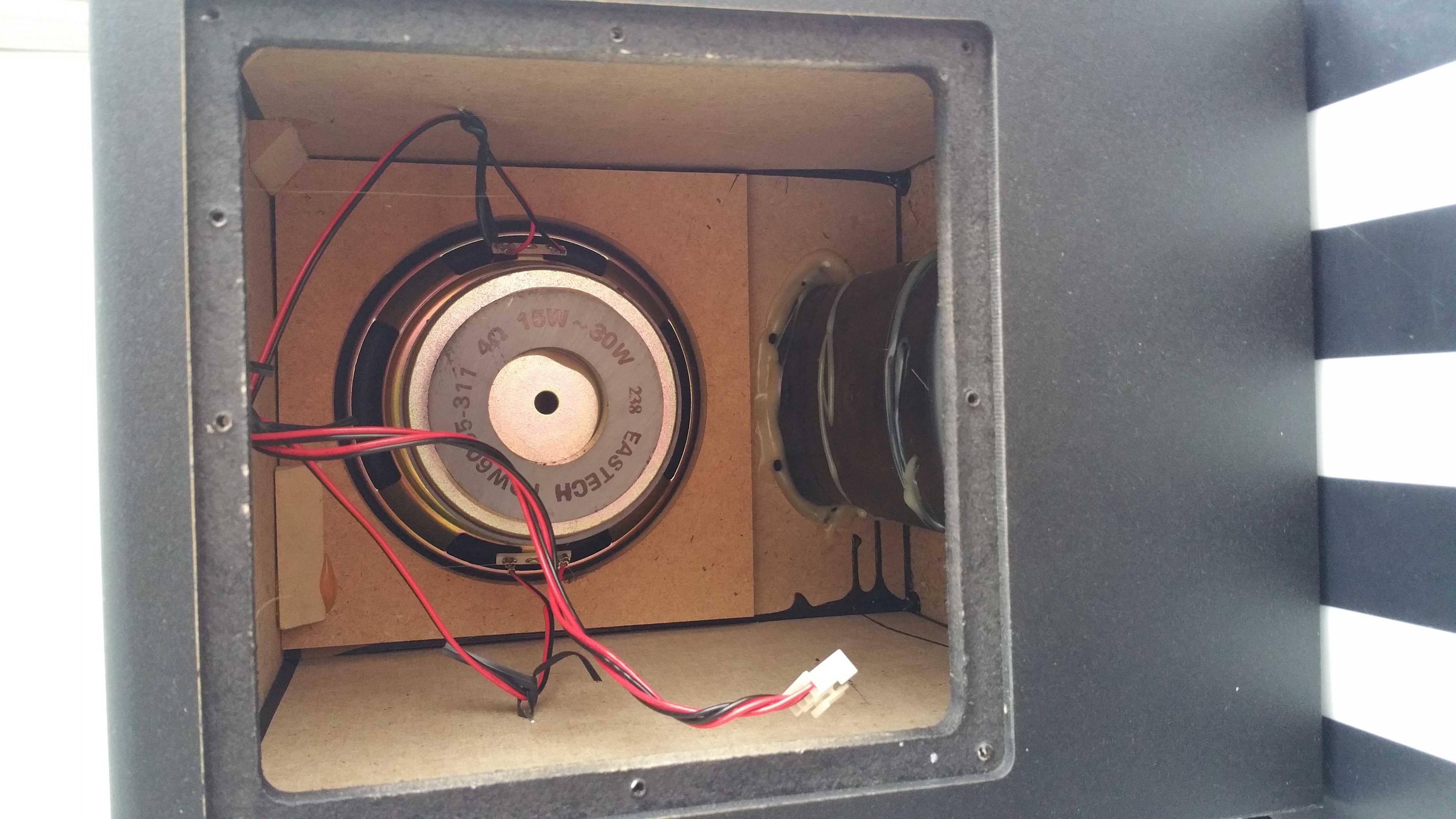

I've attached some more pics in case anybody needs these in a future search. In the thread that Sangram linked, handrew shared a schematic in post #86. However, the schematic is for the PM14 whereas I have the PM9. Similar but some differences if you compare the schematic to my pics.

Probably: it's 100VA which is the magic number, according to the label on the back of my PM-9Would something like this work?

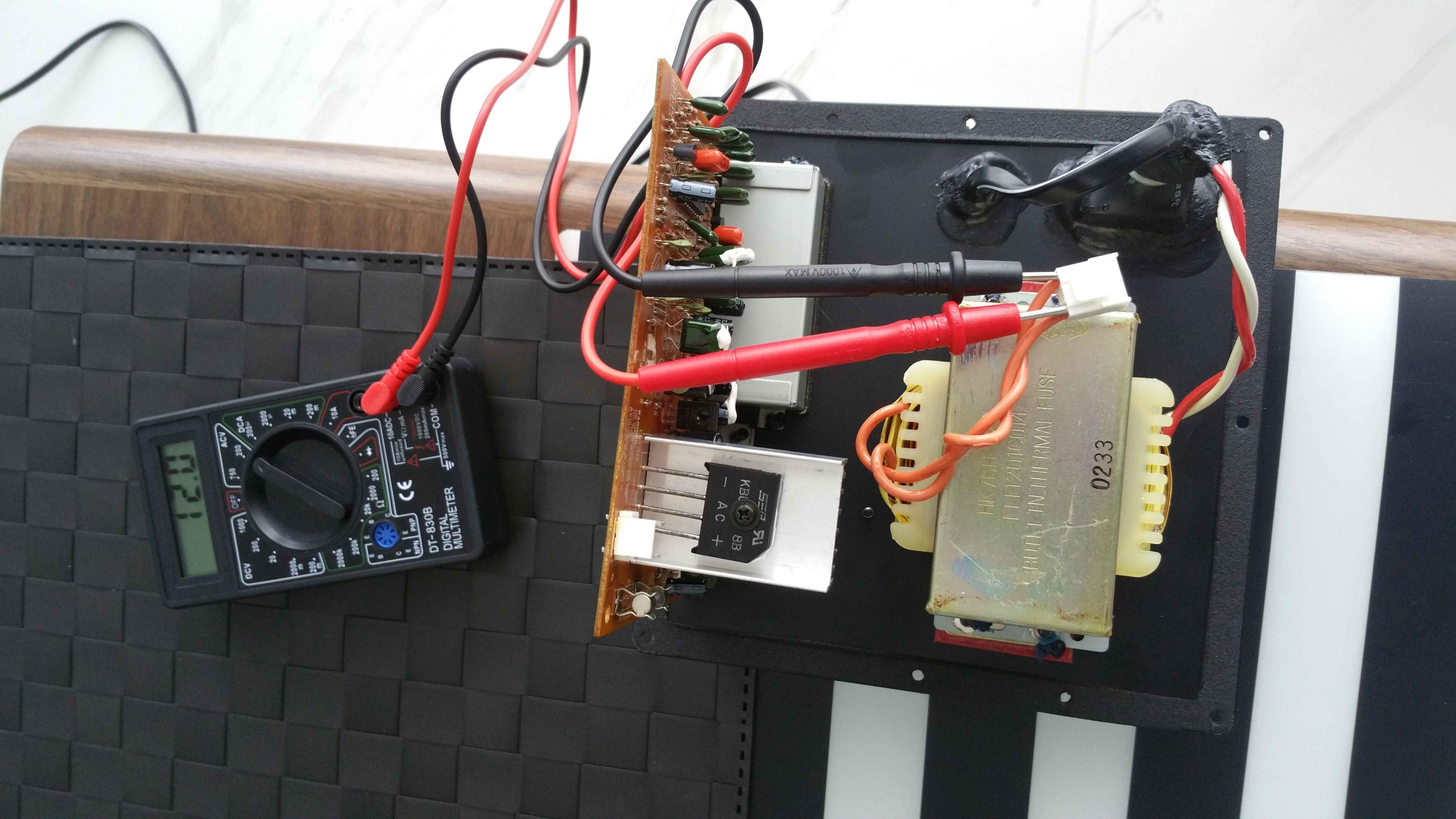

I can't honestly remember what the secondary voltage was but if you feed a a dozen volts AV into the primary & measure the secondary, then you'll be able to confirm what the correct voltage should be.
I found an old wall-wart style voltage converter that I used to feed 120V into the sub's internal power transformer. Measured 12V across the secondary winding. I guess it's a 10:1 ratio for anybody who may need this info in the future.

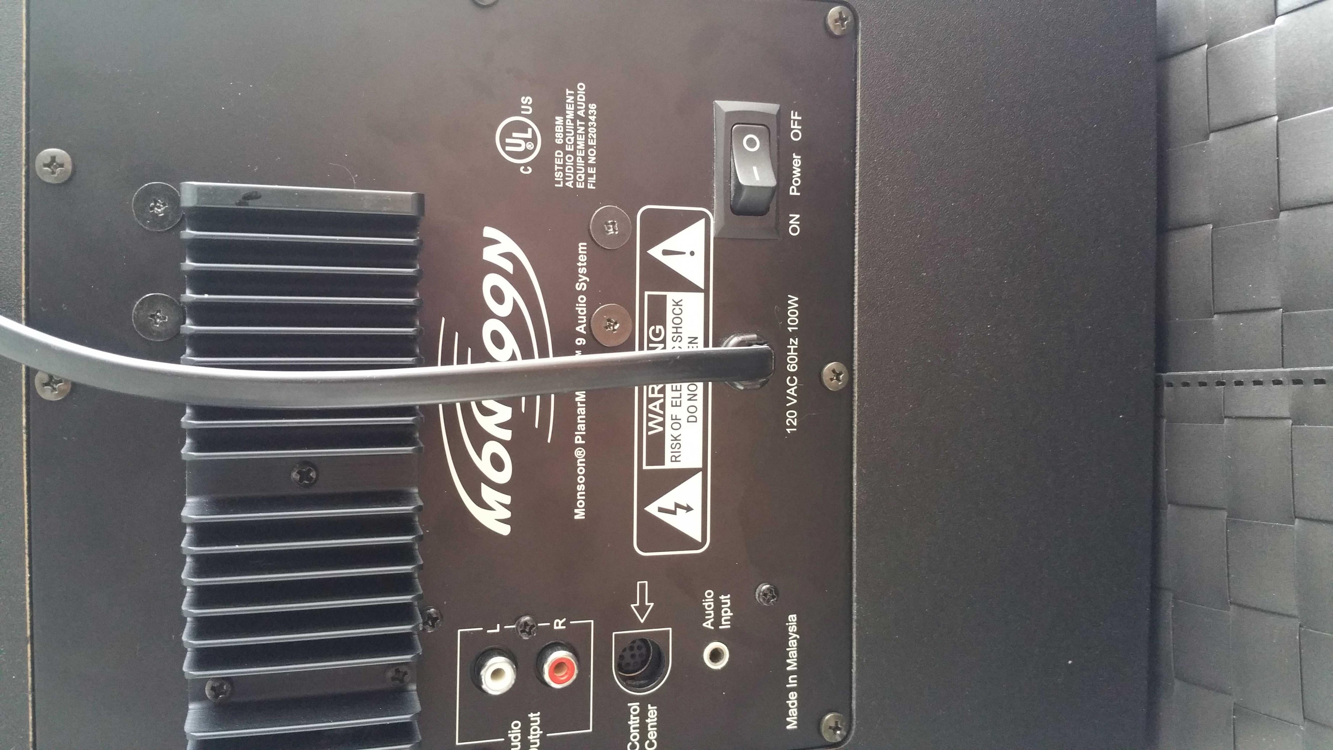

2) the Monsoon PT is not 100VA, even though the subwoofer nameplate says 100W (see earlier picture)
I assume that if I undersize the replacement PT, then it could easily overheat or worse. Is there some way that I could determine the VA rating of the original PT so that I can confidently fit a properly spec'd replacement? Also, the original PT has a thermal fuse while most of the PTs that I saw at the shops did not have one. How critical would this be?
