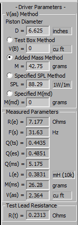

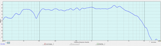

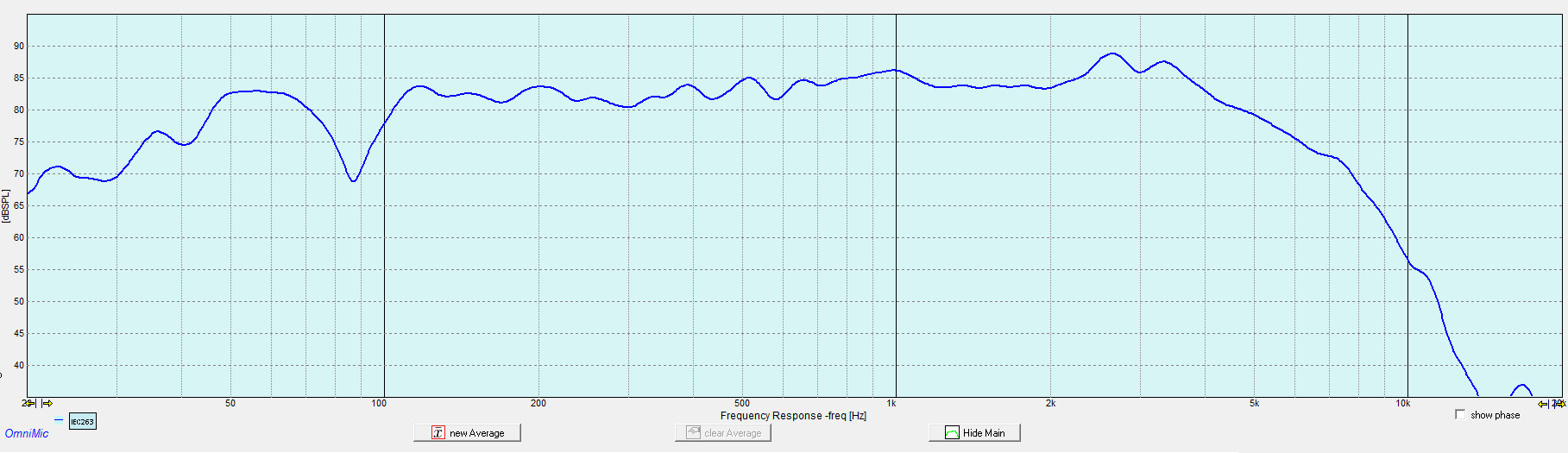

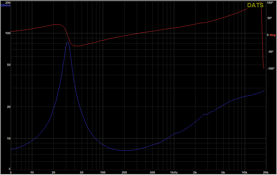

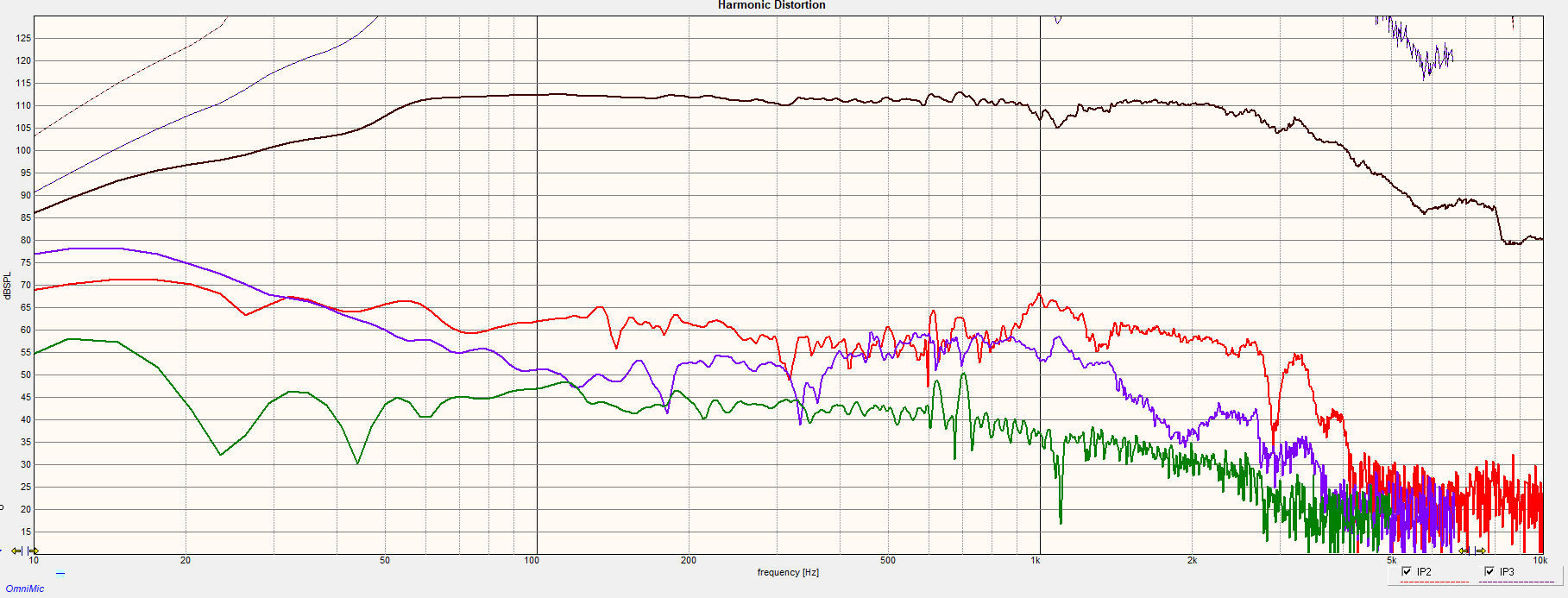

I sent the woofers off to get measured since I dont have the hardware, I attached the results. The FR graph ignore below 100hz. I was surprised how they were being used, not optimal for sure.
