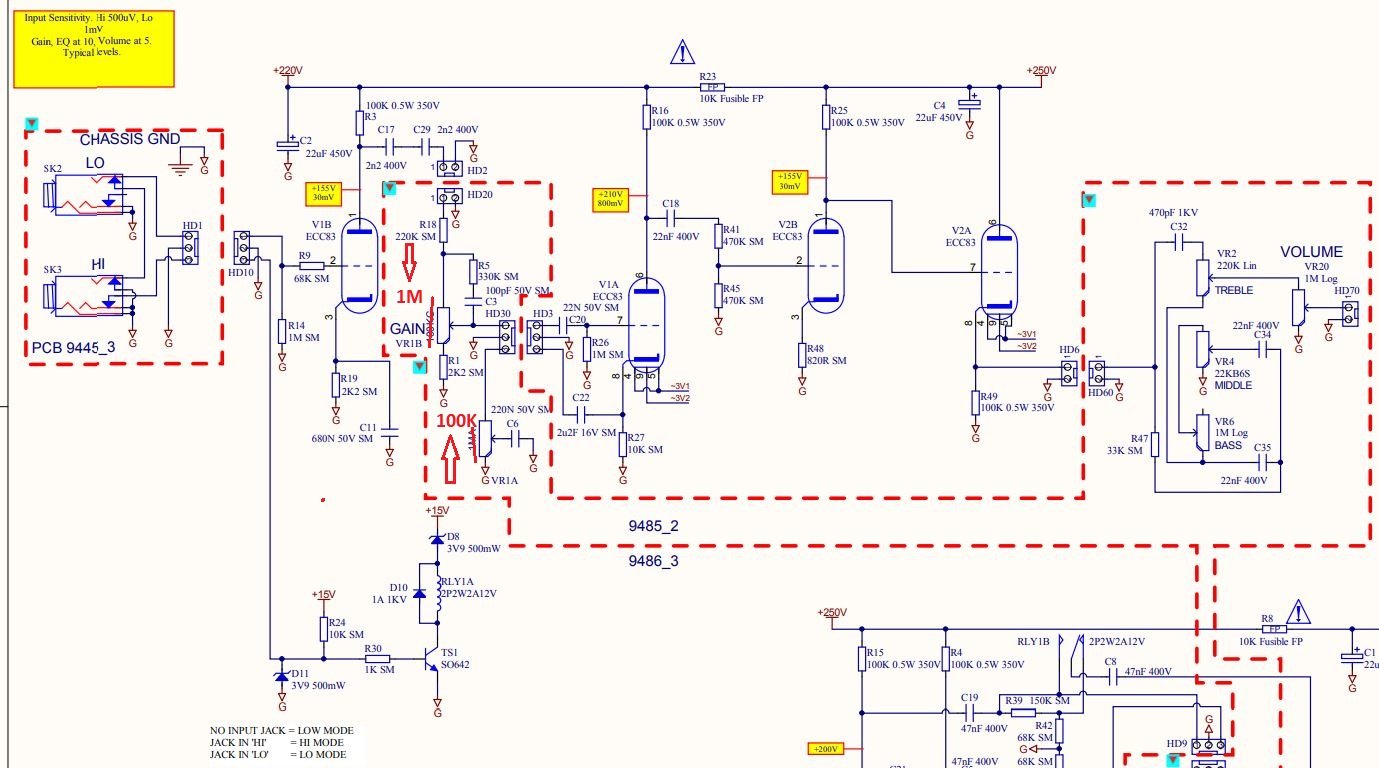

Found a schematic not sure if it is early or late, tempted to remove the mods.
Edit: I've decided that it will not be easy to work on so I'll leave the mod in place and let my son try it.

My son finally came to get this amp and tried it out. It works great as a clean amp, but as he turns the gain,
up past 5 and plays it hard it sounds great for about 10 seconds and then the volume drops to almost
nothing and it crackles when he plays loudly. The very weird thing is that it seems to latch into this mode
and cycling power for say 20 seconds doesn't clear it. I don't know if leaving it off for say 5 minutes would
clear it, that's an experiment that we have to do. He seemed to think that playing it softly for a minute or
two also clears it. But who knows perhaps silence for a few minutes would also clear it, another experiment to do.
He liked the clean sound so much that he decided to take it, he mainly plans to use it for clean.
Also, it did it with his very nice PRS guitar with hum buckers,
but it didn't seem to do it with my very cheap Peavy guitar with single coils.
I'll need to test it out on the bench and see if I can get it to latch up, then probe voltages etc.
I had a passing thought that it might be an oscillation but you'd think that turning it off would clear that.
Any tips and suggestions would be appreciated.

Sounds like bias shift on the output tubes, look up Marshall 18 Watt amp, they have some fixes.
